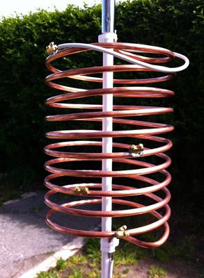

I can't promise you pretty, but I can promise you efficient:
This is made from car copper brake pipe tubing on a 5" former, I stripped the wire from a hamstick, soldered the brake pipe to the top fitting, added thick gauge wire from the base of the coil to the base of the antenna and soldered it, As can be seen I use a tapped fly lead for band changing, I can get away with using the same shunt coil at the base of the antenna for 20/17/15m and bypass the shunt coil for 12/10m.
Here's the mk1 version where I used a crock clip fly lead for band changing and relied on hose clamps to secure the coil to the fibreglass shaft:

Looks nice!  My nephew is an auto mechanic and maybe he has some surplus tubing.

« Reply #10 on: October 12, 2013, 04:38:29 PM »
I didn't know they used copper for brake lines---Every brake line I've seen was steel. Copper won't hold the pressure in a hydraulic system.

« Reply #11 on: October 18, 2013, 01:44:21 PM »
Without knowing the tube diameter or wall thickness how can you can be so sure? but brake pipe tubing it most definitely is Wink
Its not pure copper but copper molybdenum. We moved from steel brake pipes in the UK some time ago. Why would you continue to use something that goes rusty when there's alternatives?
