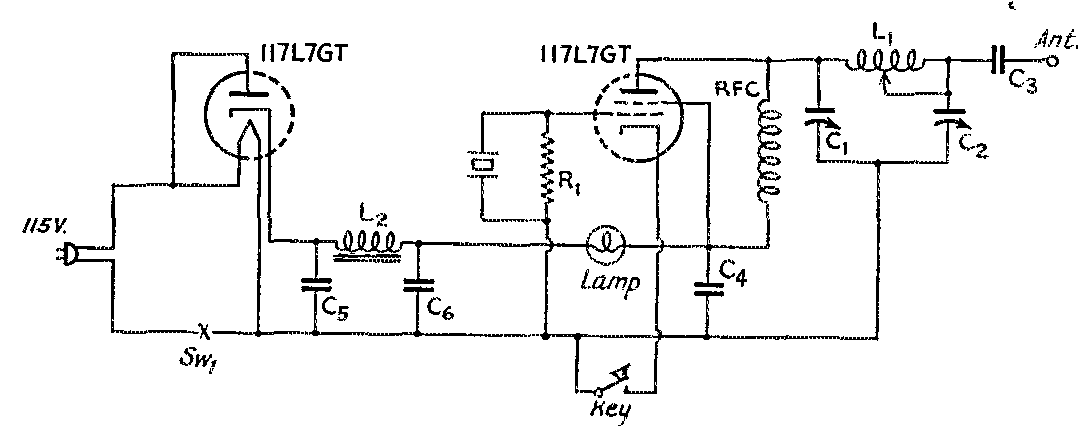

50  eHam Forums / Elmers / RE: Question about tube xmitter PI Filter please on: August 08, 2011, 06:31:42 AM
Thank you all for your replies!
Yes, to reiterate:
1.)  I am using a 3-prong AC line cord, the safety ground lead is connected to the chassis
2.)  I have added an AC line fuse
3.)  I have added a Triad N51-X isolation transformer
4.)  I have moved the DC blocking capacitor to a location prior to the output PI filter
The AC line still gets routed to the 117L7's filament, however, the chassis ground
connection and the plate of the rectifier are both sourced from the secondary of the
isolation transformer.
I made a successful QSO with this transmitter this past weekend on 7049 KHz.
It was during the afternoon and "only" 104 miles away.
But I'm completely blown away!  Only 2 watts (less than a nightlight) and 104 miles!
(I was using an end-fed wire antenna, home brew antenna tuner and home brew tube receiver.)
Thank again guys,
-- KC9KEP
51  eHam Forums / Elmers / Question about tube xmitter PI Filter please on: August 07, 2011, 04:33:56 PM
Hello all,
I'm building a simple one-tube (circa 1941) QRP rig.
(I've added an isolation xformer, fuse, & 3-wire AC line cord for safety.)
A link of the schematic is here:
http://www.bignick.net/temp/1941_QRP_rig.bmp
My question is about the PI filter in the output section.
For some reason, they have placed the DC blocking capacitor AFTER the PI filter.
This means that both tuning capacitors and the tapped inductor are all at the B+ voltage.
In most schematics that I've seen, the blocking capacitor is wired BEFORE the PI network,
(and an RF choke is usually wired from the output of the PI filter to ground.)
Can I move the DC blocking capacitor to a location BEFORE the PI filter without
affecting performance?
It would seem to me that the RF would pass thru the 0.001 uF DC blocking capacitor
an on to the filter, but I'm not sure.
For that matter, if I'd like to do some circuit analysis of the PI filter, what input
output impedances would I use for calculations?  I would assume that input impedance
would be the plate impedance of the tube, and the output impedance ideally 50 Ohms?
Thanks!
--KC9KEP
