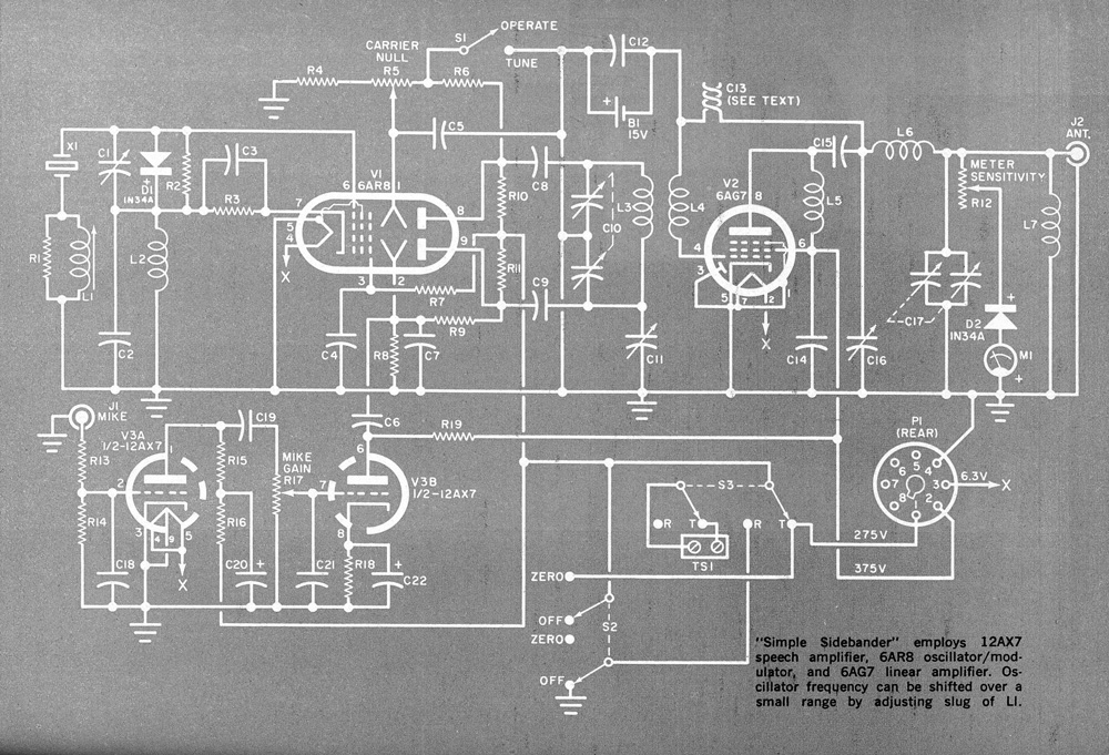

Hello all,
I’ve been considering building one of several SBB transmitter tube rigs for the sake of fun & learning.
One design that I’m considering, "The Simple Sidebander", was published in June 1962 of Popular Electronics magazine.
The author was Hartland B. Smith, W8VVD.
It transmits on 80 and 40 and uses three tubes; 12AX7, 6AR8 and 6AG7 and features a separate power supply using a 5U4.
Hartland was able to make minimize the complexity of the circuit by allowing both sidebands to be transmitted and suppressed only the carrier.
Can anyone tell me what the disadvantages to creating sideband transmission in this fashion are?
I would assume that this method occupies more bandwidth than is necessary and uses up transmitter power to create an un-needed sideband.
Will anyone complain that I’m sending both upper & lower sidebands if I use this design to transmit?
Thank you & 73’s!

« Reply #1 on: April 10, 2009, 07:14:44 AM »
Unless you're driving a KW amplifier in the DX window, most won't notice unless you tell them.  Yes, "someone" will complain.  Someone complains about everything, in case you didn't notice.  Complaining is one of the most popular aspects of amateur radio.  (And I'm not complaining about it, nope!) You might as well do what you want as long as it is legal.

« Reply #2 on: April 10, 2009, 07:15:09 AM »
It would occupy as much bandwidth as an AM signal (but for a narrow slot at the carrier -- maybe you could sneak a PSK31 signal in there <grin>), but would tune like an SSB signal.
Could you build it as an AM transmitter, leaving the carrier, and making it simpler still?

« Reply #3 on: April 10, 2009, 08:09:33 AM »
What you are talking about is "double sideband" modulation.  I don't know why you would want to build one, though.
The AM guys will complain, the SSB guys will complain, and you have don't minimize bandwidth much... plus they still have to re-insert the carrier.

« Reply #8 on: April 10, 2009, 02:51:00 PM »
It seems like an easy fix for the Simple Sidebander would be to add a Low Pass filter that strips the USB and passes the LSB.
A couple of components located immediately after the modulator would be the obvious locaction.  But I havent' seen the schematics.
Sounds like a great project.  I don't think it would meet the spirit of current engineering practice to transmit using DSB.

« Reply #9 on: April 10, 2009, 03:22:57 PM »
Bill,
From the June 1962 Popular Electronics page 54 is
the schematic of the Simple Sidebander:
http://www.bignick.net/temp/SimpleSidebander.jpg

Posts: 8972
View Profile WWW
« Reply #11 on: April 11, 2009, 03:38:35 AM »
Tom,
That is a fun project provided you use your head and don't get on crowded bands, especially near weak signals.
There are a few issues. One was already pointed out, it has both sidebands. A second issue is there is nothing that limits bandwidth of the transmitter except a frequency response and distortion characteristics of everything from the PA stage back to the microphone!!! This is actually a worse problem than the second sideband.
Normal filtered SSB transmitters use a good RF crystal or mechanical filter to limit bandwidth. It doesn't matter much how much distortion you have or what the mic response is, the filter cleans up the off frequency crap. As such, only the linearity of stages after the filter have a large effect on bandwidth.
Your system will pass everything including distortion in the RF stages right back to the audio input out o the antenna, so the bandwidth is almost certain to be very much worse than twice a filtered SSB rig.
It will be about like an old AM rig with low level junk extending out a considerable distance beyond what some might imagine.
This does not mean you can't have fun or learn something. It just means you have to be careful when and where you place the center of that signal. It probably is not a good idea to use something like that when activity is high or going to be high soon on a band, but it is loads of fun for everyone at other times. It is a lot like driving a 1966 Pontiac Gran Prix.
