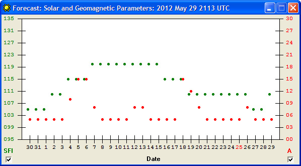

Howdy... Is there any good programs for propagation?
            Something that would give up to the minute greyscale, flux, band conditions, etc.
Like this?
It's all free, via www.dxlabsuite.com
         Dave, AA6YQ
