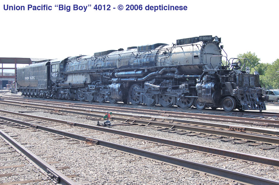

Years ago I did some reading about the legend and lore of the Baldwin Big Boy and the ongoing debate over whether it was the largest locomotive ever built in the US, the world, or the Milky Way.........
If you're ever in Scranton, PA, forget the visit to Dunder-Mifflin and reserve a day for a walk through Steamtown.
http://www.studiosclavi.com/graph/depticinese/steamtown/up_4012_2.jpg
Steamtown is the home of one very, very big boy formerly known to the Union Pacific as #4012. For those wondering why Scranton for a national park devoted to steam locomotion, the answer is about a thousand feet under the rails. One of the world's largest deposits of high quality hard rock anthracite is on the south side of Wilkes Barre near Ashley and Nanticoke. If there's one thing a big boy likes it's an abundant supply of anthracite and Scranton has some of the best ever mined.........
BTW: When UP started running the big boys on coal runs between Wyoming and SoCal the engineers discovered two issues with them: Previously it was SOP to accelerate when going into an uphill climb for added momentum. Do that too often or too enthusiastically with a big boy and the loco could literally hammer the track hard enough to bed the rails into the gravel or break ties & rail joints. The other had to do with snapping couplers. As a train starts from a full stop the slack in each coupler is progressively taken up from front to back... Click, Click, Click... If the loco accelerates too quickly each successive coupler sees a faster 'snap' until the couplers toward the back of the train start to fail. Loaded gondola cars were never meant to go from zero to five in 20 milliseconds but a big boy had the moxie to make them try...  Cool
