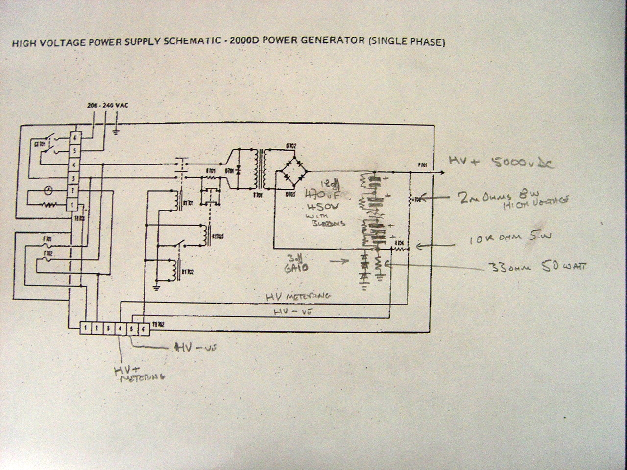

I have finished my HV supply for my conversion of a Henry RF generator to a linear amp. Please see attached schematic. I have proper HV connectors and cable to take the HV + from the PSU to the separate RF deck, but I am unsure if it's overkill also using HV connectors and HV wire to connect the -ve side, which, all being well. should only ever float just above ground. I added 3 safety diodes to conduct to ground in case of a flash over and a safety resistor to ground. In the original (single cabinet) Henry RF generator and PSU ordinary thin cable was used for the HV -ve line, and no safety diodes nor a grounding resistor.
http://www.gatesgarth.com/hv.jpg
My second question is should add any -ve line safety devices at the RF cabinet end of the line as well?

BASIL:  First of all, I'm far from an amplifier or HV expert.  However, with over 50 years in ham radio behind me, I can say with certainty that I have never seen these extensive safety steps you have taken.
On my homebrew amp I use HV wiring and HV connectors to connect the separate HV power supply to the RF deck as you are.  Nothing more.
I have a binder almost 3" thick full of amplifier plans and commercial amplifiers.  None have these elaborate safety measures.

Hi Al, thanks for the reassurance Smiley Being new to 5kV at nearly 2 amps I feel going a bit OTT with safety is not a bad idea Wink I got the grounding diodes and resistor idea from Ian White's site, from his Power Point presentation on HV power supplies and safety. I have put a copy at http://www.gatesgarth.com/hvpsu.pps

My usual practice is to use coax; the best connectors disconnect the centre pin before the cabl;e shield.

I use metal core "spark plug" wire rated at 50Kv.  My connectors are B&W as I recall.  Probably like what you're referring to Peter.  The connectors have a HV plastic shell with the center contact very well recessed.

I would get rid of the .5 second delay on relay and use a soft start circuit like the one used in the al-1500. Which only allows the hard start relay to energize if their is no fault on the b+ side. I would also add a glitch resistor
Check out how I built my supply in a henry 2000d on amprepairguy.com. Which was and still is setup to run between  100-150 mhz. It originally had a 3 phase plate transformer. Safety stud type diodes from the b- to ground not yet installed. Still waiting on them to get here.
Thanks, I will take a look at that with great interest. To be honest I plagiarised the circuit I showed the link to from the Henry manual. I already have a proper soft start and glitch resistors on the actual supply I have built. I just kept it simple to show the area where I was wondering about the negative line and whether to add diodes. Thanks everyone!
