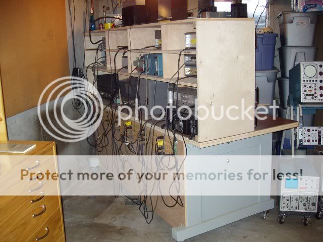

The team is upgrading the feed lines and patch bay at the N2MO station.  First off, I admit we stole the idea from K7ZSD.  Link: http://www.k7zsd.com/patch_panel_assy.htm
This is the cable from the operating positions to the patch bay:
Cable is 1/2 heliax, with N and 7/16 DIN connectors.   Lightning protection is Alpha-Delta with 7/16 DIN connectors, located in the attic at the entry panel.
The cable from the patch bay to the lightning protectors will be routed on top of the gray brackets using Andrew L4Click hangers on the studs sticking up from the wall brackets.
73 Martin

Martin, that is some BEAUTIFUL work there.  Neat, organized, well executed.  Makes me feel a little guilty about the rats' nest of wire and cable behind my rig.  Smiley

Photo of Jeff,  N2LXM assembling the protector frame.   It is attached (via insulators) to a pair of 2x6 that span the rafters and joists:  http://www.sarex.us/temp_pix/Ground_strap 001.jpg
Protector frame partially installed:  http://www.sarex.us/temp_pix/Ground_strap 005.jpg  The bottom bracket and insulators were installed afterward

Adding a couple more pictures of the install for those interested:
Patch Bay showing rack-mounted triplexer and 5KW dummy load: http://www.sarex.us/temp_pix/thumb_9116_18_012.jpg
Trapeze for mounting protectors: http://www.sarex.us/temp_pix/thumb_9116_18_011.jpg
Unistrut hangers for the heliax in the attic.   The heliax is held in by Andrew hangers: http://www.sarex.us/temp_pix/thumb_9116_18_014.jpg
Side project:    Clock display in Radio Room One.  There are duplicates in Radio Room Two and the classroom.  All are tied to the building master clock via an IP connection: http://www.sarex.us/temp_pix/thumb_9116_18_013.jpg

Progress:  Link to panoramic Image of Radio Room One at N2MO.  http://www.n2mo.org/images/radio_one.jpg The new patch bay is to the right.   Large Image Warning!
The heliax between the patch bay and the protector frame in the attic has not been installed.

More Progress:  Installing the FSJ2-50A  feedlines from the patch bay to the lighting protectors in the attic.   There are seven more of the FSJ2-50A heliax, and multiple rotator cables going in next weekend.
Shows the 14 cables to the operating positions, triplexer,  and 5KW dummy load.
