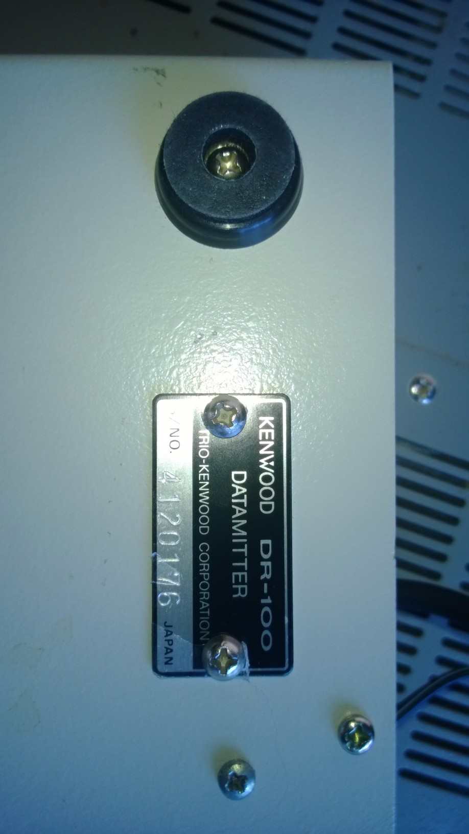

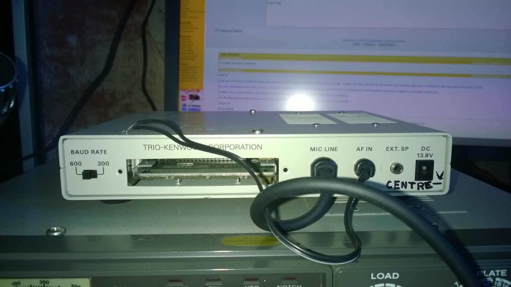

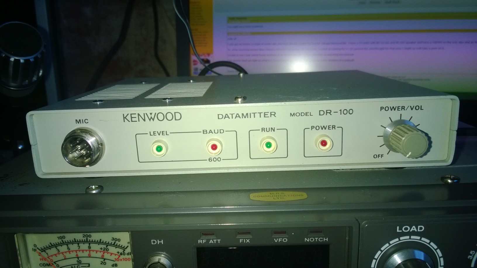

I have it in my hands and it is definitely a piece of Kenwood hardware.  I have seen a photo of one onaJapanese website also on a Kenwood Trio box.
Pics below are mine - some scam if they have gone to these lengths for a couple of dollars!!

Yes, agree (as does Ken K4EAA) that it appears to a very early PC to Radio interface in the days before PC's were powerful enough to do the full modulation for the various data modes.
I think it is almost definitely radio related as the mic lead nicely fits my TS-430S and the mic input acts as a pass through so I can use voice modes without unplugging it.
My next challenge is to see what happens when I hook in a patch lead to the AF In on the DR 100 and see if it sends the signal to my TS-430S.
I am still researching it though as I would like to know what went in the slot on the back of it and I am also keen to find out what the the device is that DR 100 is sitting on on that Kenwood box as it looks like some form of transmitter / transceiver but the box picture (and I appreciate it may just be artistic license) suggests it is the same size width at least as the DR 100 and that would make it pretty small.
