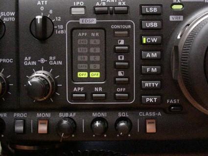

How about new features? Look closely at the right photo and you'll see "VRF" and "IDBT" on each side of the tuning knob, underneath the TX and RX LEDs. The VRF "Variable RF" button activates a manually-tuned front-end preselector, which one tweaks for maximum signal, just like us old-timers used to do on radios from previous eras. I guess the more things change, the more they stay the same.
Mark V Display
IDBT stands for "interlocked digital bandwidth tracking system," which sets the radio's DSP bandwidth to that used by the cascaded crystal and mechanical filters. What's neat about this feature is that it automatically corrects for adjustments in the IF shift and IF width controls. The feature can be toggled on or off by a button to the right of the tuning knob.

The Mark V has built-in DSP noise filters. The NR circuit is quite flexible, with different "contours" for different kinds of noise. The Mark V's NR filter is at least as effective, and maybe more so, than the NIR-12 outboard DSP filter I used on my FT-1000D.
The Mark V also lets you use the DSP to configure the TX audio to enhance your voice characteristics. This is a plus for me, since my voice is very soft.
