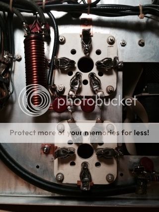

These are the sockets after some gentle cleaning.
The socket can also overheat and look like this:
(click for larger image)
Note the good grid contact on the left. The ends of the contacts are fully closed. Note the overheated filament contact on the right. The plating has blackened and the contact ends are not closed. The spring has relaxed from being overheated. It will not support 14.5A of filament current (there will be significant voltage drop).
I'm not seeing any blackening. I don' think this amp ever saw any hard use.

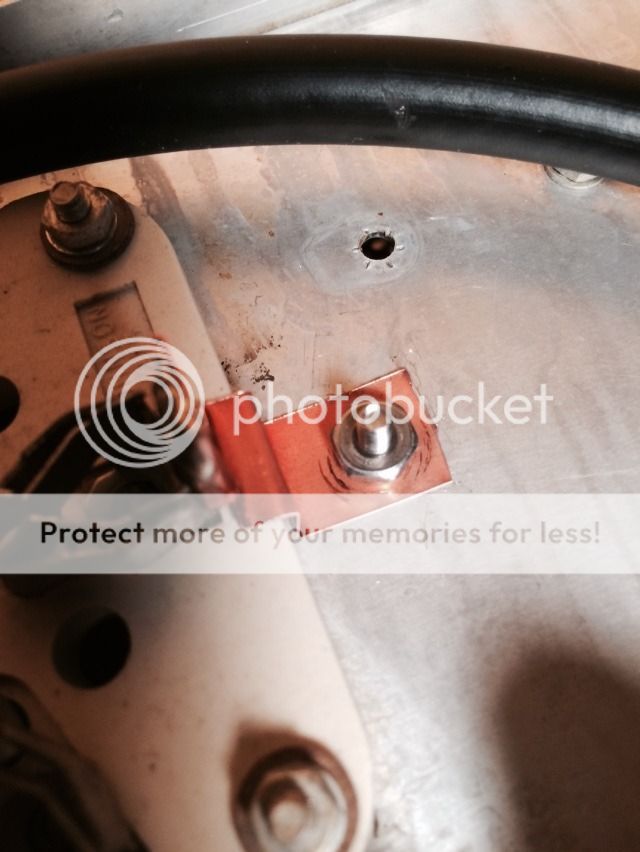

Hard-grounding the grid pins is best done with short and wide connections. The BEST way to do that on the SB-220 is with copper strips like this:
The end of the socket terminal is bent up at the point where it meets the edge of the ceramic. A soft copper strip is formed to make a short connection between the chassis and socket terminal, bent over the end of the terminal, and soldered. I used #4-40 hardware to make the connection to chassis. Yes, holes are drilled. Big deal.
This is clearly the neatest and most elegant solution I have seen. But of course it means drilling six new holes, moving two lengths of coax and the bifilar winding out of the way.

Look again. A good grid contact is on the left. The fried filament contact is on the right.
It's no big deal to drill six holes. The filament choke wasn't touched.
I was referring to my SB-220, not WA7PRC's contacts in the picture.

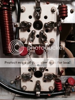

So anyway, drilling the holes and the obstructions weren't such a big deal after all, so I grounded the grids with copper strips, so here is the before and after
I decided to bend the copper instead of the terminals on the tube sockets, mainly because of an irrational fear of breaking one of the terminals. I think it is satisfactory.
Now I am going to order Ohmite resistors to remake the stock parasitics.
