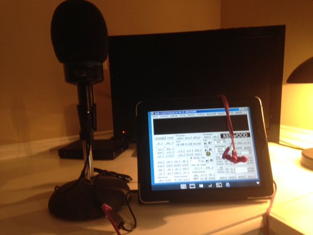

Skype provides the audio link to your rig.  Your PC rig control software runs on the desktop to control the rig.  A VNC connection allows a cellphone or tablet to control the desktop remotely and therefore control the rig control software running on it.  Below is my iPad with a mike and earphones with the Kenwood 2000 control program running on the screen.  It is hooked up VIA the network to my PC at home which is running Skype and TightVNC.   I am using Skype in the background on the iPad and MochaVNC Lite to see my PC desktop at home.
