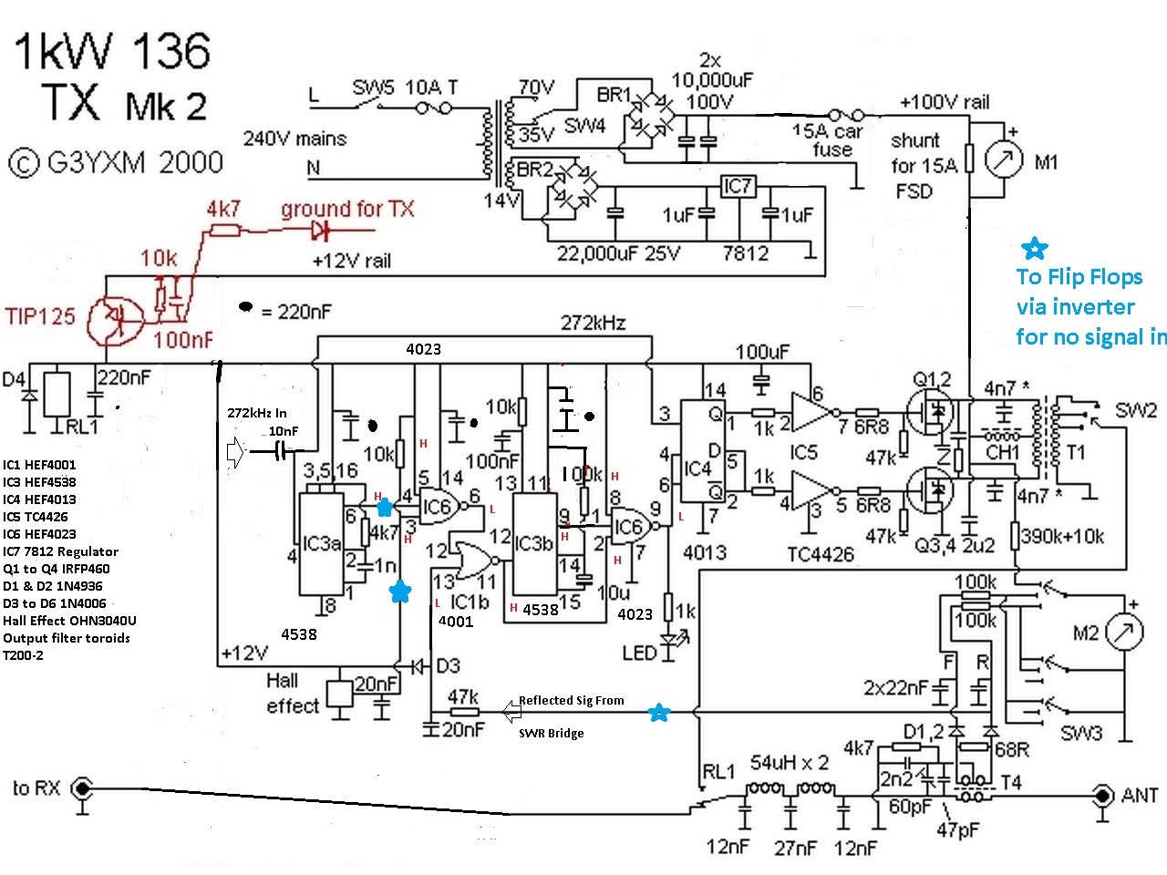

I have two separate variable voltage signals, 0 to 12V DC. Signal A and signal B. I want to read  both signals and if A ever rises more than say 10% higher than B an output goes high (or low, it doesn't really matter). I would much prefer this to be all analogue CMOS the stuff running a single 12 v supply. The circuit creating the voltages must not be unduly loaded. What are my options and please consider I am a real novice. It's to measure the outputs of an SWR bridge and at different operating power levels, and hence different voltages from the bridge, still be able to trip a no TX circuit if reflected power gets too high. Thanks. I can post a schematic of the circuit including the bridge if required.

Reading your description more closely I see that all that is needed (as WB6BYU says) is a comparator. As you want to sense down to zero volts, and use a single power supply, a comparator with common-mode range to zero volts is needed. The LM311 has a common-mode range down to 2 volts, has relatively high input bias current, and is much faster than is needed for this application. Its high speed invites oscillation. There are many suitable comparators and for this I'll recommend an old standby, the LM339.
From signal A to GND place a voltage divider having a ratio of 2.2:1. For example, a 100k resistor on top and an 82k on the bottom.
Connect the junction of the two resistors to the comparator non-inverting input.
From signal B to GND place a voltage divider having a ratio of 2.0:1. For example, a 100k resistor on top and a 100k on the bottom.
Connect the junction of the two resistors to the comparator inverting input.
From the comparator output connect a resistor to the logic power supply. For CMOS 10k will do. For old TTL 1k will do.
LOGIC: If A > 1.1B comparator output goes HIGH.
Note that there is no hysteresis feedback resistor (from output to the non-inverting input) but I don't see that it is needed. The output will stay HIGH long enough to toggle a logic gate. If you want to avoid possible oscillation as the output is transitioning high some hysteresis can be added. Let's say we want 50 mV of hysteresis at the inputs. 50mV/50k = 1uA. To get 1uA of hysteresis when the output transitions from 0 to 5V a 5M ohm resistor can be added from output to the non-inverting input. Or, the output can be divided 5:1 and a 1M ohm resistor is used.

Two things need correcting. The first is that for an excessive signal on B (reflected power) to cause the comparator output to go positive, it should be connected to the non-inverting input.
The second thing is what happens when there is no RF and A and B are zero volts. The comparator input offset voltages will cause the output to go LOW or HIGH, depending on which input has more voltage offset. We need a way to make the output go LOW in the absence of signals. To do this we can introduce some positive offset voltage at the inverting input.
The link below shows the schematic. It is set up to trip if the VSWR exceeds 2:1. The reflection coefficient is 0.33 and the B signal will be 1/3 of the A signal.
The B signal is divided by 2 while the A signal is divided by 6. R5 and R4 introduce 18mV of offset to the inverting input to ensure that with no signals the comparator output goes LOW.

I am indebted to you for taking such time and trouble, not only to explain how to create this circuit, but to also to explain how it works and foresee issues I hadn't even considered, and even create a schematic! My thanks too go to WB6BYU. I don't have that particular comparator, but have ordered 4 and hopefully they will arrive tomorrow. I only have LM339's here. I am not savvy enough to know if they are suitable.
I took the liberty to Google your call sign and I am flattered and honored that a gentleman with such a CV is willing to share freely such hard won and valuable knowledge with the ham community, it's much appreciated. I attach a link to the schematic for this LF amp, in case it's of interest to people as to what I am up to and why. Whilst 90% reliable, when it has "done something funny" the single trip LED left me guessing as to which of the 3 protection circuits had caused the trip. No drive signal, over current to the PA FET's, or high SWR, so I am rebuilding it with a separate LED fed via a set / reset flip flop, and where needed, an inverter, for each fail scenario. Then I will hopefully have an LED stay on showing WHAT tripped. I changed from a Hall effect device looking at the end of the choke ferrite to one of the current sensing modules now commonplace, and a comparator to allow accurate setting of the trip voltage from the sensing module, and I have the no signal scenario linked to a flip flop and separate LED. In fact from the original circuit I have fiddled about and deleted unneeded stuff like the keyer circuitry.
Before embarking on improving the high reflected power trip I had to feed the flip flop from the bridge side of the 47k resistor, just before the voltage limiting diode D3. I am unsure just what the 47k resistor does, is it current limiting?
Again, thank you most sincerely for all your help!
Original build document and schematic here: http://www.chriswilson.tv/bigtxv2.doc
http://www.chriswilson.tv/136bigv2mods-6.jpg shows a few deletions and where I have tapped for individual fault cause LED's
