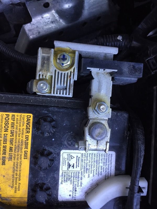

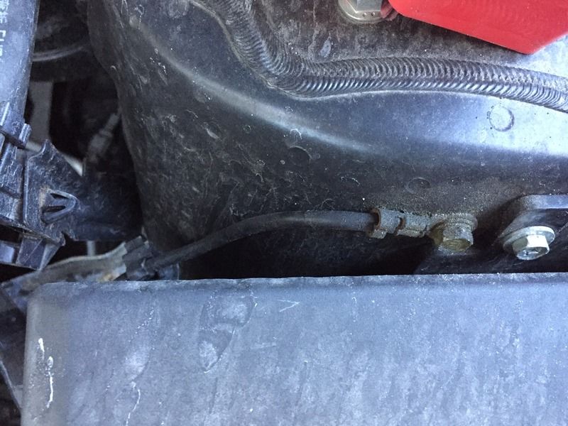

I read the fine articles by K0BG in May2015 QST, but find my 2015 Subaru Forester battery a bit more puzzling than expected.
The negative chassis ground site seems clear, but there's a lot going on at the positive battery terminal. What might be the correct Positive power cable attachment site?

Might look in a service manual or ask your mechanic where accessories would attach. Stereo guys would also know. Hard to see what's going on with the doohicky to the top of the picture from this angle.

I did find http://forums.qrz.com/index.php?attachments/img_0948-jpg.280526/ with a similar Positive battery terminal connection.
Yes, looks like that should work.  Props to you for wanting to wire direct - it will eliminate the chance for problems down the road.  Other "easy way" methods may work (and some try to suggest them as the same or better for some reason), but wiring direct is the best choice if you can do it to basically eliminate the chances of issues later on.  Why not just do it right the first time and be done with it is what I always ask.

Even in the olden days when I worked in the 2 way business, we never connected directly to the battery.  It was just an invitation to connection problems not the least of which was a ground fault, caused by acid wicking up the strands of wire and corroding the connection.
The direct to the battery practice is propagated primarily by the auto manufacturers.  For the few mobile installation guidelines that exist, they often specify a direct connection to the battery.
From the Ford manual:
"Power connections should be made directly to the battery and fused as close to the battery as possible. "
Chrysler leaves it up to the discretion of the installer:
"For higher power transmitters, including amplifiers, connect the power (battery +) lead at the battery or at the power distribution center or at the positive jump-start post, if the vehicle  has  one.  "
Looks like GM got it right:
"Connect the positive lead to the auxiliary power terminal and connect the negative lead to the battery-body connection point "
Anymore, with computers monitoring every parameter of every system in the vehicle, a direct connection to the battery can result in a check engine light coming on because it senses current going somewhere it can't account for.  Compared to messing around with clamps or side post adapters, and the latent corrosion problems, connecting to the positive distribution point and a chassis ground point is way easier and more reliable anyway.   No reason not to do it.

I am connected direct as shown in the QRZ images posted above, up and running, and will report back any issues. My prior 2009 Subaru Forester install was more straightforward as the electronics were simpler on the positive battery post, so we shall see. I do place multiple Mix31 ferrite beads on all wires/cables with 2+ winds through each core, depending on diameters, to help reduce common mode currents.
