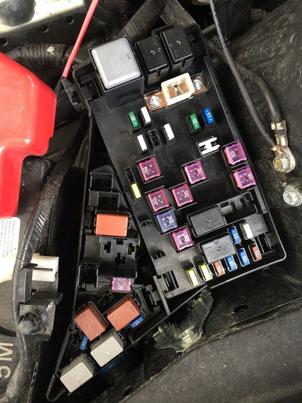

Here's my main fuse box under the hood. No stud bolt I can find, unfortunately.
How does this fuse tap look? Is 10Amp enough?  https://www.amazon.com/gp/aw/d/B001QRSBW0/ref=mp_s_a_1_8?ie=UTF8&qid=1488117531&sr=8-8&pi=AC_SX236_SY340_QL65&keywords=auto+fuse+tap

The minimum buss feed for those fuses is 30 amp after looking at picture. The fuse feed in question will have no trouble powering rig. Also remember a 30 amp fuse does not blow at 30 amps. That is is designed load. It will blow 15 to 25% above that and are slow blow in nature.
