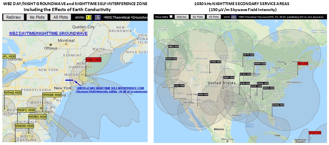

Re: RE: MW/160m propagation at night...?
« Reply #8 on: November 19, 2019, 06:26:28 AM »
...  This short skip can interfere with ground wave signals, resulting in a zone where reception is poor.  This short skip would only be noticeable at night, when the D layer absorption is minimal.
Sorry for the late post, but below is a study of the day/night fields of WBZ and some others on 1030 kHz.
As noted by W1VT, there is a zone of nighttime self-interference common with "Class A" 50 kW 24/7 AM broadcast stations where their groundwave and nighttime skywave have roughly the same field intensities.
For receive locations further away, the groundwave gets weaker while the skywave gets stronger, and the effect is reduced to unnoticeable levels (mostly).
