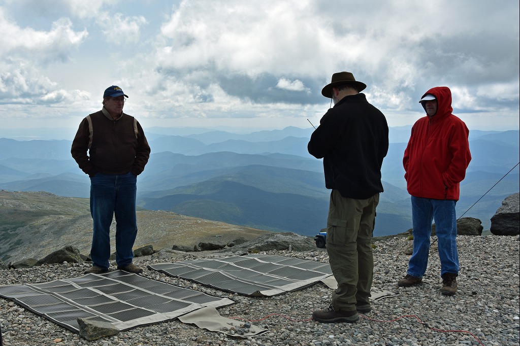

The Nashua Area Radio Club has continued to have fun doing SOTA activations with our portable 6m Station. We recently activated Mt. Washington in New Hampshire. Mt. Washington is the highest peak in the northeast with an elevation of 6,288 ft.
Our station was solar-powered and used a pair of LiPo packs on an MPPT charger as a backup when the sun was obscured by clouds.
Our portable 6m station used an IC-7300 operating at 100W into a 3 element yagi on a 22' push-up mast. The setup allowed us to make over 50 SSB QSOs on 6m during our time on the mountain.
