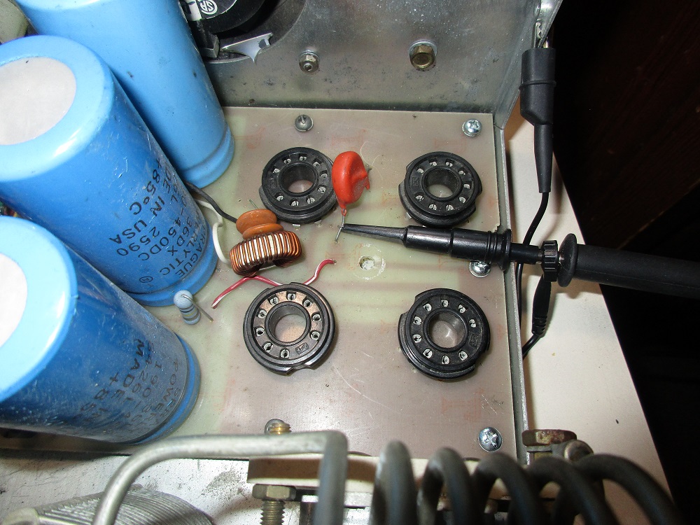

I just began a restoration of an old AL84. The RF choke to the plate caps was found lying loose as shown inside the box. The wire at the bottom is broken.
My first question is did the RF choke have any kind of metal ring around the base of the choke like in other designs to which the wire was attached? There was a piece of cellophane tape around the bottom as you can see from the discoloration at the base. I removed the tape but wondered if the tape was put there at the factory or if someone used tape because a part is missing.
Also, I found 1.04 KV with a scope at the nearest point to which the RF choke screws into the pcb but see no hole for any wire from the choke to the HV in the pcb. How did the factory connect the choke to the HV?

Often times there might be a short insulator and that would be a tie point between that wire on the choke and the B+ from the supply and a bypass cap to ground.  You can see that the ceramic is busted on the bottom so it could be it had a metal ring where the B+ came in and the cap to ground.  You will have to improvise now.  That is not a good choice of amp to restore.

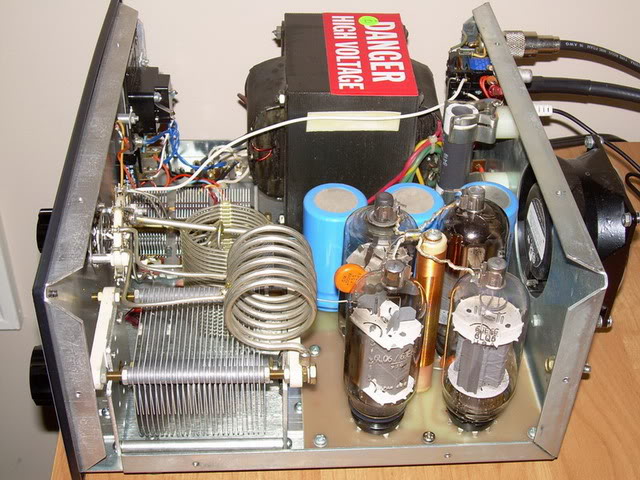

If you search on eBay under completed listings,
"Ameritron AL84 160-15 meter RF Amplifier"
There is a side view picture.  It looks like the choke is mounted directly into the PCB.

« Reply #8 on: November 22, 2017, 07:05:17 AM »
It does mount directly center between the four tubes.

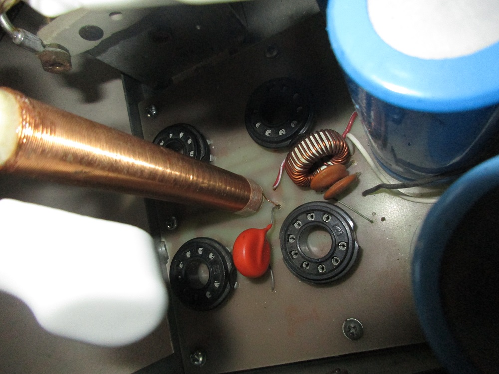

I always wondered if it was possible to see closed auctions or sales on eBay. I did find that eBay photo and another one in a PhotoBucket series of photos at this link.
http://s74.photobucket.com/user/arlags/library/Ameritron%20AL-84?sort=3&page=1
Both photos show the fiber reinforced tape at the base of the RF coil. I have some similar tape. The base of the choke is being rebuilt with structural epoxy.

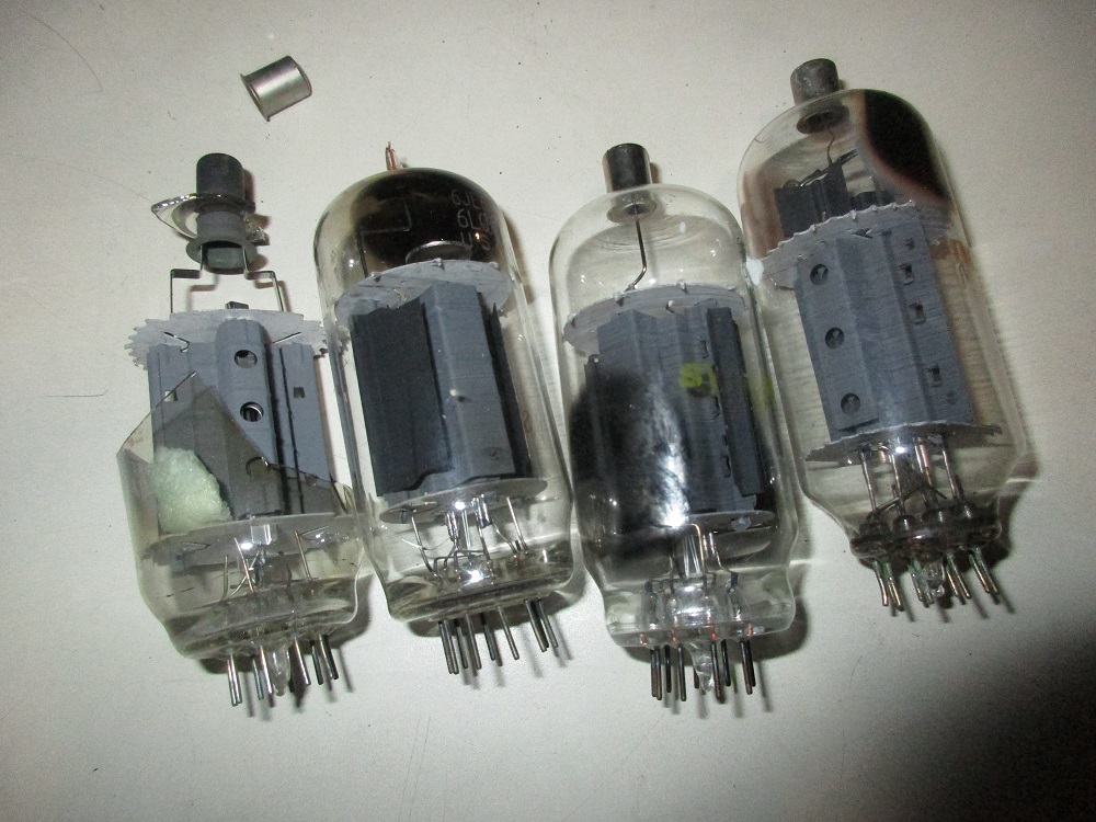

Meanwhile, a plate cap that was torn off one of the four tubes was reattached with JB Weld epoxy and soldered back in place. The tubes had shipped inside the AL84 with two sustaining damage as shown below.

The choke was successfully restored with epoxy. The base of the choke was rewrapped with fiber reinforced tape as was found there but removed earlier. The lead from the RF choke fits in the same hole as the orange ceramic bypass capacitor. When one lead of the capacitor was lifted, a small remnant of coil wire was found.

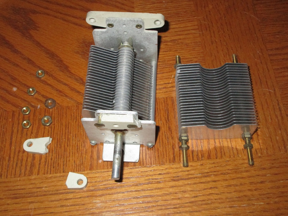

Next up but more challenging is the broken plate tuning capacitor. The ceramic in the front is broken in two places and there are some slightly bent plates. Alignment of the three ceramic pieces is actually not that difficult due to the hardness of the material and sharp breaks. If you have ever glued a ceramic dish you know what I mean. Probably epoxy again for repair. The front and rear mounting plates may not longer be parallel. I noticed that of the two mounting tabs at the bottom, the rear one does not lie perfectly flat on the table.
Re-alignment of the plates seems to be the real challenge. Thinking of cutting pieces of cardboard and placing them between the plates during reassembly so rotor and stator plates stay in position during re-assembly.
Any ideas would be appreciated. The capacitor is still available from Ameritron is all else fails.
