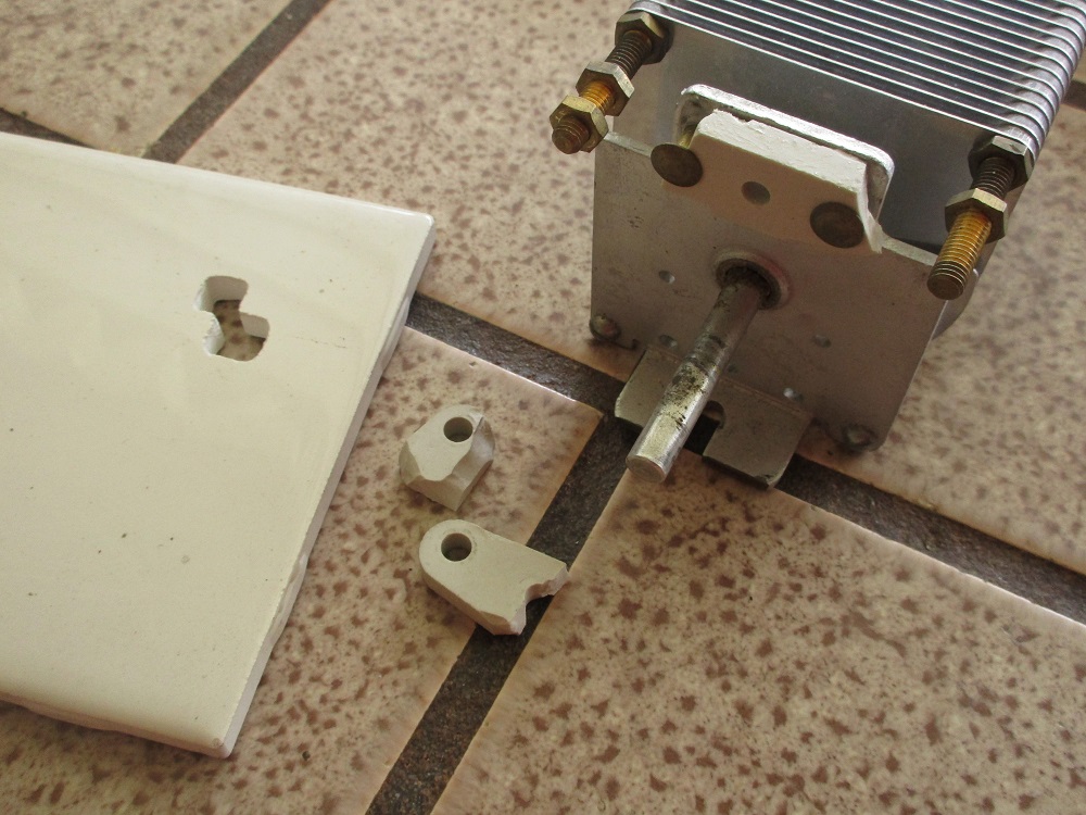

These comments have been interesting. I hadn't really given much thought to creating a replacement part for the damaged ceramic piece.
It wouldn't be that hard since I have all the tools from laying ceramic tile in some remodeling work done awhile ago including a diamond bladed ceramic tile saw and a Dremel with a carbide cutting tip which can form almost any shape. Below is a photo of a white ceramic tile about 1/4" thick with shapes cut with the carbide cutter.
I think I will remove the two brass rivets holding the remaining piece of ceramic to the frame so all three pieces can be bonded with structural epoxy on a flat plate. Not sure why that would not be strong enough since there are really few forces on the ceramic piece but if it is not strong enough, then I can use it as a template to cut a new ceramic support from a tile.

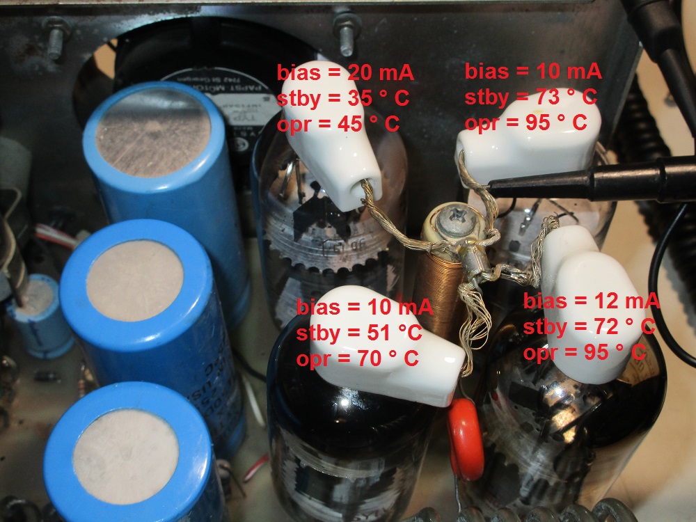

Meanwhile a used 6LQ6 was ordered from eBay to replace the damaged one. It arrived today. The plate current was measured for the replacement tube. It was 12 mA. The four tubes then have bias currents of 10 mA, 10 mA, 12 mA, and 20 mA. The plate current was measured with a Fluke 87 digital multi-meter inserted between the ceramic plate cap and and the tube anode connection. All four tubes were inserted in the AL84. The temperatures of each tube was measured with an infrared thermometer in standby and operate modes. The results are shown in the image below.
The probe in the photo is a high voltage scope probe used to monitor the plate voltage just in case anything strange happened with the long leads from the Fluke 87. Fortunately all was stable.
Notice the fan is to the left of the tubes although there is nothing on the rear panel to prevent the fan from being directly behind all the tubes. It does has a pretty strong effect on the glass temperature of the tubes. The laser on the thermometer was aimed right at the center of the plate of the tubes. I understand the infrared thermometer cannot read past glass so it is measuring the glass temperature not that of the plates.

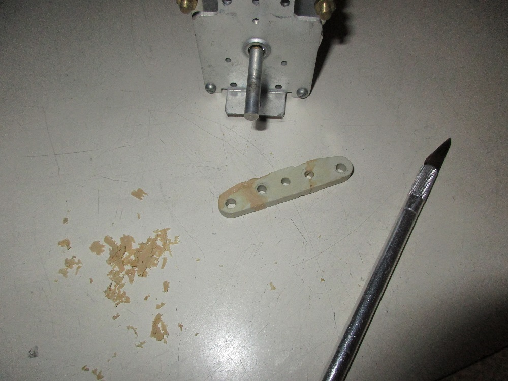

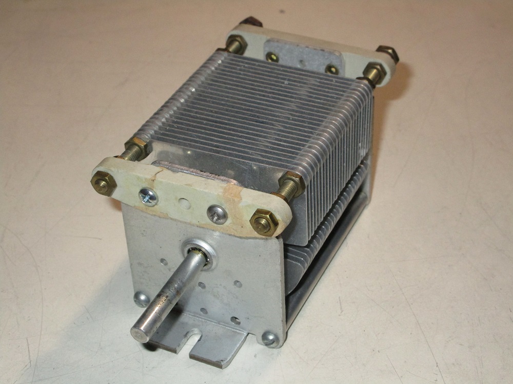

Here is what the ceramic capacitor part looks like after one coat each of two different epoxies meant to work together. The first coat is a very low viscosity epoxy that flows almost like water and is able to penetrate well. The second epoxy is structural and designed to bond to the first high penetration epoxy and give structural strength. One more coat of the structural epoxy will be applied mostly to improve the cosmetics. After 24 hours the structural epoxy can still be easily carved with an X-Acto knife to the proper shape as shown in the photo below.

« Reply #29 on: December 07, 2017, 11:34:45 AM »
All the missing chunks of ceramic have now been filled in with the structural epoxy which will take 3-7 days to fully cure. There are no stresses on the ceramic since the part slipped right on with no forcing necessary. After the cure is complete, the final adjustment of the plates will be done but it does not appear many plates need adjusting.
