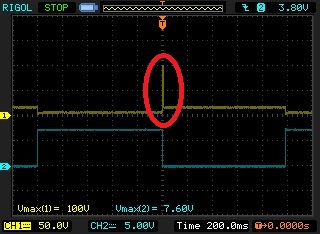

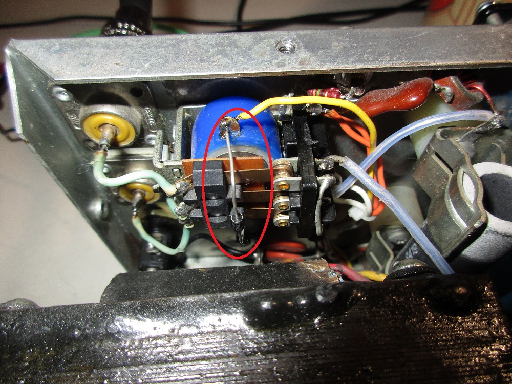

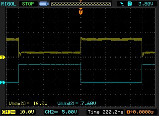

Setting aside input tests for a moment a test was done to see if it is safe to drive the relay input of the AL84 from a solid state rig. A solid state driver consisting of a 2N3904 NPN transistor was connected to the relay input RCA connector of the AL84 and driven by a Wavetek function generator. The measured relay current for the AL84 was about 94 mA. The relay is a 12VDC unit with one side of the coil connected to an internal +12VDC supply. The transistor driver grounds the other relay terminal to turn on the relay. The image below is the result. The yellow trace is the voltage at the RCA connector ( collector of the 2N3904 ). The blue trace is the Wavetek drive signal to the 2N3904. There are very large voltage spikes of +100 volts at the collector due to the relay turning off. The driver of the FT100D transceiver says it can handle +50VDC with up to 400 mA. so it would not be safe to drive the AL84 without modification.
To see if this problem could be solved by putting a diode across the relay coil to snub the glitch a 1N4002 diode was soldered across the coil as shown below.
The diode was able to adequately suppress the spike as shown below. This image has the collector voltage at the RCA connector measured at an increased sensitivity of 10 volts/div to see if any glitch remains. The fuzziness in the collector voltage is due to 60 Hz from the half wave rectifier of the +12VDC supply.

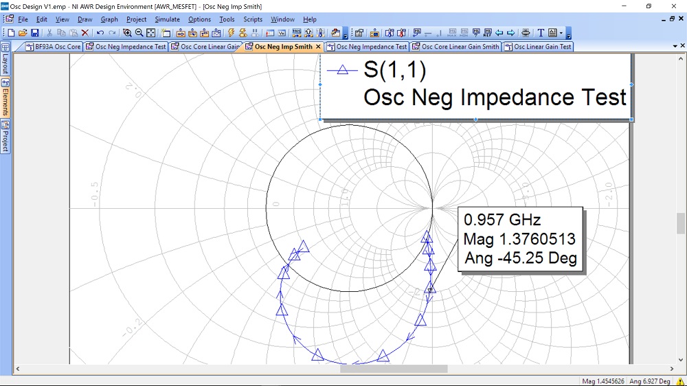

I will not digress from the AL84 for long but this 30L-1 stuff is sort of intriguing. I have helped with a repair of the 30L-1 but never used or owned one.
I used to design solid state amplifiers and oscillators for commercial applications. What I recall is that I used a vector network analyzer to measure the S11 of amplifiers to see if they showed negative resistance at any frequency. If they did, that amplifier was conditionally stable. I never allowed such an amplifier in production though.
For oscillation to occur, S11 had to be at a phase angle of either 0 or 180 degrees.
As explained in Oscillator Design , oscillation occurs at the frequency where the phase of S11 is either zero or 180° (S11 is non-reactive).
Oscillator Design is actually the title of a book "Oscillator Design and Computer Simulation".
So if the 30L-1 does show negative resistance at its input, then using a coax to rotate that negative resistance as far away from 0 and 180 degrees ( ie  to 90 or 270 degrees ) does make some sense. It also means the exciter will influence the length if it introduces phase shift.
I think the first HP swept vector analyzer ( 8407 ) appeared sometime in the 1960's which might have been about the same time the 30L-1 appeared. If I ever restore a 30L-1 I would check S11 on a vector analyzer.

S-parameters ( short for Scattering parameters ) were originally used at higher frequencies. They consist of S11, S21, S12, and S22. HP, Agilent, now Keysight has many application notes about both S-parameters and network analyzers.
Here is an example of S11 showing negative impedance. In this case, the person is actually trying to build an oscillator so they want to see negative impedance.
