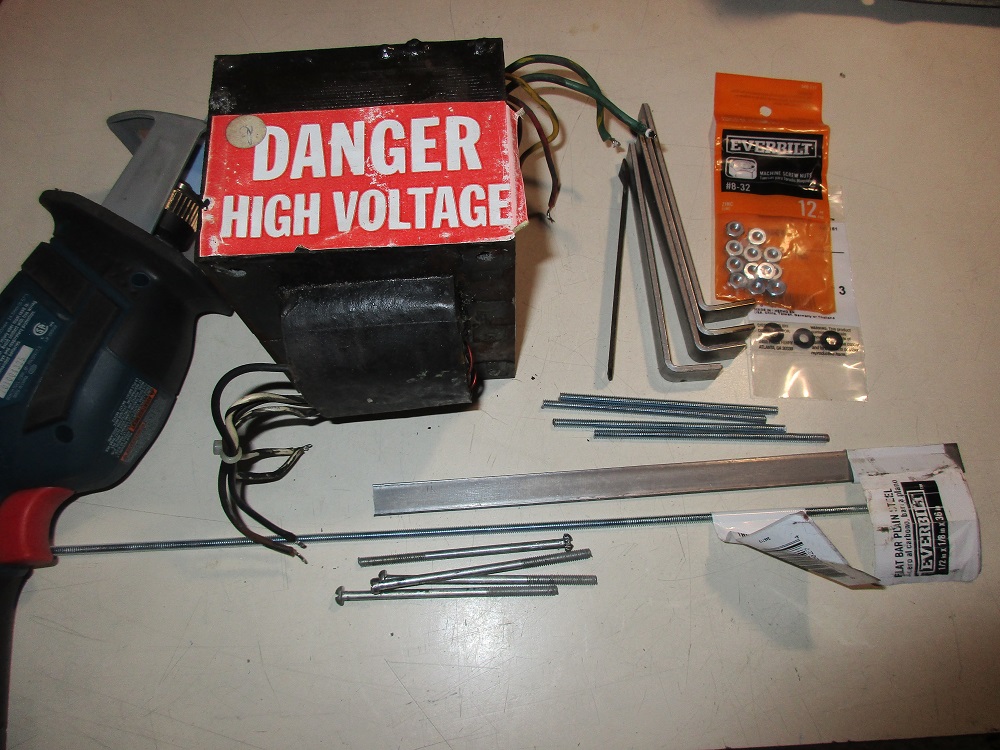

Looks like the transformer was not just loose. Some of the mounting ears had cracked and broken off. The screws are not easy to get out. The holes are filled with what appears to be some black dip material. Interesting that the washers under the heads of the screws are fiber washers not metal maybe to allow for some expansion.

A trip to Home Depot yielded 1/2″ bar stock, threaded 8-32 rod, 8-32 nuts and fiber washers. They didn’t have 8-32 screws over 3″ long but they did have 8-32, 3 feet long threaded rod. They also did not have 1/2″ x 1/16″ steel bar stock but did have 1/2″ x 1/8″ steel bar stock. The rod and steel stock were easily cut with a reciprocating saw. A propane torch was used to heat the steel bar stock before bending in a vise. The holes in the transformer were cleared with a 11/64″ drill bit. Left to do are to drill holes in the mounting brackets, polish with a grinder and paint black.
