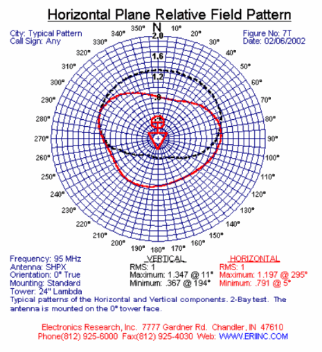

For a general idea, below is a clip showing the measured h-pol and v-pol radiation patterns of a 2-bay, c-pol antenna used for FM broadcast applications, when side mounted on a triangular, 24" face tower section.
Vertical polarization is more affected than horizontal polarization regardless of the distance of the antenna from the tower structure, and its location along the faces/legs of the tower.
« Last Edit: May 07, 2018, 03:24:21 AM by RFRY »
