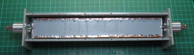

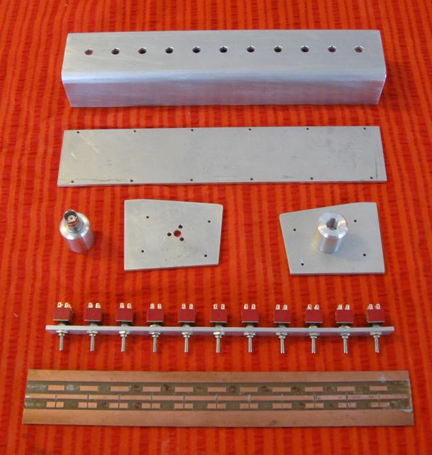

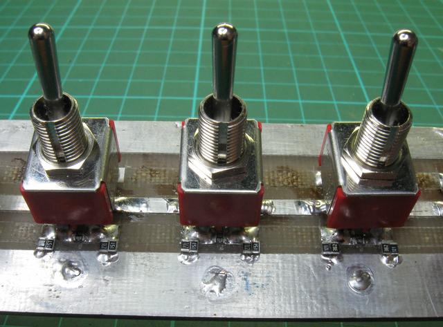

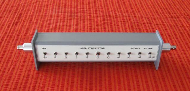

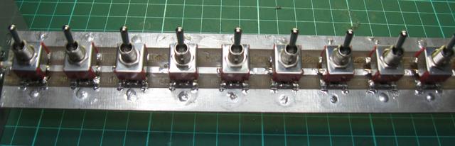

I built one;
There was a good deal of mechanical work;
The layout used SMD resistors and the switches were soldered "SM fashion";
I don't have a photo of the shields between and around each section but here is the final shielding made from copper foil;
The final version works well to over 500 MHz.
I enjoy mechanical work but I don't think I'd make another one; if I did, I would put about 3 or 4 sections in diecast boxes and interconnect them as required in use.

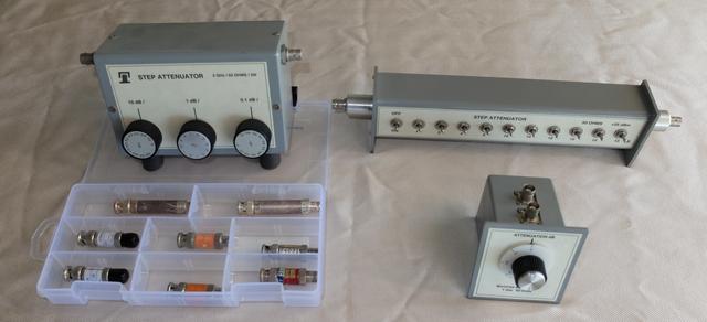

A collection of attenuators is very useful;
The rotary units were, as G3RZP described, bought separately and housed in aluminium cases.
Fixed units are also useful; the cheaper ones from ebay and elsewhere work fine for HF and VHF.
