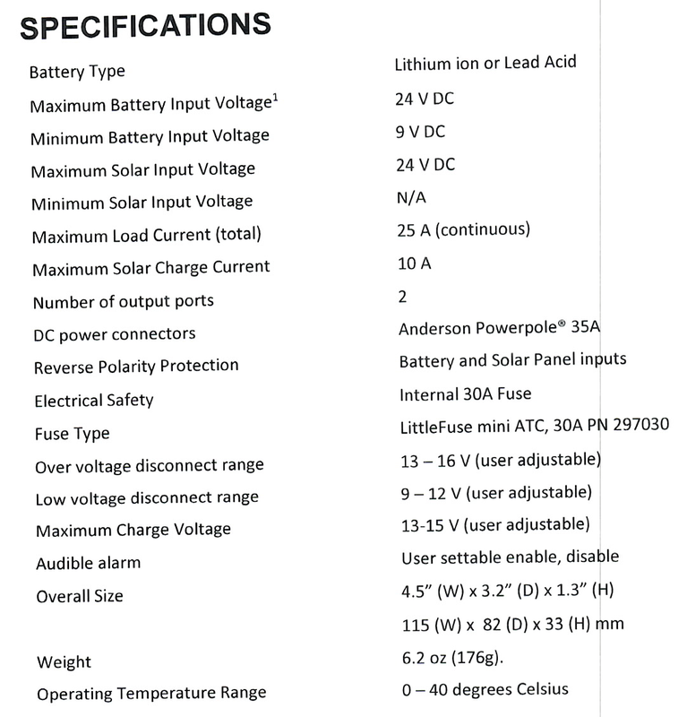

K0UA--- Great link to more info. Thanks. I had looked into solar a few year ago and never got into this much. Then I had this opportunity come along. I'm cheating by asking these questions: normally I would do more research... :)
Hmm. It just hit me-- I have the Buddipole Power Mini charge controller..  I wonder if that would work.
http://www.buddipole.com/powermini.html
Max Load Current: 25 A continuous
Max Solar Charge: Current 10A.
Thanks, guys.
Rick

« Reply #13 on: July 29, 2019, 05:44:01 PM »
Rick,
If those specs are correct, then yes that controller should work.
The margin on load current is a little thin for my tastes, but it should work just fine, IF it is RF quiet.
Make sure to set the parameters on the controller to match your battery and its parameters.
Also, test before you go into the field with this setup to make sure that the
controller you use does not generate RFI for your rig.
You don't want your solar charge controller to generate QRM that will prevent you from hearing anyone.
73 de N8AUC
Eric

« Reply #14 on: July 29, 2019, 07:33:48 PM »
Got it. I think I used it for Field Day 2 yrs ago. Just forgot I had it until this discussion. I remember having some RFI but I was also running a little 2kw Champion genny and I thought that was the culprit. I'll test and see before I put money into a different controller.
Thanks!
