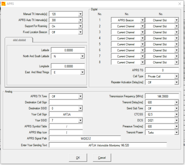

I recently purchased an AnyTone AT-D878UV. My intended use for it is to provide an Amateur Radio to have with me on long bicycle rides.
What I want to do is to make it transmit my current location to https://aprs.fi about every five minutes. I would like a short message with it, but right now I just want to get the first step. The short message would be a form of, "AF7JA Velomobile monitoring 146.520."
There are a plethora of videos, but I can not find any that actually start at, "how to make it work." Can anyone point me at anything that answers, "how do I make it work?"
As stated, the first thing I want is location reporting based on the internal GPS.

This is where I am. Obviously, there is something else I need to turn on because it isn't sending a beacon.
Looks like you can use the programming software to configure the radio to transmit your location and a comment ("sending text") that goes out with your location, which could be something like you mentioned above.
If you want to do more than that with APRS, you'll probably need to go with a different radio, or use something interfaced with your radio to get more APRS functionality.
Good luck, and 73!
No, the pretty much describes what I want it to do. The remaining question is how to make it do it. Do I need to leave one of the two VFO's set to 144.39?
It seems odd to need to do that because I defined the TxFr in the Transmission Frequency [MHZ] Field.

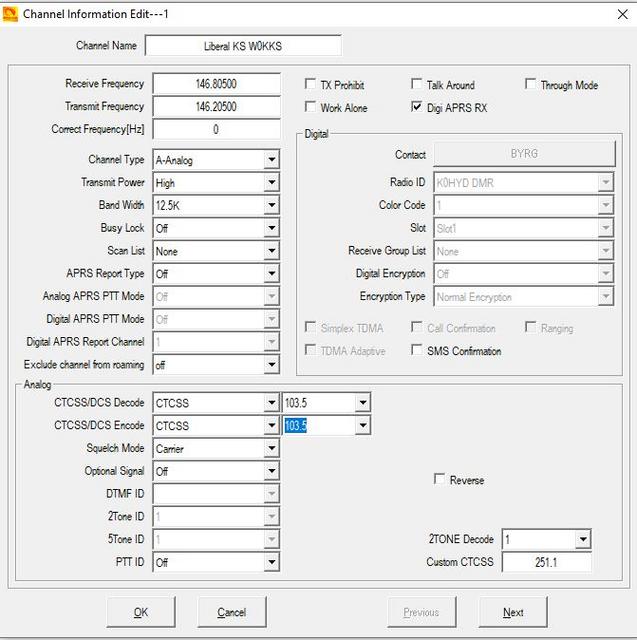

I found this in the documentation:
NOTE:  Final Setup of APRS sending is done on the individual Channel details.  Each Channel must have APRS Analog or Digital Mode selected as ¡°On¡± and a Digital APRS Report Channel must be selected.  Open the Channel details screen by double clicking a channel.  Clicking on each field in the screen will provide information for each field, including APRS.
Important Information for Anytone Analog and DMR-APRS Location Reporting:
A) Anytone DMR-APRS Location Reporting was developed using the Brandmeister DMR networking system.  Other modes or systems have not been tested and may not be able to pass DMR-APRS Location Reporting data to APRS.fi depending on setup and local conditions.
B) When the radio transmitting or receiving DMR-APRS Location Reporting data, the radio will not respond to any other operations. The transmit cycle for DMR-APRS Location Report signals is very short and this should not be an issue for normal use.
C) Some users may get the DMR-APRS Location Reporting working perfectly, but others users may have issues getting DMR-APRS Location Report working. The reasons why it doesn¡¯t work for everyone are not yet fully understood, but we believe local conditions with servers and networks may cause these issues.
D) If you have issues getting the DMR-APRS Location Reporting working, please know that it is not a radio hardware issue. We believe it is likely to be FW or Hotspot / Repeater / BM set up problems when it doesn¡¯t work. As we receive feedback on these issues we will continue to make improvements in the FW and try to address any repeatable issues.
E) GPS location DMR-APRS Location Reporting sending only works when the GPS is positioned successfully.
F) Please note that DMR-APRS Location Reporting data sending may be interrupted if the selected radio Time Slot for DMR-APRS use has other traffic on it.
G) Anytone welcomes feedback and constructive comments for the DMR-APRS LOCATION REPORTING feature and we are committed to continuing to improve this mode of operation.  Please contact your dealer with your comments.
So, here is the channel programming screen:
As you can see, I did find the Digital Rx selection, however, I did not find the digital and analogue report switch as named in the first paragraph above:

I own an Anytone 878 and I have used the APRS feature.
First, the GPS is a royal pain in the ass. Something is horribly implemented. I suggest you to upgrade the firmware to 1.15, which includes a tweak to disable the support for the "Beidu" Chinese satnav network. It seems that even when the Beidu signal is not good, the unit favors it instead of the good old GPS. The result? Lock times longer than an hour for me in Spain (IN83) even with full unobstructed sky view.
Now, APRS. It supports "Digital APRS" (which is not real APRS, but position reporting through DMR to the Brandmeister network) and "Analog APRS" which is true APRS.
In order to have "Digital APRS" working you need to be in an area covered by a DMR repeater and of course have a DMR channel active.
For Analog, real APRS it's easier. You don't need to bother programming a VFO, seems it just switches frequency when sending an APRS packet.
For any of the two variants:
APRS -> Upload Beacon -> GPS beacon (I imagine)
APRS -> Intervals Set -> (Select the interval you wish)
For "Digital":
APRS -> Digi APRS -> PTT Upload (yes or no, your choice)
APRS -> Report Channel -> "Cur Chan"
APRS -> Upload Slot -> Channel Slot (unless told different by the DMR network admins)
APRS -> Upload Id -> (ask network admins for the destination ID, it sends a private message to this ID)
Menu APRS -> Upload Type -> "Digi APRS"
To set "Analog (ie, real) APRS":
APRS -> Ana APRS -> PTT Upload -> (again, your choice)
APRS -> Ana APRS -> Upload Power -> Your choice
APRS -> Ana APRS -> Upload Freq -> (the APRS frequency in your area)
APRS -> Ana APRS -> Signal Path -> WIDE1-1, WIDE1-2 if you want digipeaters to repeat your packet
And basically that's it. The user interface is quite confusing but it works.
