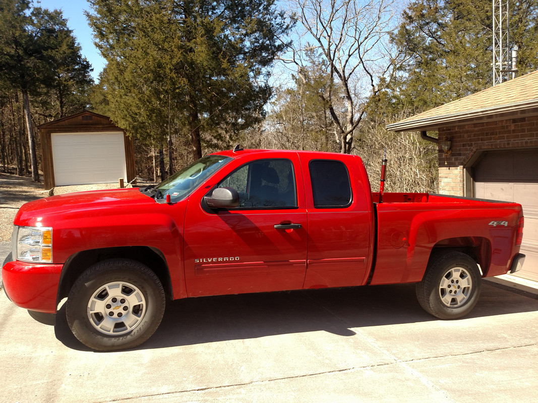

RE: I was right (more or less)
« Reply #13 on: October 11, 2019, 12:22:59 PM »
V/U activity is sparse at best and that's what prompted me to try HF mobile.  Fast forward a few decades later and HF mobile is still one of the most favorite things I do in the hobby.
Same here. I make far far more HF contacts mobile than V/U.  I am fully equipped for V/U also and do use it to hit local repeaters, but my "bread and butter" is HF mobile.  More 20 meters than anything, although I have made contacts from 80 thru 6 meters mobile.  There is always someone to talk to on HF mobile. I have worked several countries in the caribbean, south america, africa and europe and on Asia on 20 meters. Let alone many many north american contacts.
Heck I worked a dozen guys in California on the way home from eating dinner in Nixa Mo. to my home in Branson, Mo.  About a 30 minute drive and yes the California QSO party was going on so there were lots of "targets", but still, HF mobile is the way to go.  I have a Little Tarheel II on my Silverado.  It ain't too big. I did replace the stock 32 inch whip with a 48 inch one to improve performance a bit. so it is 54 inches tall.  or a bit taller on when tuned to 80 meters. But still under 5 foot. It works very well.  Now believe this or not, up to you, but my first HF mobile antenna was an MFJ 3 foot tall "mini-hamstick". Yep, a dummy load on a stick, but I made a lot of contacts on 20 meters on that thing. Including some caribbean contacts. So don't give up on the HF mobile idea until you have tried it.  I run a little FT891 in the truck.  It is about the size of a V/U rig and puts out 100 watts maximum.
So is the Tarheel screwdriver antenna a bunch better than the 3 ft. tall mini hamstick?  Yep. It is. But I did have fun with the $18 hamstick.
Of course the Tarheel screwdriver antenna was $400 and the controller another $139 so there is that..  I stand by to help answer any questions about my HF mobile installation or anything else you want to talk about.

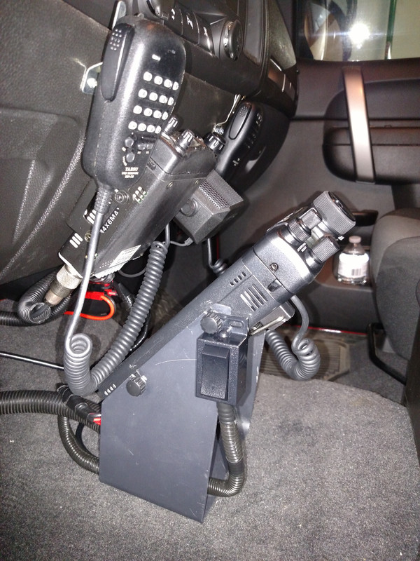

image hosting anonymous
« Reply #14 on: October 11, 2019, 12:54:24 PM »
Here is the interior of the truck showing the little Yaesu Ft90r Vhf/Uhf rig mounted to the dask It is tiny. and FT891 mounted to the floor. At this point back in January 2019 I am still using the manual controller for the Tarheel antenna.
