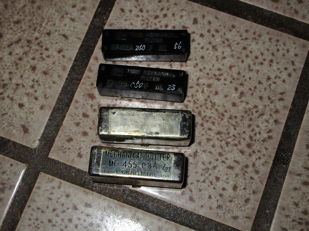

Kokusai mechanical filters are well known to have a problem that foam packing for the elements will deteriorate into a gooey mess.
This link shows how to repair them.
http://jlkolb.cts.com/site/koku.htm
My Yaesu FLDX400 transmitter has the same filter described in the link above. I took it out recently for examination.

Hamhock75, regarding your pictures, I was surprised to see that the Kokusai filter does not appear to be hermetically sealed.  Is that actually the situation?  If it is unsealed I imagine the ravages of time work faster.

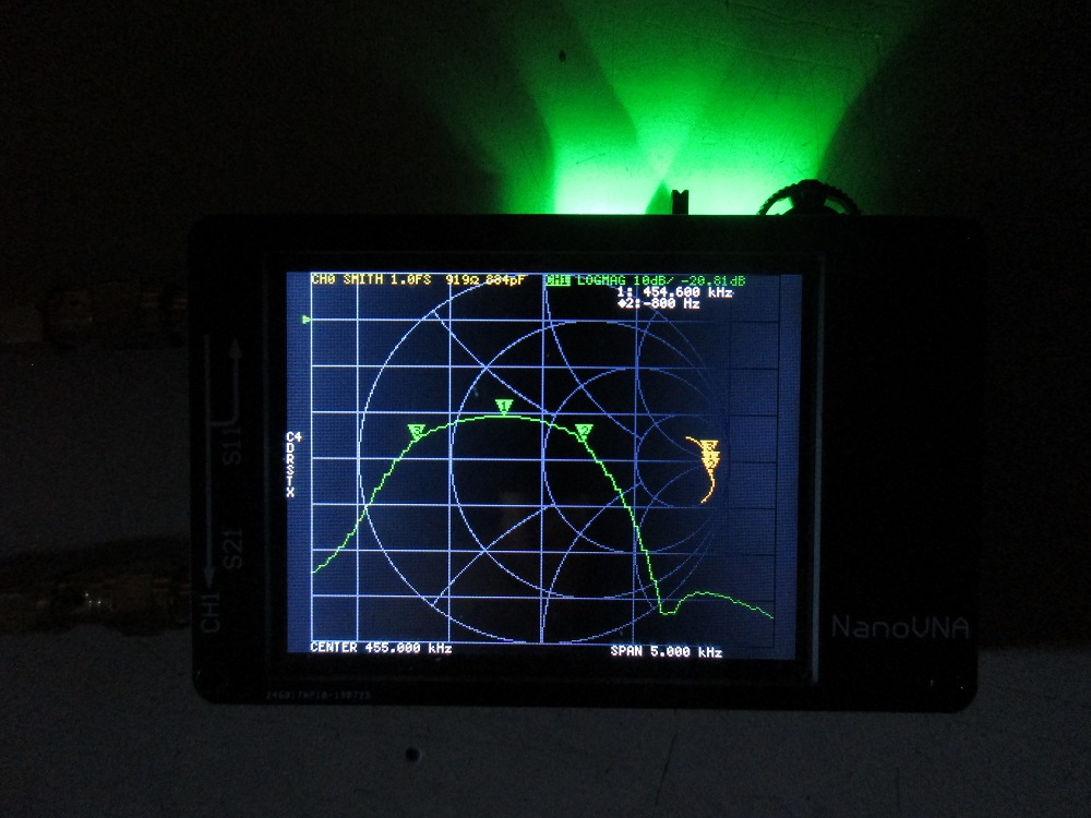

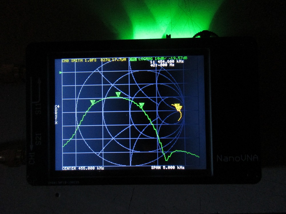

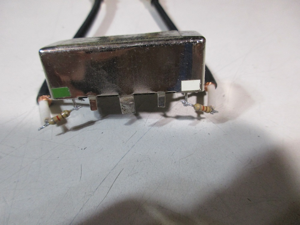

820 ohm resistors were added in series with the output and S21 input of the nanoVNA to match the approximate input and output impedance of the filter. Other than the expected additional mismatch loss, the center frequency, bandwidth, and general shape of the pass band did not change.

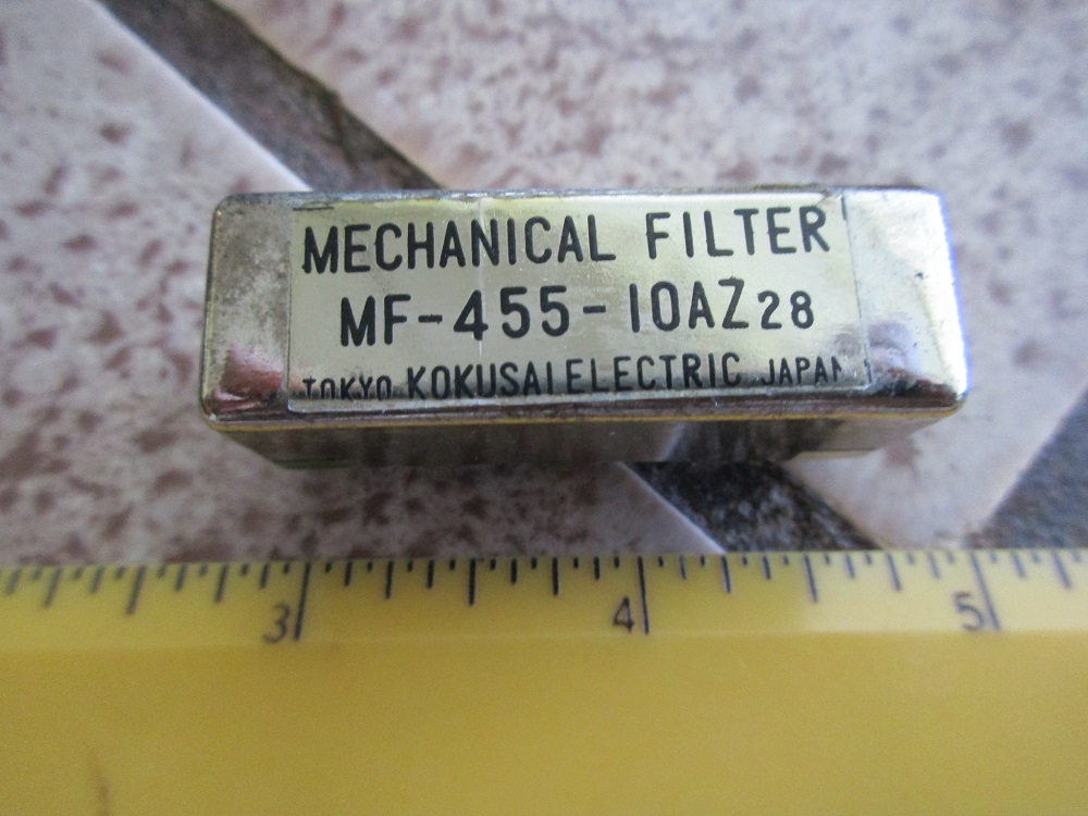

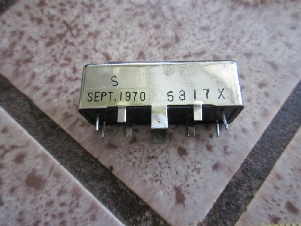

These MF-455-10AZ28 filters are, as VK6HP noticed, not well sealed. The metal cover simply has four metal tabs that fold over the plastic bottom. Regarding Owen Duffy's blog. I enjoy testing tube gear but have always been hesitant to connect up an expensive VNA due to the possibility of accidental damage from the voltages in tube gear, but due to the low cost of the nanoVNA, I feel much more comfortable doing that.
The carrier oscillator is at 453.5 kHz, the filter is centered at 454.6 kHz ( which is about 400 Hz low and out of specification by 100 Hz ) with a 1.8 kHz bandwidth ( the minimum bandwidth at -6 dB is specified at 2 kHz ) so the SSB audio passed is 200 Hz to 2 kHz. In spite of all the out spec conditions, it still works although the audio is a bit narrow.
It will be interesting to look inside next.

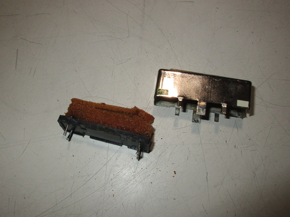

Here are photos of the filter with the 820 ohm resistors added and the nanoVNA result.

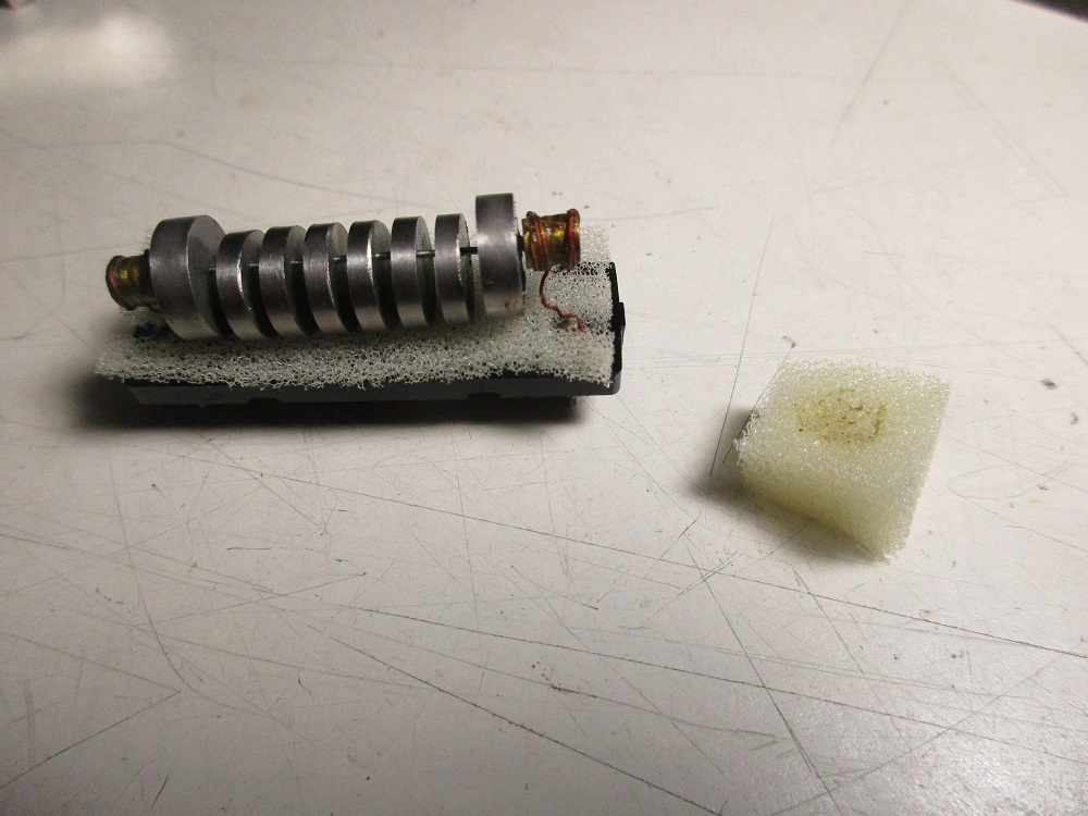

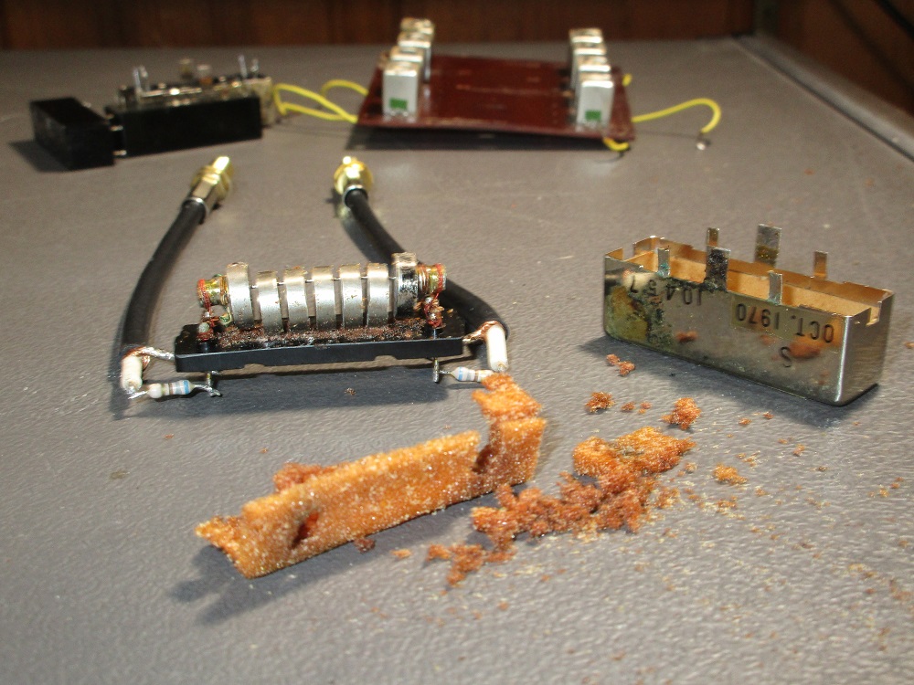

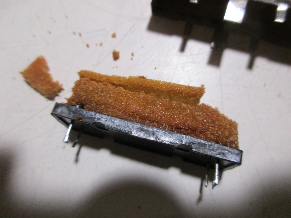

Next begins the disassembly of the filter. Four tabs hold the cover on. Once those tabs are bent open, the top metal cover will slip off. Inside the metal cover is a cardboard piece. In the photos below, it is clear that the foam has become brittle and pieces come off just from the disassembly.
The foam is dry however until near the base. Some authors believe that the foam disintegrates into a gooey mess. A gooey mess was found at the base but I am not convinced that it is from the deterioration of the foam. It has the consistency of rubber cement and is not hard but is pliable. Based on the last photo the six center elements appear deliberately glued to the base with the end transducers floating.
Does anyone have any thoughts about that?

Wish I had an answer to the floating question. What does the VNA do when you tap them lightly?  Maybe just some new foam will help.
In Collins filters Ive opened the goo is thruout and I use pieces of seat cushion foam to replace. Maybe the originals were glued in place and the resultant goo took decades to affect all the foam. Since there are numerous styles of their filters produced over many, many decades I can only speak to what I have actually seen.

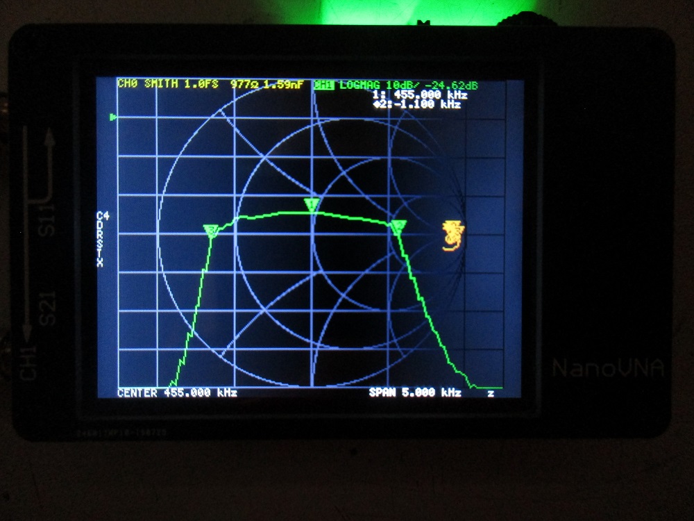

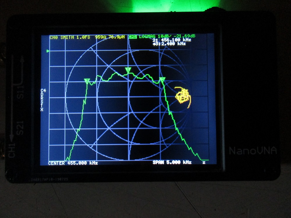

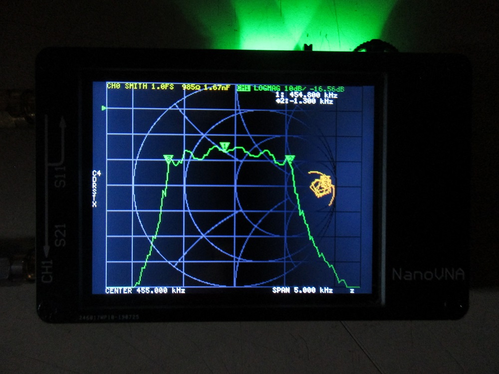

The filter was tested with the nanoVNA after most the foam but not the cement at the bottom was removed. The results were the same as before. I decided to remove the cement. The following scan shows significant change. The center frequency has shifted up and is now in specification, the bandwidth increased to about 2.4 kHz and is also now in specification, and the insertion loss decreased.
As shown in the photo, the nanoVNA has a nice feature that if you select one marker, then another, it displays the frequency difference between them. In this case 2.4 kHz between markers 2 and 3. The scan below is with the filter directly connected to the VNA without any 820 ohm resistors.
The above image with pass band ripple is what had been expected from a non-Butterworth multi-pole filter design. To explore a bit more, the impedance varies considerably between peak ( 410 ohms ) and valleys ( 985 ohms ) in the pass band as shown in the images below.
I also explored how much pressure could be exerted against the filter elements before a noticeable change occurred which would help determine how much the foam could press against those elements. I pressed against the elements with my fingers and found they could tolerate more pressure than I expected. The harder I pressed the more the VNA display moved towards the images before the filter was restored.
I have begun exploring how to replace the foam. One obstacle was how to create an end cap for the filter where the wires attach. In the photo below, I found it was very easy to create a depression in a piece of foam for the end cap by pushing the tip of a soldering iron into the foam.

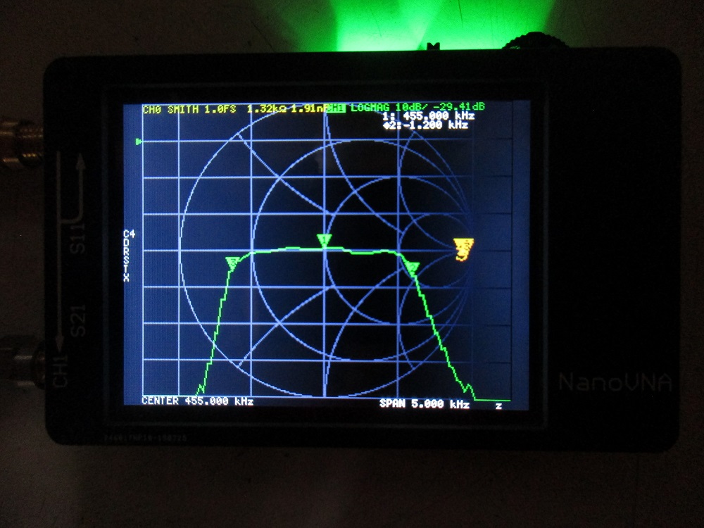

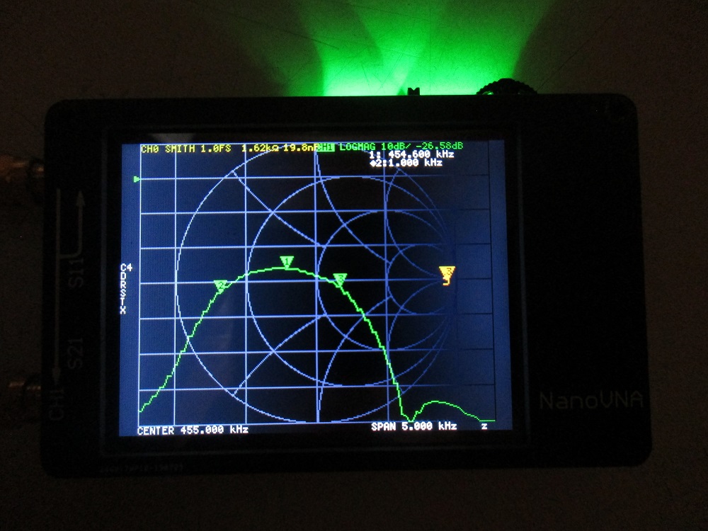

Load resistors were added in these two photos after the filter had been reassembled with new foam. The first load is 680 ohms  which is actually 680 plus 50 ohms from the VNA for 730 ohms total. The insertion loss is mostly from the resistors. The second photo has load resistors of 360 ohms plus 50 ohms from the VNA for a total of 410 ohms.
In the first photo above, the measured input resistance is 1,320 ohms. Subtract 730 ohms for an actual input resistance of 590 ohms. In the second photo, the measured input resistance is 977 ohms. Subtract the 410 ohms for an actual input resistance of 567 ohms.

You beat me to it in suggesting some experimentation with the termination.  Often, the passband ripple (or variation) can be optimized by fine tuning the termination, including adjustment of a trimming capacitor.  Your filters are low impedance types and are probably a bit less critical but you could try some fine adjustments.  For example, here's the response of that Collins AM filter I mentioned earlier.  It would meet spec with just the recommended fixed parallel input capacitors but some adjustment makes for a much nicer response.
Ignore the details of the spectrum analyser settings - it was an early experiment with the instrument.

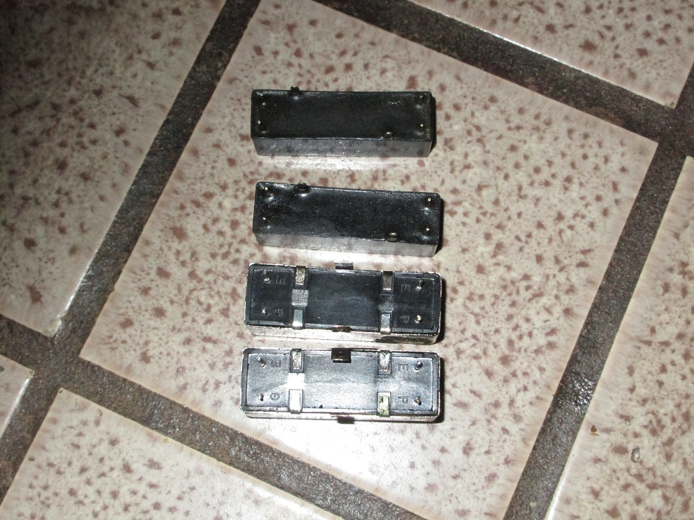

There are a total of four mechanical filters in the Yaesu FRDX400 receiver for CW, SSB, AM, and FM.
Two are made by Kokusai and two are by Toko. The Kokusai filters are serviceable but the Toko units appear to be potted.

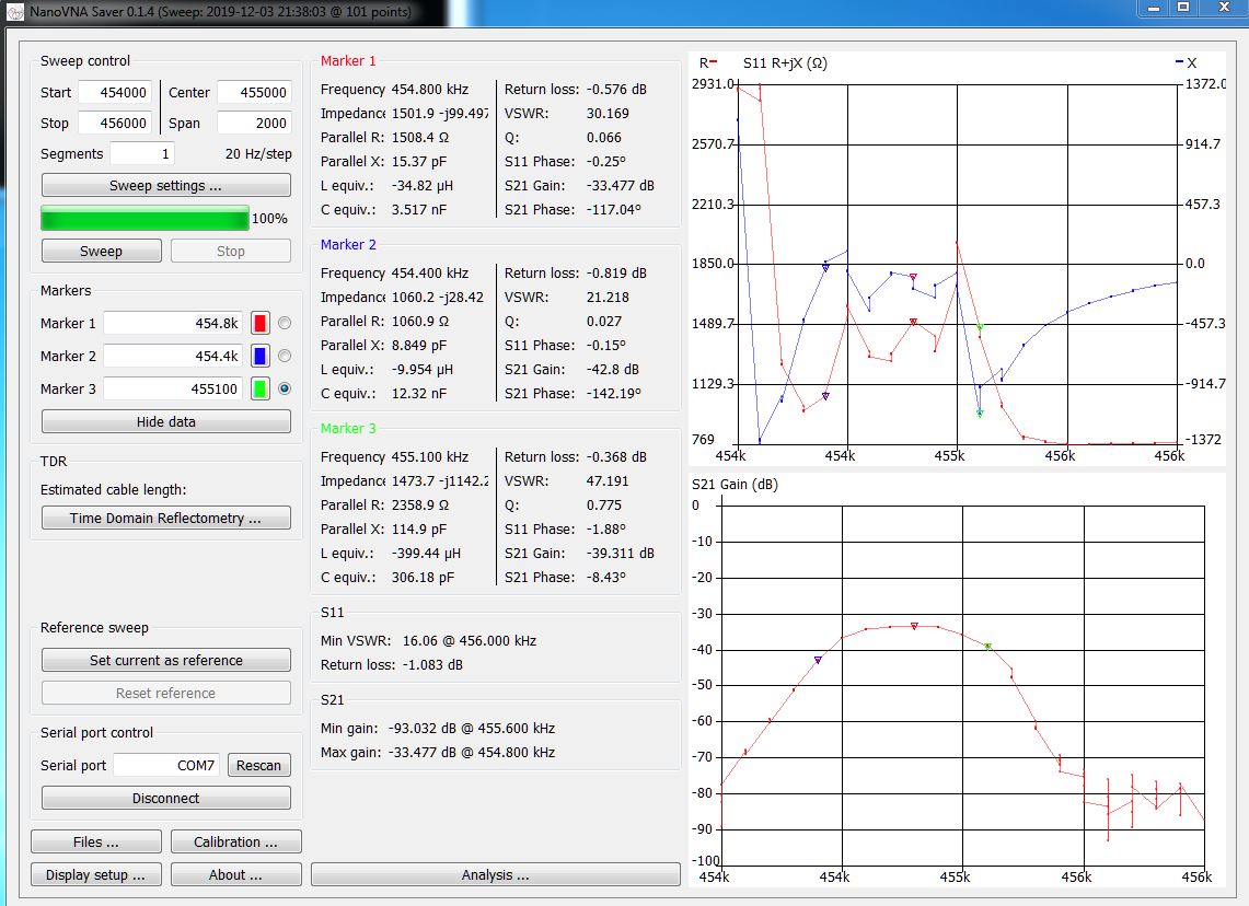

One of the Kokusai filter has the labelling scrubbed off but a test shows it is likely the same filter repaired above but with slightly narrower bandwidth and more loss most likely due to some degradation. The MF-455-03AZ27 is a 600 Hz filter. It shows the most degradation with more than 20 dB loss. It was disassembled and repaired the same as above. Below is a photo taken during the clean up process. It was very similar in condition to the above filter in that the foam was crumbly but for the most part intact. Again the center elements of the filter were stuck to the plastic base.
Instead of a photo of the nanoVNA, the software nanoVNASaver version 1.4 was used. The software has the advantage that it allows more types of output for S11. The capture shows S11 as an r + jx output while S21 is log-magnitude.
There may be some issues with the nanoVNA or the software in narrow sweeps like that above. The step size says 20 Hz but the display appears to be 200 Hz steps. The frequency scale does not read out properly
Version 0.1.4 of nanoVNASaver was used because the two newer versions 0.1.5 and 0.2.0 had issues on my computer with markers. With 0.2.0 an attempt to use or enter a marker frequency crashed the program. With 0.1.5, I could enter the marker frequency but the marker would default to the left side of the screen and could not be moved.
The filter itself appears to be now in good working order. The 6 dB bandwidth is about 600 Hz and the insertion loss in the above capture of 34 dB is about the same as the filter repaired earlier with 680 ohm resistors in series with the source and load.
