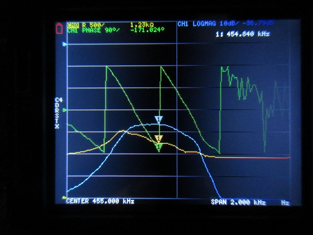

This is a capture of the 600 Hz filter replaced in its housing with new foam. The insertion loss increased a bit. This data was taken with a nanoVNASaver 0.2.1 software release which occurred just about 14 hours ago. This release solved the problem with setting a marker crashing the program.
Discovered the problem with a 2 kHz sweep is a problem that has been fixed in firmware.

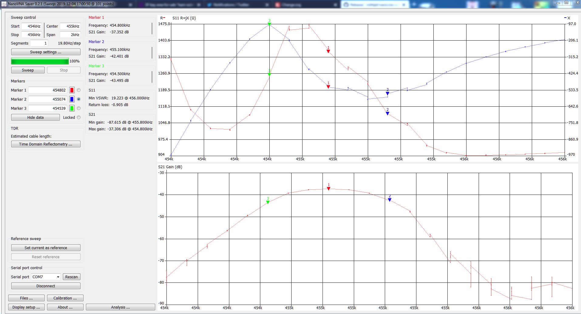

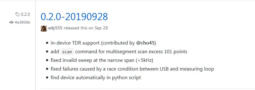

« Reply #18 on: December 06, 2019, 06:01:21 AM »

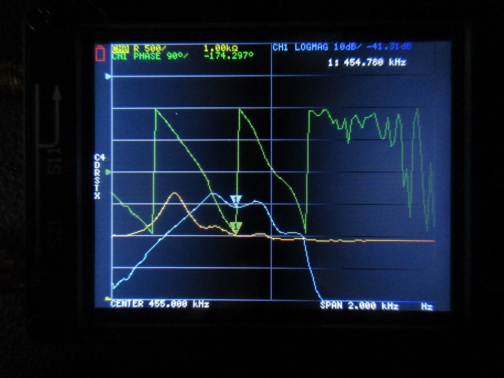

Updating the firmware on the nanoVNA was an adventure in itself but here is the result of scanning the 600 Hz filter with the latest firmware. Notice the red circled term “Segments”. The number of segments refers to how many 101 point segments make up the sweep so five segments means the 2 kHz span is broken into five, 400 Hz segments of 101 points giving rise to the 3.96 Hz step size.
The horizontal frequency labels are still strange but the marker frequencies are accurate.

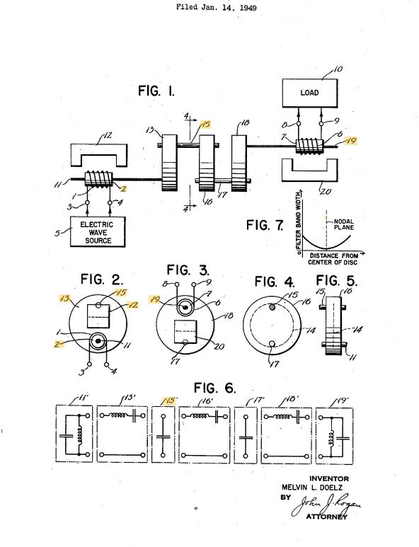

This is a further examination of how these filters work regarding the mode of vibration and how the bandwidth is determined. The photo below is from the Collins patent of 1949 listed earlier. Figure 7 indicates that the bandwidth is determined by the distance from the center of the disk at which the connecting rods are placed but perhaps the most important detail is the reference to a “nodal  plane”.
The nodal plane refers to a circle about the center of the disk at which there is no motion. The animation at the link below illustrates this,
https://www.acs.psu.edu/drussell/demos/membranecircle/mode02-2.gif
Placing the coupling rods near the nodal plane where there is little motion, mechanically, lightly couples to the vibrating disk. The animation also explains the insensitivity of the filter to being touched at the edge of the resonators since the edge is also not in motion.

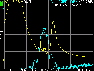

This photo shows what the patent refers to as the older Langevin transducer. It appears to be ceramic with two gold endcaps. The reddish wire is the drive wire. The photo tries to show an unusual characteristic of these filters. What appears to be a copper and green wire is actually just one wire which is green on one end and copper color on the other. This is done only on one end of the filter. The opposite transducer only has a copper colored ground wire. The patent never mentions why this might be done.
Also of interest is that the coils are glued around the resonator endcaps only to serve a strain relief function.
W9AC. Thank you for the paper. I was unaware that Collins filters looked like a 940 uH coil at the input. I suspect that is because Collins uses a magnetostrictive transducer. A variable capacitor was added externally to resonate with the coil forming a high pass filter which transforms 50 ohms to 145 kohms with the filter actually presenting an impedance of 12-16 kohms with resultant mismatch loss of 4-6 dB.
The Kokusai filter looks more like shunt capacitor across the piezolectric element which the patent mentions is “several kil-ohms or less” at resonance. I decided to create a lowpass matching network consisting of a shunt capacitor across the filter input which absorbs the transducers capacitance with a series inductor. With the ability to control both component values, I found that a 100 uH inductor with a 1000 pF capacitor could both resonate and match at the same time to about 1.7 kil-ohms. The result is below is almost a perfect match in the filter passband to 50 ohms. Unfortunately, this filter still has problems. It is more than a kHz too low in frequency and the passband ripple is severe. I suspect that the two problems are related but will need more investigation.
If you noticed the white strands attached to the weld for the ground wire connection to the adjacent resonator in the first photo; I tried your suggestion of a cotton ball instead of foam.

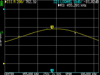

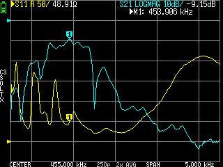

The matching network was changed to transform 50 ohms to about 800 ohms using 70 uH in series with a shunt capacitance of about 1,660 pF.  Below is the measured that 50 ohms is transformed to about 762 ohms. The change had little effect on ripple, center frequency, or loss.

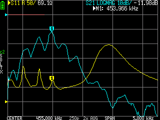

I used some 600 grit wet/dry sandpaper to clean up the resonators but that also had little effect. When I polished the endcaps of the transducers produced a dramatic change in both loss and flatness as shown below. Frequency is still low by about 1 kHz however.
