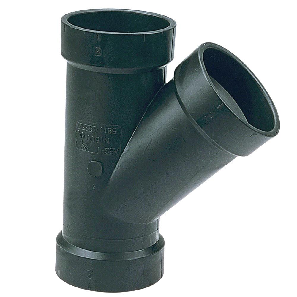

Most have a coax connector coming out the bottom.  This actually makes for an easy
installation:
My vent pipes are standard ABS pipe, but you can do this with other types as well.
Get a "Y" fitting that looks like this that fits on the top of your vent:
Stick it on top of the vent pipe with the angled leg going down to one side.  Stick the coax
up from the bottom of the angled leg and out the top, and attach it to the ground plane.
Then just set the ground plane on top of the fitting - if you want to get fancy you can bend
the radials so they run horizontally to the edge of the pipe then angle downwards.
And...   that's it.  The weight of the coax holds the antenna in place (you can secure the
coax to the vent pipe if you need more retention strength.
If you want it higher, just use an extension of ABS pipe and a coupler between the top of
the vent and the Y fitting.

And using the above "Y" fitting if you want to save money on the antenna you can make a 1/4 wave 2 meter vertical very easily and on the cheap.  Get an SO239 chassis connector. Solder a 19 inch copper wire or for more stiffness a piece of brass welding rod to the center pin and make 4 "radials" of the same length bent downward at about 45 degrees. Plug in your coax thru the "Y" and weatherrpoof that connection. The 1/4 wave antenna can sit on the "Y" top or if need be you could cut 4 slots  in the top of it for the radials to set in.  Paint the whole thing the color of your roof, and you wouldn't even see it 10 foot away.
Total economic outlay would be very little, and just a small amount of work.
For a really stealthy install, If in the attic you can get you hands on the vent pipe you can drill a small hole in the side of the vent pipe and fish up the coax inside the vent pipe to the top. Be sure to seal the hole with waterproof sealant  and a small drip loop  inside the pipe would be a good idea too. You don't want rainwater coming down and following the coax out into the attic space.  Rainwater coming down into the pipe into the sewer drain is fine, but not coming out into the hole you drilled into the pipe.
In this manner no coax is showing on the outside of the pipe, No "Y" adaptor needed,  Just paint the antenna and pipe on the outside the same color as your roof and it will blend in.
