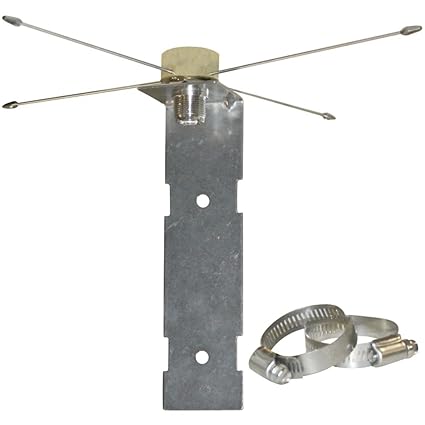

What I would consider doing in that situation would be to get something along the lines of the Larsen BSAKIT and an NMO mount antenna such as the Larsen NMOQBLACK or NMOQC and put them together.
You would want to cut the antenna element to length and the radial elements may benefit from a trimming as well, but it would be a relatively simple and effective install and wouldn't put much additional loading/stress on your vent pipe.
I haven't personally used that particular kit and there are other companies that make similar products, but I've been satisfied with my results with other Larsen products so would probably go that direction.
There is a good chance you wouldn't need much or any mast to use it with your local repeaters, but a short piece of painted 2x4 could be used if you wanted to get it a bit higher above the vent pipe.

For a drop-ship solution, an NMO ground plane kit plus quarter wave NMO whip checks the box.  That's what I'm running on the roof of my garage.
KC0MYW
  • Posts: 113
Re: 2M FM antenna SMALL suggestions
« Reply #6 on: December 05, 2019, 12:24:45 PM »
Yep, that's exactly the type of setup I was referring to.
