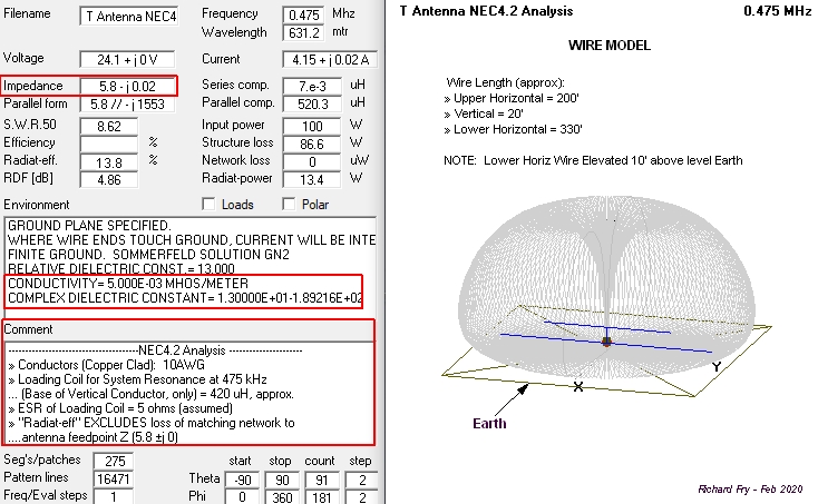

...I have the wire(1000' 14ga stranded copper) and the room.  It will be low...20-30' high end to end(if I can find enuff supports).  Seems everyone is using verts. or other short antennas.
Below is an example of a 475 kHz v-pol antenna setup that might fit your installation site:

If you can get away with using the same antenna for transmit and receive on MF and LF, count yourself lucky.  There are some very successful operators who manage it but they are often based in more remote, RFI quiet locations.  Even then, as Carl implies, it's useful to have a few receive options, perhaps including a loop or Beverage, if only to account for propagation variability.  For most of us working from more urban locations separate antennas are usually the order of the day.  Nevertheless, most of us do set up the T/R switching etc so that we can listen on the transmit antenna if desired.
While there are a lot of local variables, I find modelling of the type shown by Richard to be extremely valuable, if only as a way of underlining some of the inconvenient truths that often get lost in anecdote and in the face of desperation.  There's a great deal to be said for getting into the ballpark with a given design, especially at these low frequencies where structures are large and the effort in getting something erected and working can be significant.
With a bit of space and wire available, Trip (OP) could do worse than give the elevated T a go. I'd probably be tempted to increase the height of the vertical section a bit but, regardless, it'd be a good place to start.

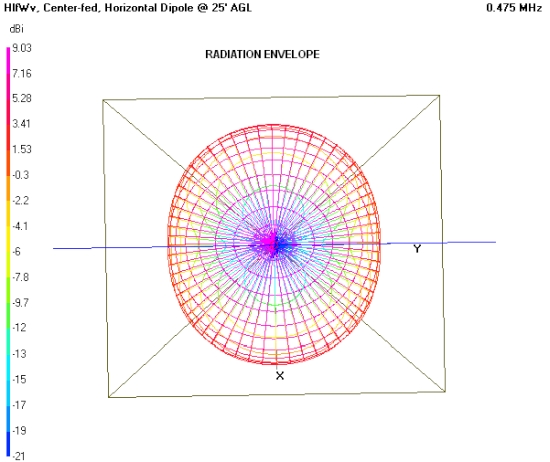

I'm a little fuzzy on this so please correct and teach as needed. I believe EIRP is figured using the maximum antenna gain in the far- field. If so, we use the maximum antenna gain which is straight up for the dipole and at 21 degrees for the vertical. The dipole maximum gain is -6.3 dBi while the vertical is -17.3 dBi. Within the confines of the FCC 500 watt max RF input or 5 watt EIRP limits this says the dipole can be driven with a maximum of 21 watts and the vertical can be driven with 269 watts, or 11.1 dB more than the dipole. At an elevation angle of 30 degrees the dipole gain is -12.3 dBi and the vertical gain is -17.6 dBi. While the dipole exhibits 5.3 dB more gain at 30 degrees the vertical can be driven with 11.1 dB more RF power giving it 5.8 dB more signal at 30 degrees.

...Let's compare a half wavelength dipole 25' above 0.005/13 GND against a 30' vertical. Note that the dipole exhibits maximum low angle gain off the ends.
NEC4.2 is showing maximum radiation perpendicular to the length of the dipole (below).
Have you investigated/compared the radiated fields from your dipole and your vertical including the surface wave for elevations ranging from zero to about 15° at a distance of 50 to 100 wavelengths from the radiators?
« Last Edit: February 24, 2020, 01:39:05 PM by RFRY »

I believe the gains reported are calculated by NEC-2D are figured beyond 100 wavelengths.
What dipole azimuth pattern does NEC4.2 show at 10 degrees elevation?
If my numbers are correct one can meet the 5 watt EIRP FCC limit using a modest vertical driven with less than the 500 watt FCC max RF power.
