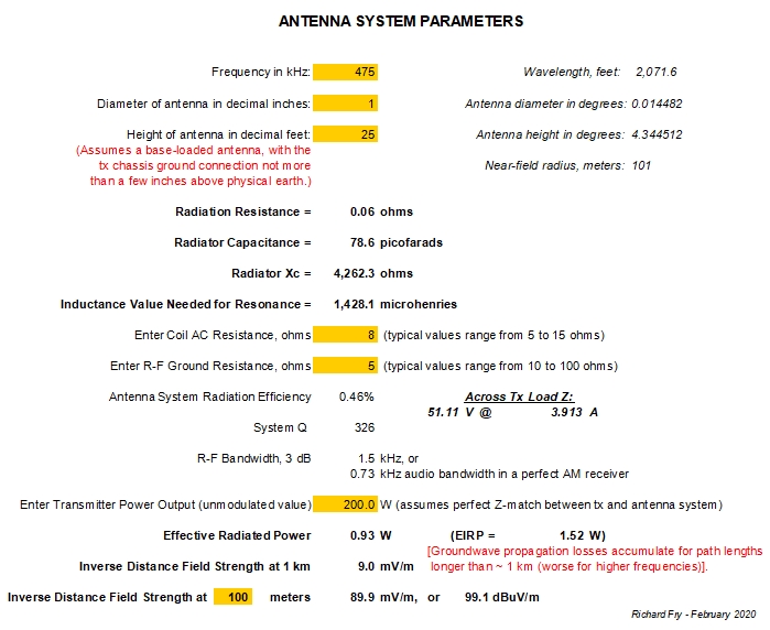

« Reply #26 on: February 25, 2020, 04:40:57 AM »
Below is a spreadsheet calculation showing the ERP & EIRP for 200 watts across the feedpoint terminals of the antenna system described there.
Assumptions were made for (hopefully) typical values for the ESR of the loading coil and the resistance of the system connection to r-f ground.  I may have set the ground R rather low, but it could be possible with a decent set of radials buried in Earth of high conductivity.
The big problems here are that few users accurately will know what those values really are.
Re: 630M Dipole????
