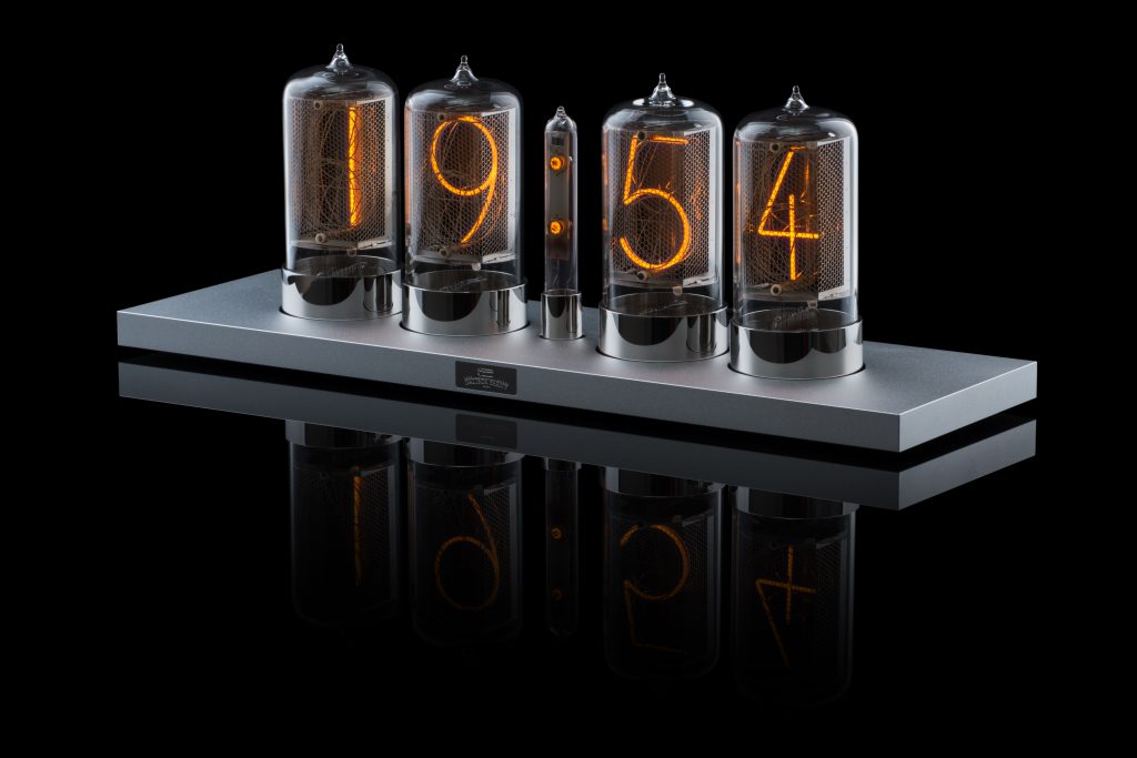

It has been said that MFJ products are "semi-kits" that you finish building yourself.  Personally I haven't had a lot of trouble with the few that I've owned, but all have required some work at some point.
For "cool factor" you can't beat a Nixie tube clock.  I bought a couple of kits years ago from a guy in the UK.  They're not cheap, but they do carry bragging rights!  :)

... For "cool factor" you can't beat a Nixie tube clock ...
If you want to spend a lot of money you can buy a Nixies with 10 years warranty for almost 1500 EUR. If you are interested, you can obtain link from included picture. :-)
Mira OK4FX

I have a Nixie tube clock but, alas, it has an RFI issue so I have stopped using it.
