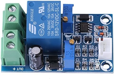

I was running my Kenwood TM-D710G on high power APRS to see how long it will run on a 12V 35Ah battery. It got down to a point where the radio kept cycling on and off. Is there a specification I might reference on a limit voltage for this radio? And a low-voltage cut off switch I might install to simply cut voltage rather than see this power on/off cycling?

Consult your manual for the specified minimum voltage and remember that cords, fuses, etc. will add resistance, therefore requiring a higher battery terminal voltage. You will also find the internal resistance of the battery will cause the battery terminal voltage to plunge when the radio draws more current in transmit mode.
Here is an inexpensive device that can cutoff the load at a user selectable voltage and restore power when the battery is charged: https://www.amazon.com/Charging-Controller-Protection-Undervoltage-Automatic/dp/B07B49T4DQ.

That’s a nice option, thanks. I’ll give it a try.
The battery is a Jasco RB12350 AGM. I think I discharged it too low as the little QuickSilver Radio Hammo-Can Go-box charger left on overnight wouldn’t bring it back. I put on an Optima Digital 1200 Charger that’s been good at recovering deeply discharged batteries - hopefully I can save it.

You could also look into a small battery booster circuit. This would allow you to use more of the energy stored in your battery while cutting off the load at a specific battery voltage. Some have an integral charge manager as well. Certainly much more expensive though, than the cut-off module I referenced.
