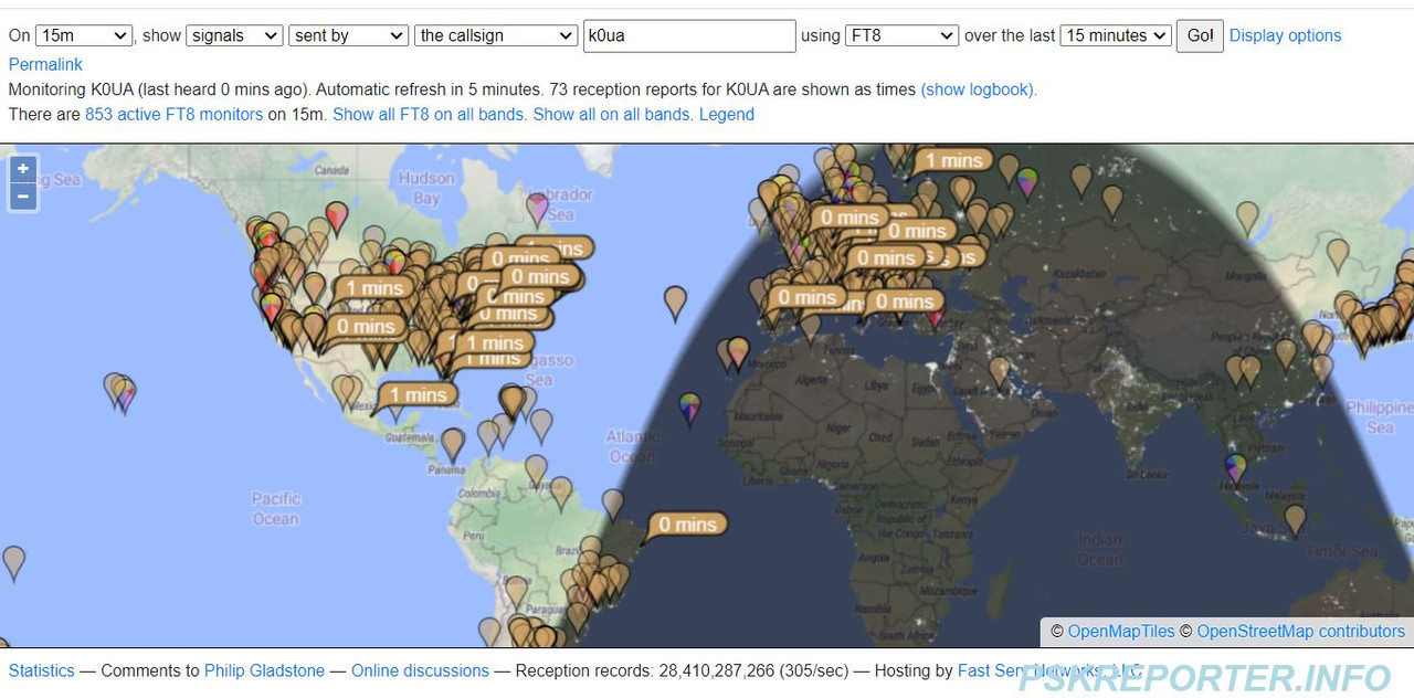

Here is a just now (20:54z) post of my transmitting ft8 on 15 meters with 100 watts chasing RT2F
and a snapshot in time to where my signal is going.

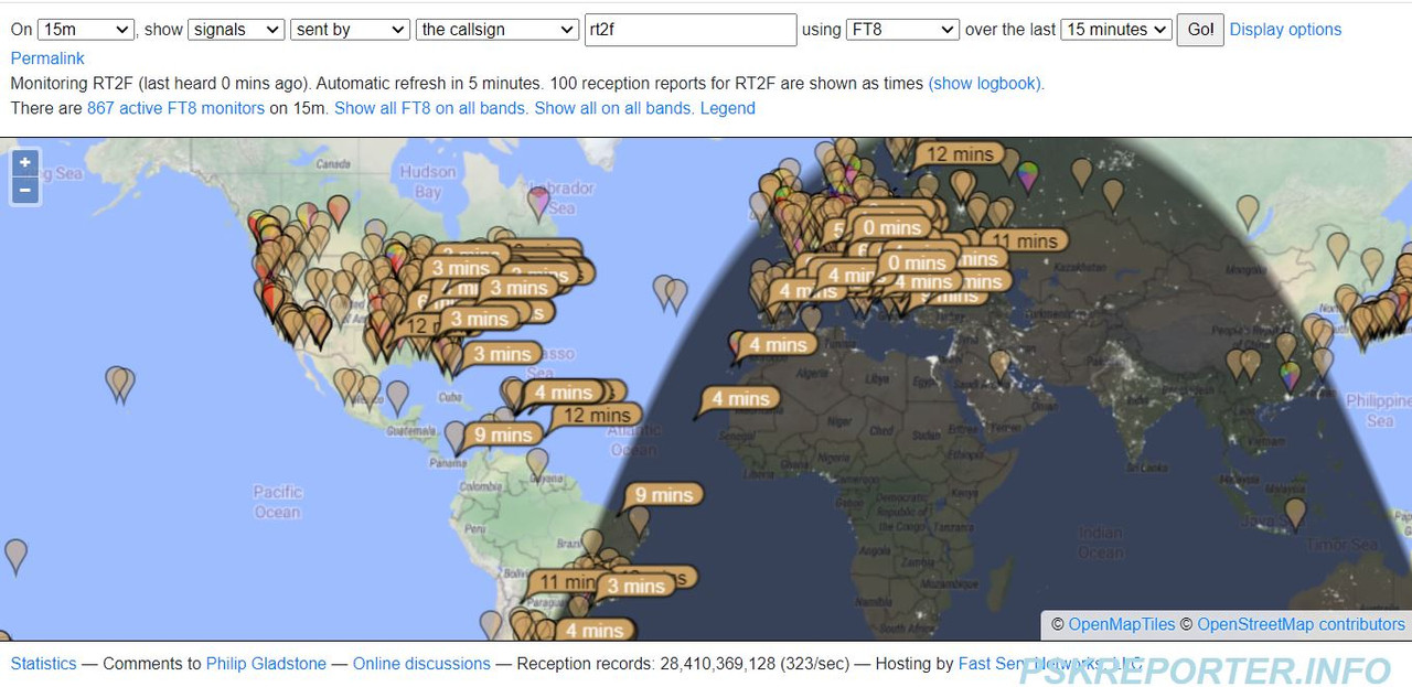

And a couple of minutes later here is RT2F  transmit coverage worldwide. If you loiter on any of the balloons it will tell you who and how well they received him.  He does not post to PSK reporter so we cannot see that.
