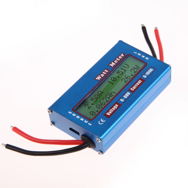

  • Posts: 6823
Re: Power Consumption Calculatiosn (fork from Battery Maintainer thread)
« Reply #7 on: August 02, 2020, 06:20:44 AM »
One of these inexpensive inline power-current-wattmeters is a very handy accessory to have to monitor your power status at the operating position.
