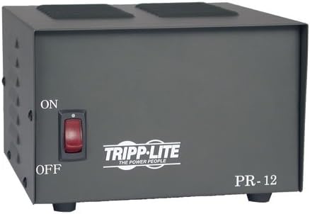

I consolidated a bunch of nominally 12v electronic power supplies by replacing eight "wall warts" with one brick.  The typical draw on the circuit is in the 2A range (as measured with a multimeter), but a full load can draw as much as 4A.  I'm using a 6A-rated brick at the moment.
Even though I'm not drawing more than ~2.5A, my E is drooping to 11.4V.  Without any load, the brick puts out 12.4V.  Sagging 1V might be fine for most of the devices, but I also have a 12000maH LiION battery pack on the circuit (functioning as a UPS).  I don't think I can fully charge the battery at 11.4V.
I think I need either a 13.8V power supply or an adjustable power supply.  I have a sweet Astron RS20A-BB, but it's on the other side of the house powering my 2M base station.
I'm considering an Astron RS12A or Tripp Lite or an adjustable lab power supply like this TackLife.
Maybe any of these are overkill or there is a better option.  Advice?

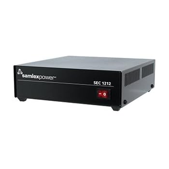

Might I suggest you give up on Astrons and other such low quality amateur radio equipment. For about the same or less money you get top of the line commercial power supplies pros use actually made for radios. Look At Samlex models. They can do something no Astrons can never ever do. Operate at rated capacity 100% duty cycle. Example the Samlex SEC 1212 is a 12-amp supply and can supply 12 amps 24 x 7 365. Exactly what one wants if the want to charge batteries. Do that with an Astron and you have a paper weight. You can even get them with an enclosure to contain the PS and radio.
So you can spend $100 for a POS 12-amp Astron that cannot deliver 12-amps for more than a few minutes, or spend $90 for a Samlex SEC-1212 unit that can deliver a full 12 amps all day long and never get hot.
Another top of the line units are IOTA and many smart hams who use batteries use the DLS15. It is both a 15-amp DC power Supply, but can also Float a battery with a built-in 3-stage charger. Put a set of golf cart batteries on one of these wil run anything you can throw at it even if it needs 100 -amps.
You don't have to over pay for cheap amateur equipment. For the same or less money buy quality. Let sammy hammy use the cheap stuff and throw away money. Both have something else Astron will never have, UL listing and certification. .

I'll keep the Samlex in mind.  I've preferred linear power supplies for my radios in the past to avoid high-frequency switching RFI and also the radio interfering with the power supply.  Samlex acknowledges both:  https://samlexamerica.com/support/faqs/faq18.aspx  I know there are workarounds but like I said, I've preferred to keep things simple with a linear and/or a DC battery (Astron BB series) and no high frequency switching.
What I'm looking for now is not for an amateur radio, but other shack equipment that is normally wall-wart powered.  Of course, from an RFI perspective it doesn't matter what's being powered.  That's why I would consider a linear like the small Astron.  On the other hand, just consolidating wall-warts (and eliminating the noisiest ones), allows me to apply mitigation measures to one or two SMPS instead of more than a dozen.
I'd still like to get a good result without spending ~$100, especially considering that I could use these in two or three locations around the house.  That pretty much rules out linears.  Even used on eBay, they tend to run ~$80 with shipping.  Maybe I'm looking for a unicorn -- cheap, high-quality 12V power.  Have you counted how many wall-warts, SMPS, and buck converters are in your house?  I attacked a concentration of 8 of them in one place.  I'm just trying to use good engineering practices without over-engineering.

i second the samlex brand power suplly. the 1212,1223,1235 are rock solid. ive used them for years here,with never a issue.
