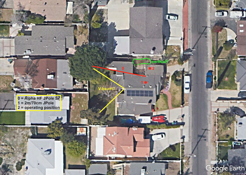

N3WTK
  • Posts: 84
Re: "Good" antenna noisy, "bad" antenna quiet
« Reply #38 on: March 11, 2021, 01:21:00 PM »
... given that you have two trees, you might consider a "V" beam.
That looks interesting, thanks!
I drew on my map where I might put it. The angles look OK but the lengths are not great, only about 40-45 ft to those two trees from the house at that angle. What I read about v-beams is that they should be close to 1 wavelength long. But maybe I could try it. See photo below. Any dipole I put up would probably go where the Alpha Sr is, so it'd be < 20ft from the ground, hence mostly radiate straight up.
Also indicated in that photo is a new thought -- what about a vertical? I know, you're thinking, if you have noise problems then you don't want a vertical! But I don't know what my noise problems are; we kind of found (?) that they're from common mode current, since the CM choke largely knocked them out. Problem is, anywhere to put a vertical is right between my and my neighbor's house (see green area of photo). The two rectangular roof areas, one where my shack is (the #2) and the other under where the "0" label is, could be potential spots if I could place a vertical on the roof somehow.

K0IZ
  • Posts: 1176
« Reply #39 on: March 11, 2021, 04:29:16 PM »
Over the years I have had better luck with balanced antennas than either end fed or verticals.  Looking at your layout, if you could manage 45 ft legs, I would be inclined to install a G5RV and let the 6ft (102ft total) on each end dangle down.  Certainly a compromise.  Also feedpoint is some distance from your #2 location but possibly could be spanned by the window feedline of the G5RV.
Most V antennas are multiple wavelengths and give high gain and sharp directivity.  Yours won't have any gain but directivity will also be fairly broad, which I suspect in your case is an advantage.
I don't recall if you said what bands you would like to use.  One other possibility to take advantage of your current #2 feed point would be an off-center fed antenna.  Longest side towards tree like your end fed, short length (could be 33% or 20%) somewhere else.  Maybe the opposite house
peak from the V beam location?
Who knows, you might wind up with a real antenna farm!
