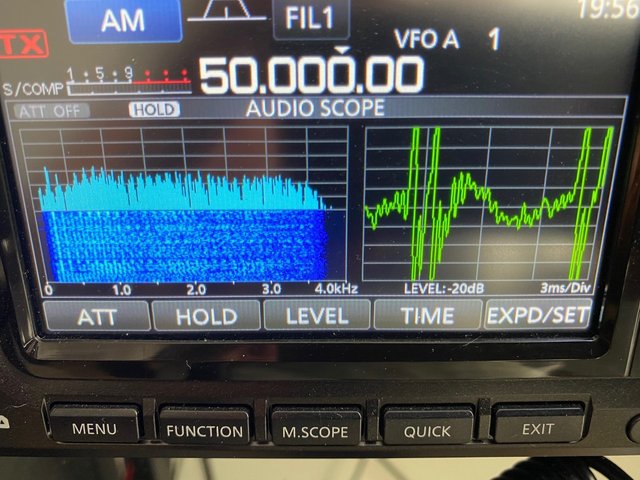

Here is a picture of the most common power line interference signature in a typical QTH environment (single phase 12+ KV distribution).  It is a typical example of an arc-fault.  This is an image from my SUV's IC-7300.  The most important attribute is the inter-pulse time - it should measure 8.3 mS (since the IC-7300 cannot sync to waveforms, you'll need to press the hold button to stop the sweep)
The 8.3 mS is determined as: 1 / (60hz x 2) = 8.3 mS (remember that one sinusoidal cycle has two peaks so you'll see two noise spikes per cycle)
As you can see, attempting to assess the RFI signature using the frequency domain on the left isn't very useful.

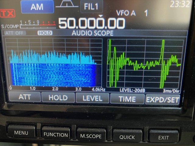

The following is a capture of arc-faults on a 3-phase distribution line.  The key attribute is, again, the ~8mS inter-pulse streaming time - that give-away points to arc-faults.  Most likely, the source are power lines if it can be detected at a far distance from the source.  But an arc-fault at a residence can result in a similar signatures but will, most likely, be weak at a distance.

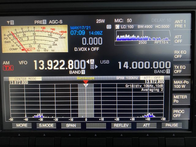

Here's a frequency spectrum view of  a typical switch-mode power supply (SMPS).  Note that the spacing of the harmonic emissions are about 75 KHz (+/-) (notice the noise bursts at  -30 & +40 KHz in the picture).  This is a picture of a nearby SMPS interference that occasionally pops-up at my QTH - the picture is from a TS-890S but would be the same on similarly equipped radios.

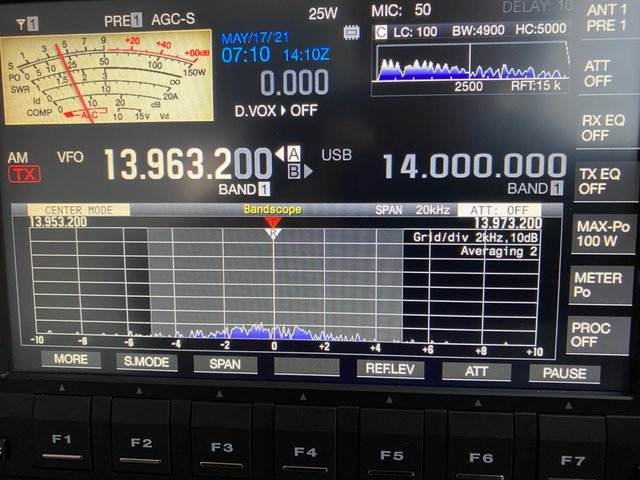

Here is a close-up of one of the harmonic emissions.  Note that it is a spread spectrum emission.  This is due to the commonly used SMPS frequency dithering.  There are also fixed frequency SMPS's, but the dithering mode is more prevalent in supplies that will, more likely, cause you problems.

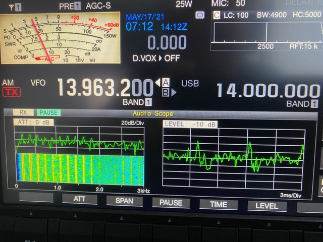

Here is a view of the frequency and time domains of the SMPS.  Notice the distinctly spaced RF  emissions on the left spectrum view.  It shows the frequency hopping.  As a contrast to arc-faults, the time domain view on the right provides less useful information.
The main reason for posting this information is that, many times, one will look at a frequency spectral display and can not decipher the information.  But, also assessing the time domain information of the RFI, as well, may be the key to unlocking what the prime suspect is.
