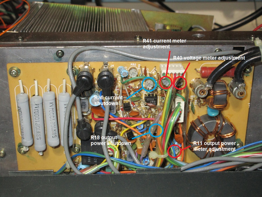

Last night I calibrated the front panel meter for voltage, current, and Po. Except for the PA1 and PA2 bias adjustments, nearly all the 2KL remaining adjustments are located on the main board in the photo below. It took some time to identify them because some are almost buried under cables. Circled in red are adjustments to calibrate the front panel meter. Circled in blue are adjustments that affect the trigger points for shutting down the amplifier. The shut down circuit also triggers on SWR and input power but those trigger points are not adjustable. The meter adjustments are completely independent from the shut down adjustments which will deserve further explanation. R44 visible at the top center of the board is part of the shut down circuit.

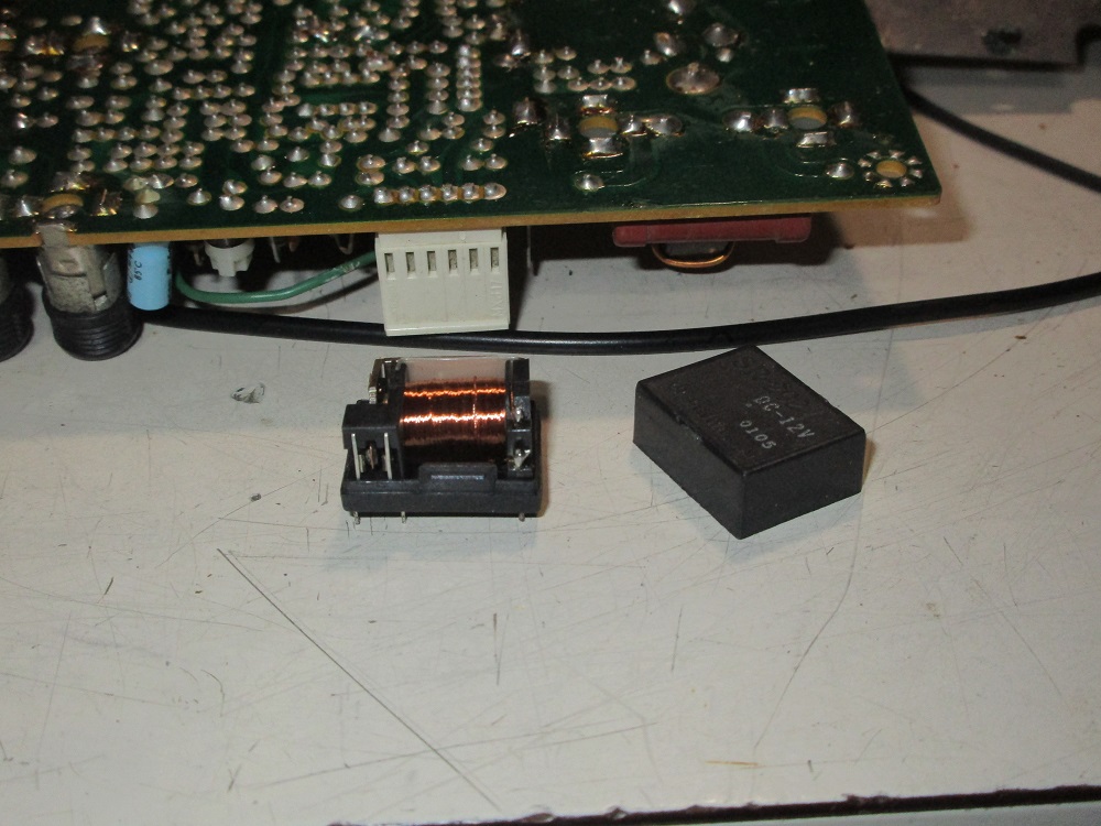

The SPDT relay just under the "R18" sends the input to the amplifier or to another SPDT relay in the LPF assembly to bypass the amplifier. It was the only relay I had to unsolder to clean the contacts because it was too surrounded by parts and cables to pry the top off.

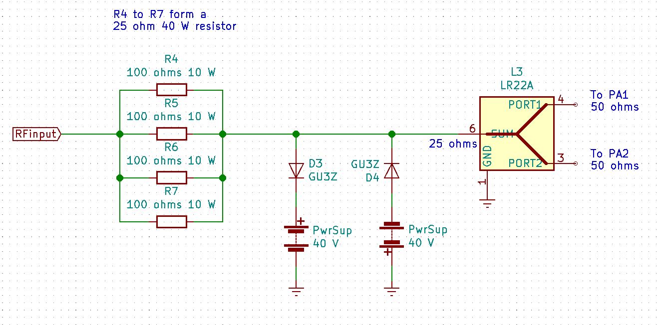

One reason I was concerned about the power supply voltage is that it sets limiting level for the input power protection circuit. A simplified schematic is shown below.
The input impedance is set by four non-inductive 100 ohm, 10 watt resistors in parallel forming a 25 ohm 40 watt resistor which feeds the input RF into a two way, 3 dB power divider with an input impedance also equal to 25 ohms. Two clamp diodes, D3 and D4, are 1 A. GU3Z diodes reverse biased by the power supply voltage of 40 VDC. These diodes have no effect until the input power reaches a certain level .
Let’s calculate that power level. Assume that the diodes forward voltage drop will be about 1 volt, then they will turn on when the peak RF reaches about 41 volts. The Vrms for a 41 Vp signal is 41 * .707 = 29 Vrms. Power = ( Vrms **2 )/25 = 33.64 watts at the input to the power splitter. Since the half the power is dropped by the 25 ohm input resistance, then the applied RF power at the amplifier input is 2 * 33.64 watts or about 67.28 watts.
This fits well with Icom’s description on page 11 of the instruction manual where it says protection goes into effect when “3. The driving power from the exciter goes up to more than 70 watts.”

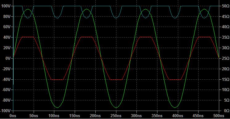

The circuit behavior becomes more complex with the onset of clipping. To show that behavior, a time domain Spice model using an ideal diode model was created with the following results. The source is set to be a 50 ohm source with open circuit voltage of 200 volts peak. This source terminated in 50 ohms would deliver about 100 watts to the load.
The green trace is the RF input voltage at the input to the amplifier. The red trace is the clipped output to the power divider. The blue trace is the dynamic input resistance of the network which uses the vertical scale on the right side.
