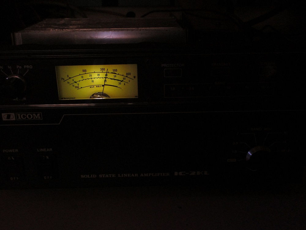

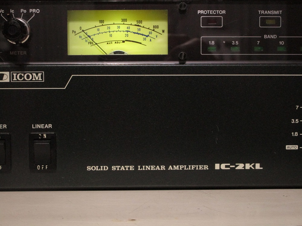

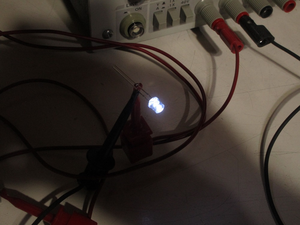

The grain of wheat light bulb behind the meter burned out. It was replaced with a white LED soldered with clear heatshrink tubing shown below and a 1.8 k resistor to drop the 13.8 VDC with about 6.7 mA current.
The color looks like this which compared to photos of the 2KL is changed from a warm light orange to slightly green.

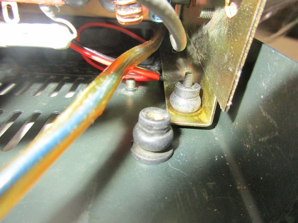

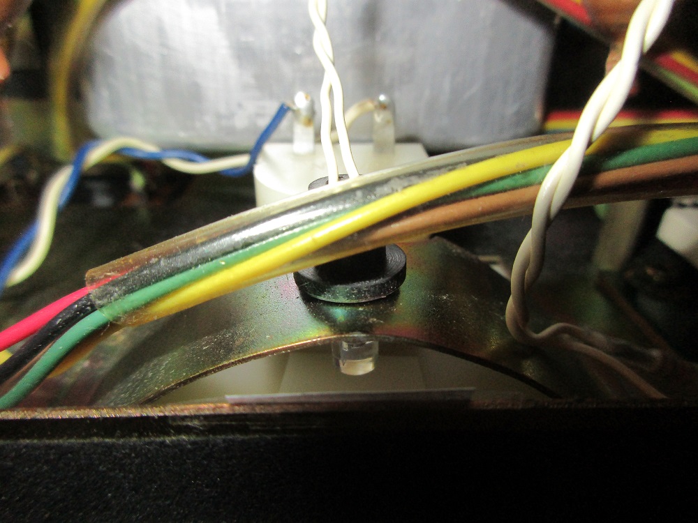

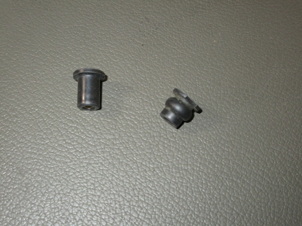

This is a photo of the anti-vibration mounts more commonly known as Wells or expansion nuts. In the photo, the last remaining of the old mounts is shown on the left.
What made it confusing while looking for these mounts is that they look quite different when new as shown here with the new part on the left.

If you would like a more even lighting of the meter face, take a look at the single LED light pipes used for LCD backlighting. I have found that they conveniently fit nicely along the top edge of the meter housing and provide a nicely diffused light.
I am surprised they consider the blind buts to be anti-vibration. Do they really fulfill that purpose? It would seem more likely that they are used to avoid press fit nuts (or tapping if sufficiently thick) in the interior sheetmetal pieces.

The LED used above is a standard viewing angle device, probably about 60 degrees. Normally I use a 140 degree LED described below but discovered the cupboard bare last night.
Some manufacturers used a piece of paper in front to diffuse the light. This is what a a 1/2″ strip of paper does to the display. You can see the actual color of the LED above the meter.
I will order some more wide angle LED's and a light pipe to try out.
I was not sure why the 2KL needs vibration damping. My guess is that the original fan from 40 years ago might have created more noise and vibration than current fans. I noticed that the 40 cfm computer fan draws more current than the newer 50 cfm that replaced it. I didn’t notice any excessive vibration from either fan before the Wells nuts came in. It did seem to make sense if fan vibration was Icom’s concern, to rigidly mount the fan to the heavy heat sink, heat pipe, amplifier assembly to increase the mass, then damp the entire assembly.

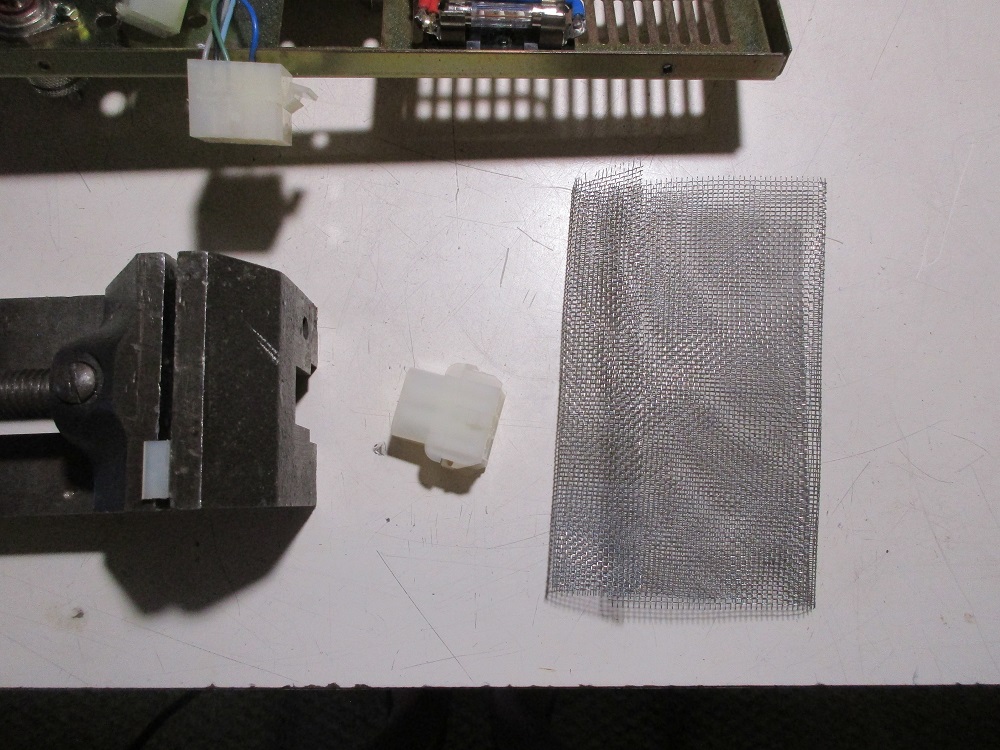

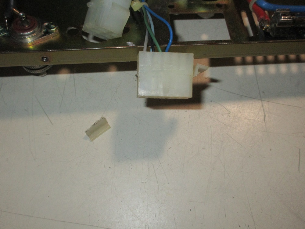

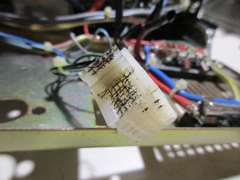

The accessory 24 pin connector was found to have a broken mounting ear. The connector was held in place with clear epoxy all around the perimeter but did not hold. The epoxy came off in large flakes. To repair this required a solution that would allow the ear to flex if the connector were to be remain removable in the normal fashion.
I decided to try a stainless steel mesh from a plastic welding kit and a sacrificial Molex connector to supply additional plastic if needed to cover the mesh. The mesh is embedded in the existing plastic with a hot soldering iron tip including the joint so the stainless steel provides all the strength.
To make it more difficult to pull the mesh out, the mesh was wrapped around the rear of the ear.  Covering the mesh with more plastic did not turn out well. The additional plastic tended to burn black easily.
Not very pretty but seems strong enough. Here it has been reinstalled in the recessed mounting bracket.

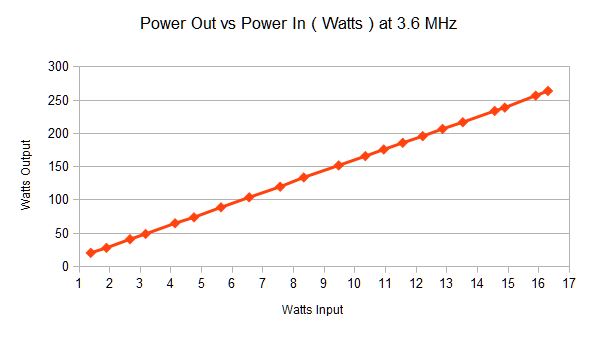

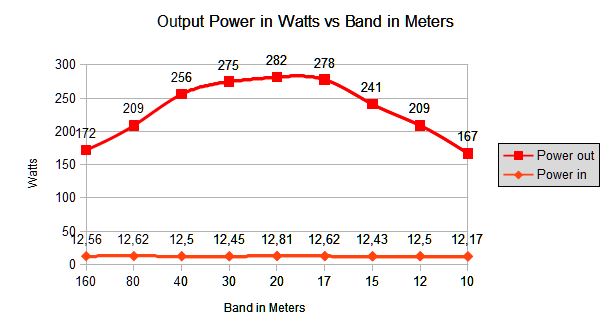

I replaced the HP6291A with an HP6274B lab supply which can supply +40 VDC at 18 A. With this change, a quick test across all bands with the Icom IC-7100 set for about 12 watts output gave this result. The gain variation is about 2 dB. No ALC was used.
This is the power output versus power input as the output power of the Icom IC-7100 is varied from about 1.38 to 16.30 watts out.
A +40 VDC, 30 A. switching power supply is on order. It may arrive next week.

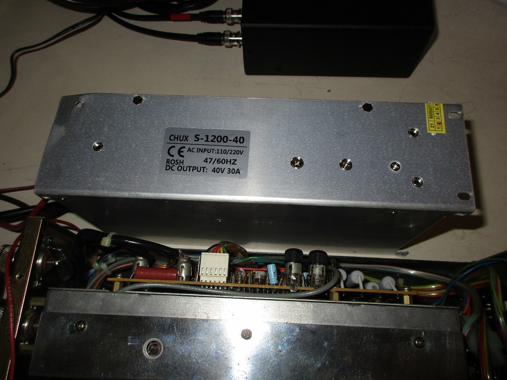

The 40 VDC, 30 A switching power supply was delivered. It was tested no load at +40.16 VDC. It was hard wired to the 2KL since the rear panel power connector has not come in yet. With the switching power supply I was able to get 500 watts output on all bands at about 22.5 A.
One concern about the power supply fell by the wayside. The Icom IC-2KLPS has two relays to sequentially turn on so the inrush current is limited. With this switcher plugged into an outlet strip with the Icom IC-7100, it’s power supply, and a power meter, turn on did not result in the circuit breaker tripping. This 1.2 kW power supply was $76 from Aliexpress. Total was $102 with freight and tax.
It did suffer some damage in shipment. Notice the bend in the upper left.
The voltage from the power supply was measured at not transmitting load ( +40.09 VDC ) to full load at 22.5 A ( +40.02 VDC ). Below the efficiency of the 2KL is plotted up to about 500 watts output against the efficiency of theoretical class A and B amplifiers. Increasing bias current pushes the operation down from the green class B line towards the blue class A line.

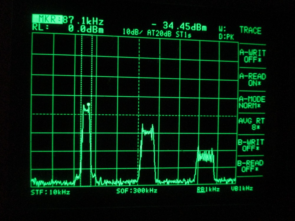

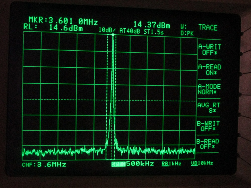

It is occasionally suggested that only switching power supplies made for amateur use are sufficiently free of spurious products. The following  tests where done on this power supply to see if it has adequate spurious suppression. The output is about 900 watts DC to the 2KL for 500 watts RF output at 3.6 MHz in the following measurements.
The first test was to find the switching frequency in the time domain. A x100 scope probe with the ground connection shorted to the input was used as a pickup for a digital scope which resulted in the display below showing a frequency at about 83 kHz. The scope capture does not show that the frequency fluctuates quite bit.
To show the dispersion in the frequency, a spectrum analyzer was used with a x1 scope probe with the ground connection terminating the input again as a probe. The result below shows what looks like an FM spectrum at about 85 kHz with harmonic spectrums at twice and three times the fundamental.
Next the 500 watt output of the 2KL was measured at 3.6 MHz via about a 32 dB coupler plus an additional 10 dB, 2 watt pad in front of the spectrum analyzer.
The first scan was in a 500 kHz span which should show a the 1st, 2nd, and 3rd harmonics of the switching frequency but nothing was visible at over 70 dB below the carrier.
The span was then narrowed to 200 kHz in which any fundamental of the switching frequency at about +/- 85 kHz should be visible but again nothing was found at over 70 dB below the carrier.

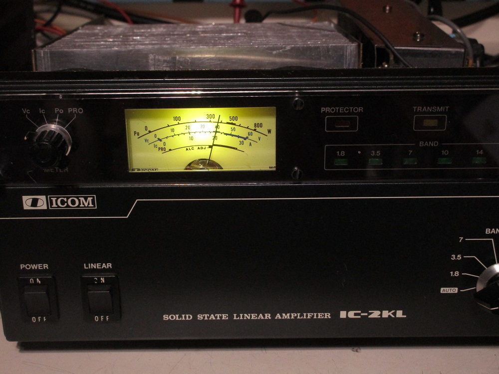

The new wide angle LED’s came in yesterday.
This is what the meter looks like now with the wide angle LED and about a 5/8” wide strip of paper vertically in front of the LED.
Parts that have not yet come in are the rear panel mating power connector and the LCD light pipe. I also need to see if the switching power supply has enough room in it for a relay so the 2KL front panel Power ON/OFF switch can control it like with the 2KLPS.
All that from one LED....WOW. I can see them in some of my boatanchor receivers where replacing the 47's, etc can be a PITA and reducing voltage doesnt look good.

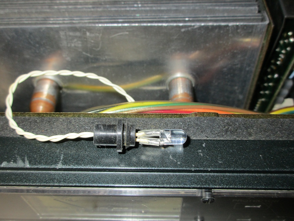

Yes, just the one LED. This photo shows the back side of the meter with the strip of paper providing attenuation directly in front of the LED due to the LED holder being so close to the center of the meter. The paper is held in place with a strip of clear cellophane tape over the copper color metal that the paper is resting on.
The only difference between the meter photo in reply #33 and reply #42 is the change in LED. The LED current is about 6 mA in both cases.
