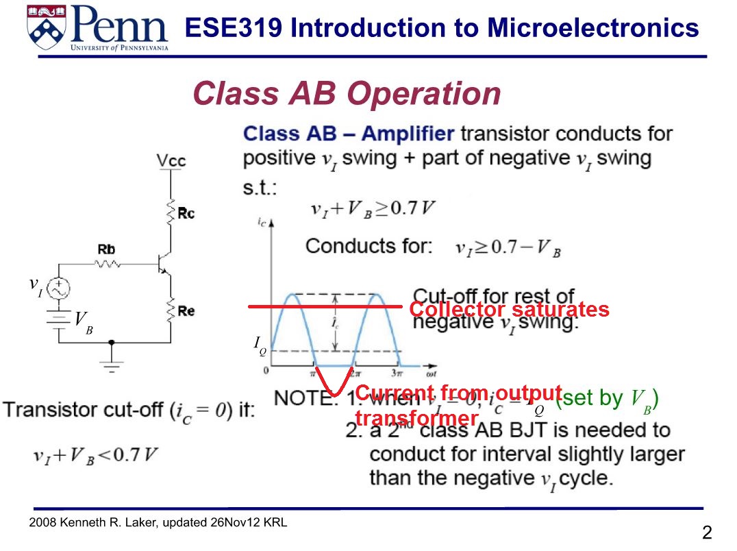

This is a look at how the 2KL works in the time domain. It departs from the classic behavior of class AB. The classic AB amplifier behaves as shown in this University of Pennsylvania article.
https://www.seas.upenn.edu/~ese319/Lecture_Notes/Lec_22_ClassAB_Amplifier_12.pdf

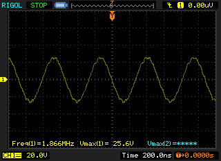

Below is the input to the input transformer of PA1 with the 2KL set for 500 watts output on 160 M. There is some ripple but as we shall see, that ripple is likely created by the very non-linear junction behavior of the power transistors.

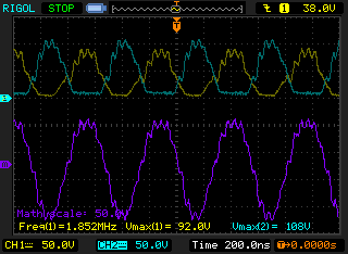

This is what is found at the transformer outputs. There is obvious clipping as the base emitter junctions of the power transistors clamp the input. The purple trace uses the math function of the oscilloscope to do A-B of both channels with the sum bearing a strong resemblance to the input signal.
This is the output measured on both collectors of each device on PA1. Notice that both device’s collectors are driven into hard saturation long before 500 watts output is reached.

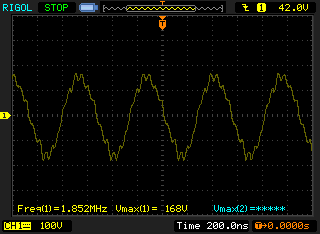

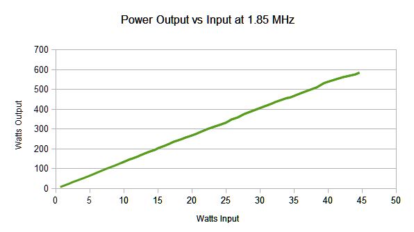

« Reply #78 on: January 12, 2022, 12:50:52 PM »
This is the output of PA1. Since the peak of 168 volts occurs where there are two harmonic peaks, if we estimate the real value is slightly lower at 160 volts, the power out would be about 256 watts or 512 watts for both PA1 and PA2 which is about right since the signal still has to pass through a combiner and then the low pass filter.
Plotted input vs output power at 1.85 MHz. In spite of all the non-linearity at the base emitters and collectors, the output power versus input power curve is pretty straight.
The curve starts to bend down around 530 watts output. The output power trip point to shut down the amplifier was set at 600 watts output which did happen.
This is the combined output of PA1 and PA2 at the output of the 2KL.
224 Vp into 50 ohms is P = [( 224/1.414 ) **2]/50 = 502 watts

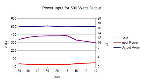

The power needed to produce 500 watts was measured and the gain calculated as shown below.

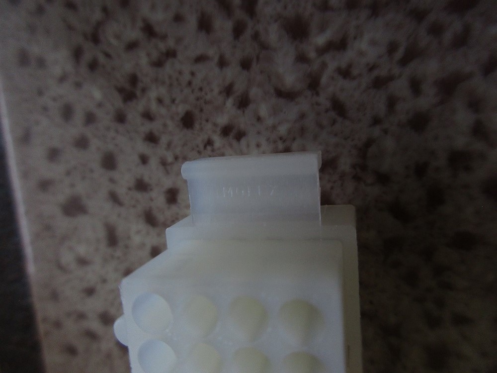

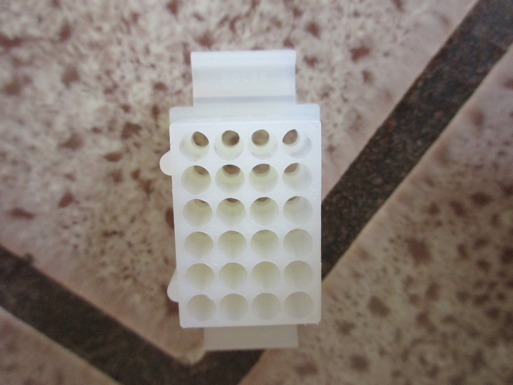

The 2KL uses a rear panel 24 pin ACC connector for control via Icom transceivers. The Molex part number for the rear panel connector is 03061241. The mating connector is 03062242. Both parts have been discontinued by Molex for some time. W2ENY sold these or a 3D printed version but no longer. Recently this ad showed up on eBay.
https://www.ebay.com/itm/163170686633?hash=item25fdbb16a9:g:wbUAAOSwgcdcGmqH
I had some concerns these were not Molex parts but might be 3D printed versions as well given the name of the vendor is “partsmakr8585”. The parts I ordered showed up this week. They appear to be genuine Molex parts but not p/n 03062242 which is shown in the ad. Instead the part is 03062241 which adds the snap in panel mounting ears. The mounting ears do not cause any interference when connecting to the 2KL or the tuner, the AT-500, so I did not remove them.
The Molex name can be seen in the mounting tab. The number 1625 for the series  also appears on the opposite mounting tab.

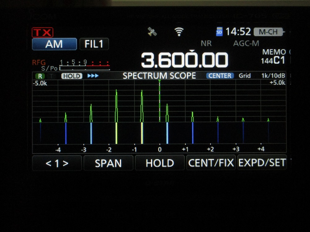

This is the IMD at 500 watts output at 3.6 MHz measured as described in this thread,
https://www.eham.net/community/smf/index.php/topic,136968.msg1271256.html#msg1271256

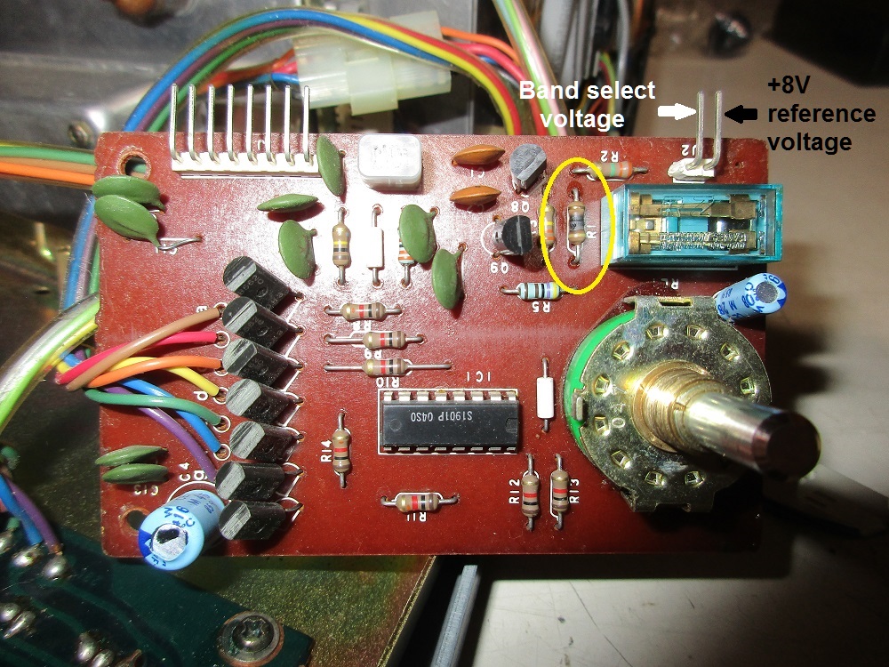

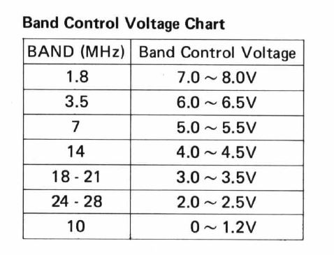

The transceiver sends two voltages to the 2KL auto band select circuit via the 24 pin connector. One is a +8 VDC reference voltage which goes in pin 12. The band control voltage goes in pin 13. The actual band control voltages are shown below for reference.

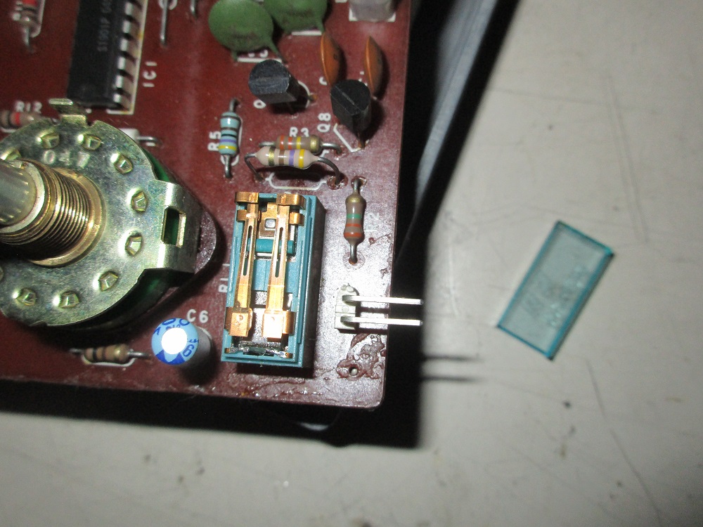

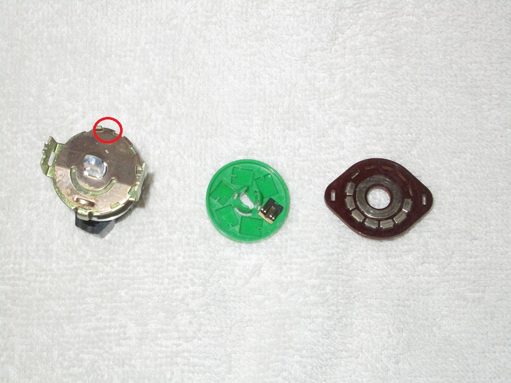

The auto band select stopped working recently. The band select board was removed. Resistor R1, 470 ohms was found burnt but the value was correct.
The relay RL1 connects the +8V reference and band select voltage to the rest of the circuit. The top of the relay case pops off easily for cleaning.
After replacing R1 and cleaning RL1, the problem remained. The clue to the problem was that RL1 never switched at any time which led to the front panel rotary band select switch S1 which was the source of the problem. S1 is supposed to ground the relay coil in the “Auto” mode but the measured resistance to ground for S1 was around 17 kohms.
Spray cleaning S1 did not help so it was disassembled. There was a film formed over most of the contacts. The upper half of the brown wafer in the photo below still shows the brown residue.
With S1 apart, it looks like if the flute circled in red were removed and a new contact added to the wafer, S1 could select 10M from the front panel.

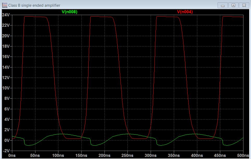

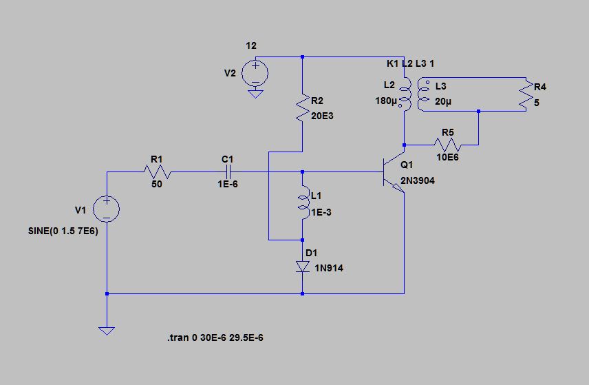

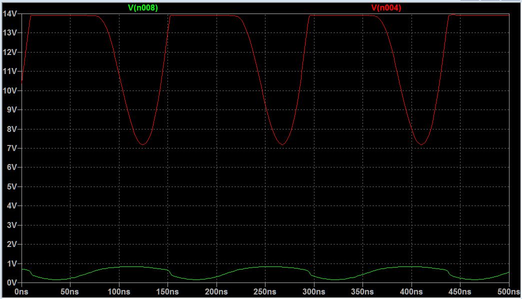

To understand better why these class AB amplifiers stay linear even when the output is saturated, I created a simple Spice model for a single ended class B amplifier.
The images below show Vbe in green and Vce in red.
At low drive,
Near saturation,
In saturation,
The output voltage continues to increase even when the voltage is clamped going low by saturation.
