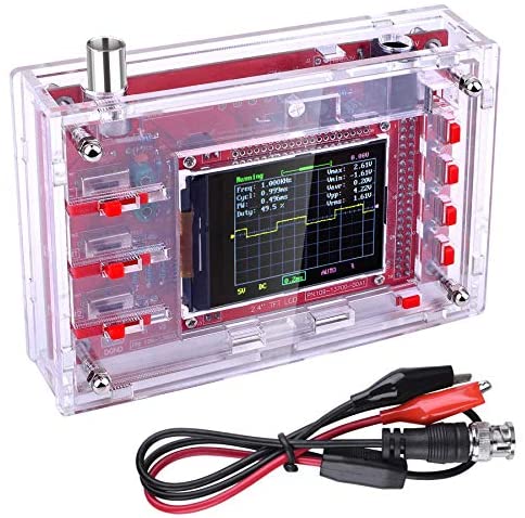

cute little digital scopes for under 50 bucks can show ac or dc volts.'
so you have it all. just watch the trace as you would a needle.
i got one for 25$

There are a lot of them out there, Charlie. Take a look at this simple kit for $30:
https://www.amazon.com/dp/B07QT81M92/ref=cm_sw_r_cp_awdb_imm_AGMFNA70N7PQXG6M99ZE
It does need a 9 volt supply.
Then scroll down to the "Compare to Similar Items" section to see more choices.

Thanks, Glenn, it'll be delivered Tuesday. I just hope I'm around long enough to learn how to use it. LOL

They are lots of fun packed into a small form. I am sure you will enjoy it.

a cheap little pocket scope like glen  showed here is a much better way of measuring and peaking, 10 meg input

I saw 1 meg input on ones similar to the one Glen listed (which I couldn't find a spec on).

10 meg with probe.
should always use 10 to 1 probe
