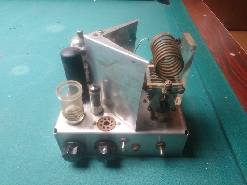

Kind of intrigued by it. I think I gave a fiver, I just couldn't let it be an orphan and figured it'd be a cool wall hanger if worse came to worse. The tube compliment is:
-6AQ5
-6L6
-807
-4-65A
There's a built in filament transformer and the center tap that would normally be grounded seems to be connected to a phono jack like it was meant to key the tube. Not really sure what's up there. It seems like a lot of stages for just a basic osc/power tube transmitter in CW. Definitely interested in what people have to say on it.

It is a transmitter with plug in coils for the frequency.

To me it looks like a homebrew crystal controlled transmitter with what could be a link coupling to the antenna.
Does the piece of Plexiglas on the right move and does it have or provisions (holes) to mount a coil of 2 to 5 turns?

It's an interesting home brew.  Some good parts in there in case you want to turn it into something more useful.
Hard to imagine it takes an 807 just to drive a 4-65 pentode...unless that's an audio tube to modulate the screen grid?

i vote for "crystal controlled transmitter" as well.
Looks like a transmitter I built when i was 11, except i used an old radio chassis and octal tubes for the build.
A mentor looked at the effort and asked if the free form tank coil was "foot warmer" . I was crushed...

I suppose you could plug a xtal into two pins of the octal socket.  OTOH, I wouldn't design a xtal oscillator using a 6AQ5 unless you could find a way to reduce power dissipation in the xtal.
The next job is to reverse-engineer the circuit and publish the schematic diagram.  Until then, we are just guessing.

Seems to be a 6AQ5/6L6/807 lineup which could be used from 160 to 10M with WW2 surplus FT-243 crystals which fit the empty socket.
Run the 807 as a doubler and no neutralization needed on the higher bands, that shield helps.
Hook up an external modulator for AM.

AXW: It looks like a 2 turn ling is incorporated on the far right of the coil.
I could be wrong, though. It may just be a bit of a gap in the turns. And BSU has a good suggestion about the schematic.

No, not scrapped. I bought it as a wall hanger in all probability. The doublers are a genius idea though, I didn't think of that. When I get it out of storage I'll try to get something going on reverse engineering it.
