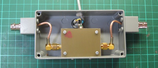

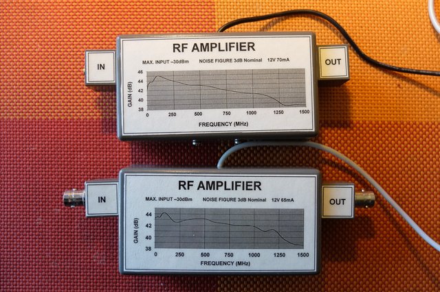

I built this pair from kits supplied by MiniKits in VK;
The PCB is designed to take two MMICs (I used GALI-39s) but Mark at MiniKits said that no-one had been brave-enough to use two!
It took some shielding to stabilise the +40dB of gain;

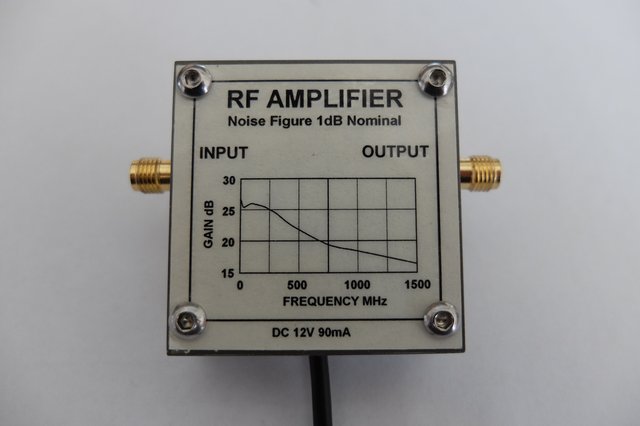

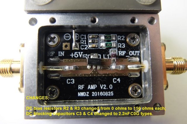

I also wanted about 20dB of low-noise gain so I bought two ready-built amplifiers from ebay;
I modified them with better blocking capacitors and suitable bias resistors for 12v operation;
and added a panel and a cover for the DC connection;
This might give you some ideas.
Note that these amplifiers are used on the test bench; the gain is very high and I would be reluctant to connect either to an antenna & a receiver.
