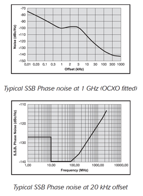

I had a rummage and managed to find the phase noise plot of the 2024 at 1GHz. It seems to agree very well with the plot you posted up Peter.
This 2024 only has the standard oscillator and not the OCXO option so that probably explains the higher phase noise below about 100Hz. The pesky blip at 1.5kHz is still there. I do have some plots somewhere of a healthy 2024 and the blip is gone.
The R&S  SMKL-01 looks to be a very good signal generator. I saw a phase noise plot in a glossy brochure at about 9MHz at it was impressive.

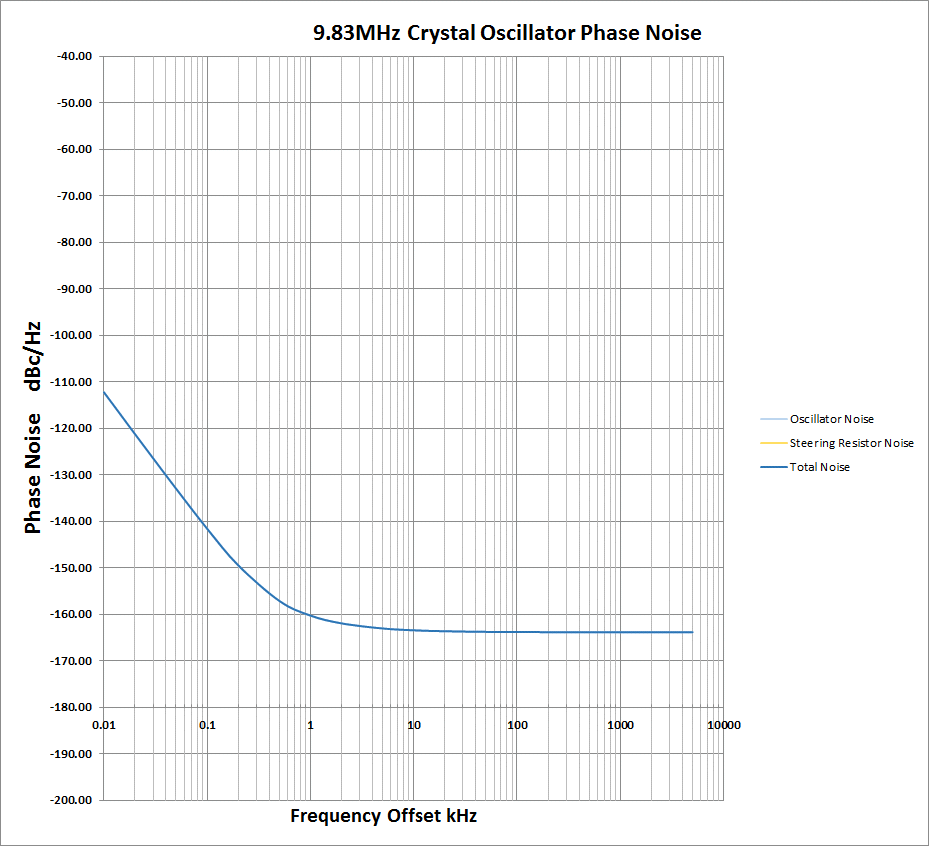

One other option for the LO is to make a decent free running LC oscillator. This would be at its best foruse below 30MHz and would provide low phase nosie at offsets in the 10kHz to 100kHz range. It should outclass the sig gens in this range and should be better than a typical crystal oscillator at these offsets. It won't be as good at offsets below about 5kHz but it should perform much better than a basic crystal oscillator or a sig gen at a 100kHz offset.
The phase noise simulation below is based on Leeson's equation for a basic LC oscillator with low flicker corner frequency and a loaded Q of 42 and about 5mW resonator power at 10.7MHz. The phase noise beyond 10kHz offset is going to be a lot better than any lab sig gen I've used. The downside will be that it will be prone to warmup drift and also to interference pickup. It would ideally need to be in a screened box.
I'm not sure about using this technique for the LO beyond the HF bands though. It may become a bit too drifty.

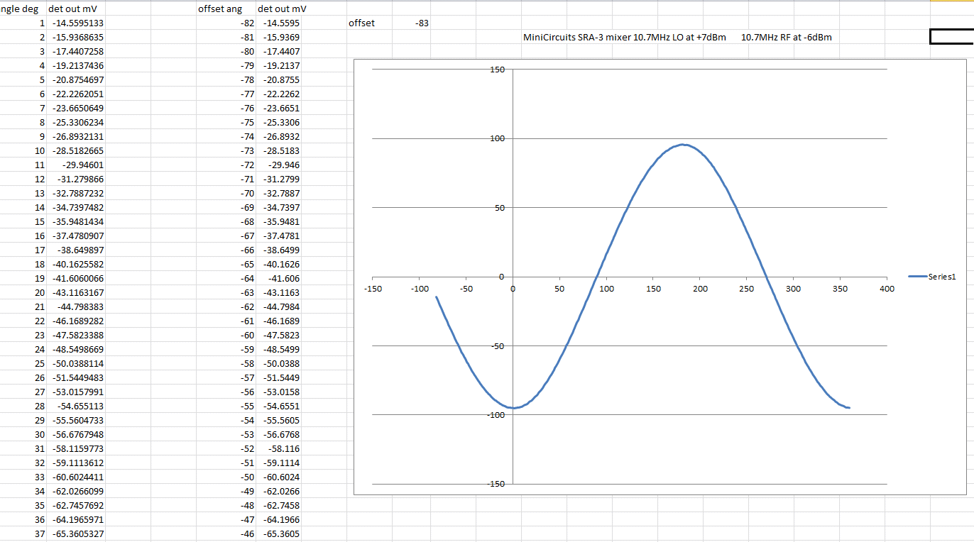

I tried measuring the phase response of the SRA-3 mixer over >360degrees and got the plot below. This was at 10.7MHz with a 7dBm LO and -6dBm RF drive after a LPF and 10dB attenuator.  i.e. RF sig gen>>+4dBm>> LPF >> 10dB_ATTN >> -6dBm to mixer RF port.
I took a phase detector output measurement for every degree step in phase. All ports were quite well terminated for this test and RF harmonics into the mixer would have been lower than -80dBc.
I did this using a VB program to control a couple of sig gens, the SRA3 mixer and a bench DMM. The sig gens have programmable phase when locked to the same reference so the data should be quite good.
It looks like it outputs up to +/- 95mV across all phase angles

« Reply #26 on: October 12, 2021, 05:57:46 AM »
That's an encouraging plot, Jeremy.  With decent isolation and optimum drive levels you're seeing good performance with just about minimum dc offset.  I hadn't seen the WJ Tech Note but, based on what was available on eBay at the time and some general principles, I chose a WJ M1 DBM for my test system.
