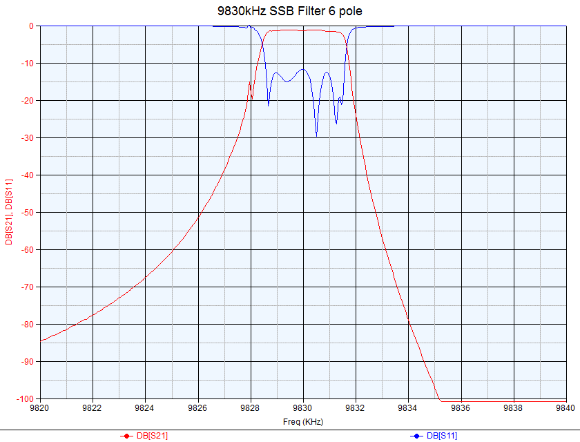

I couldn't resist trying to design an SSB filter with these crystals and see below for a 6 pole filter simulation using the s-parameter data.
This is only a 6 pole filter. There is a strange blip in the lower stopband, this might be an issue with the interpolation between points or it might be a real artefact of the crystal.
An 8 pole filter would probably have very good performance. The 6 pole filter is about 3kHz wide and only has a loss of about 1.3dB and has very low passband ripple. This assumes all 6 crystals out of the bag are the same of course...
Edit:  I just looked on a wider span and this crystal does have some nearby resonance modes that would spoil the performance as an SSB filter. However, I think it could still be used as a filter in a phase noise measuring system.

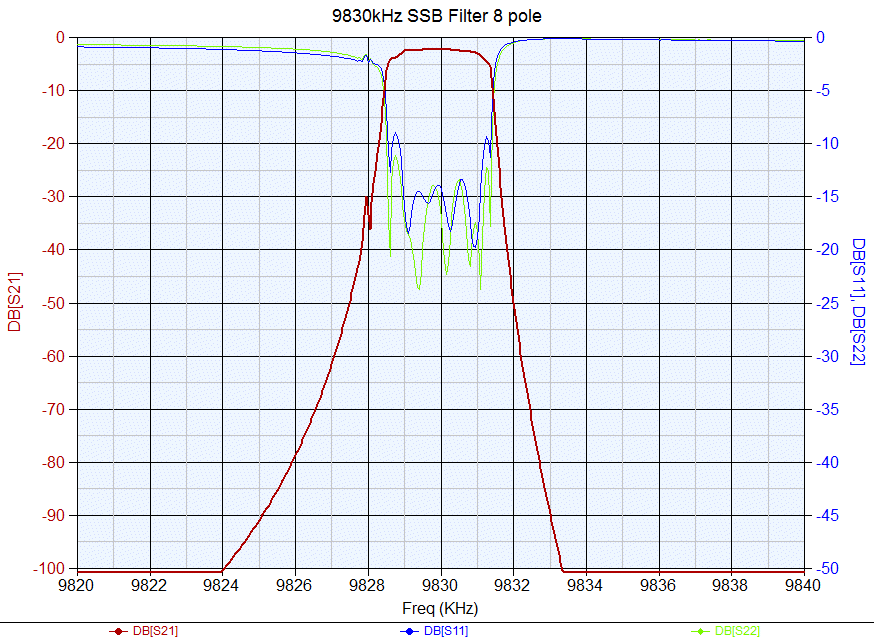

Thanks! I had another play on the simulator this evening and designed an 8 pole version and I've done it with standard (fixed) cap values. It looks very promising.
See the simulation below. I also think the spurious terms seen on the VNA aren't going to be as big an issue as I thought. I would hope to be able to get 100dB stopbands on a real filter if well grounded and shielded etc. Hopefully the stopbands will extend out at least +/- 1MHz but I won't know until I build it. I have done this stuff before so I think the results should be quite good.
This design went together quite easily this evening. However, I think I need to take another set of s-parameters from the crystal because I need finer resolution to really get the passband as flat as possible with decent group delay. It already looks very good but I think it's worth refining it as there isn't anything to tweak as it all uses fixed caps. So it is a case of build it and hope it is the same as the simulation. It should be but the capacitors need to be good quality with tight tolerances.
I haven't really thought which HF bands this crystal filter would suit but a pack of ten crystals would be enough for the SSB filter and the product detector.

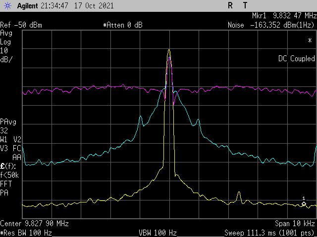

I've now added another crystal section to the notch filter to get a notch depth of nearly 65dB. The notch filter now has 6 crystals.
Here's three phase noise plots using the notch filter at 9.828MHz. The top trace (pink) is the phase noise of an Agilent E4433B vector sig gen. This has really poor phase noise on the HF bands as you can see in the plot below. It's approx -103dBc/Hz across the whole 10kHz span.
The cyan trace is the phase noise of one of my Marconi 2019 sig gens. This sig gen has quite low phase noise and shows about -141dBc/Hz at an offset of 4.5kHz.
The yellow trace at the bottom is the MMIC/crystal oscillator and this shows -163dBc/Hz at 4.5kHz offset. This oscillator doesn't quite sit in the -65dBc null of the notch filter but it is low enough to not upset the spectrum analyser.
This crystal oscillator has 60dB lower phase noise (at 4.5kHz offset) compared to the E4433B sig gen!
