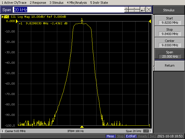

I had a go at making the SSB crystal filter on a spare scrap of PCB but the results aren't as good as I'd hoped. I couldn't find 8 matched crystals amongst the remaining ones I had left. There is nothing to adjust in the design so it is a case of build and hope.
You can see there is a slight droop on the high side of the passband and this must be to do with the spread amongst the crystals. Otherwise it was very close to the simulation. It is very risky to design the filter like this. What I should have done was match the crystals first and then taken s-parameters of the one in the middle of the spread of matched crystals. Then designed it on the simulator.
I'm going to buy another 20 crystals and try again at a later date.

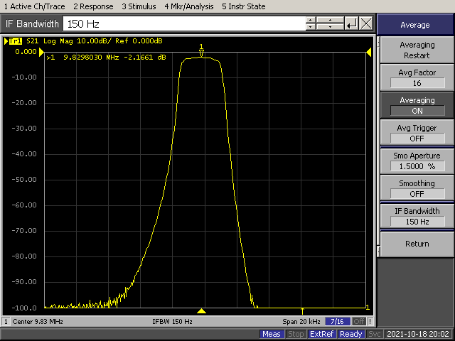

« Reply #48 on: October 18, 2021, 02:16:00 PM »
I found that padding a couple of the large caps by +5% improved it a lot so some of the droop may be down to component tolerances. It is really close to the simulation now. This design deserves a bit more time spent on circuit optimisation to make it repeatable.

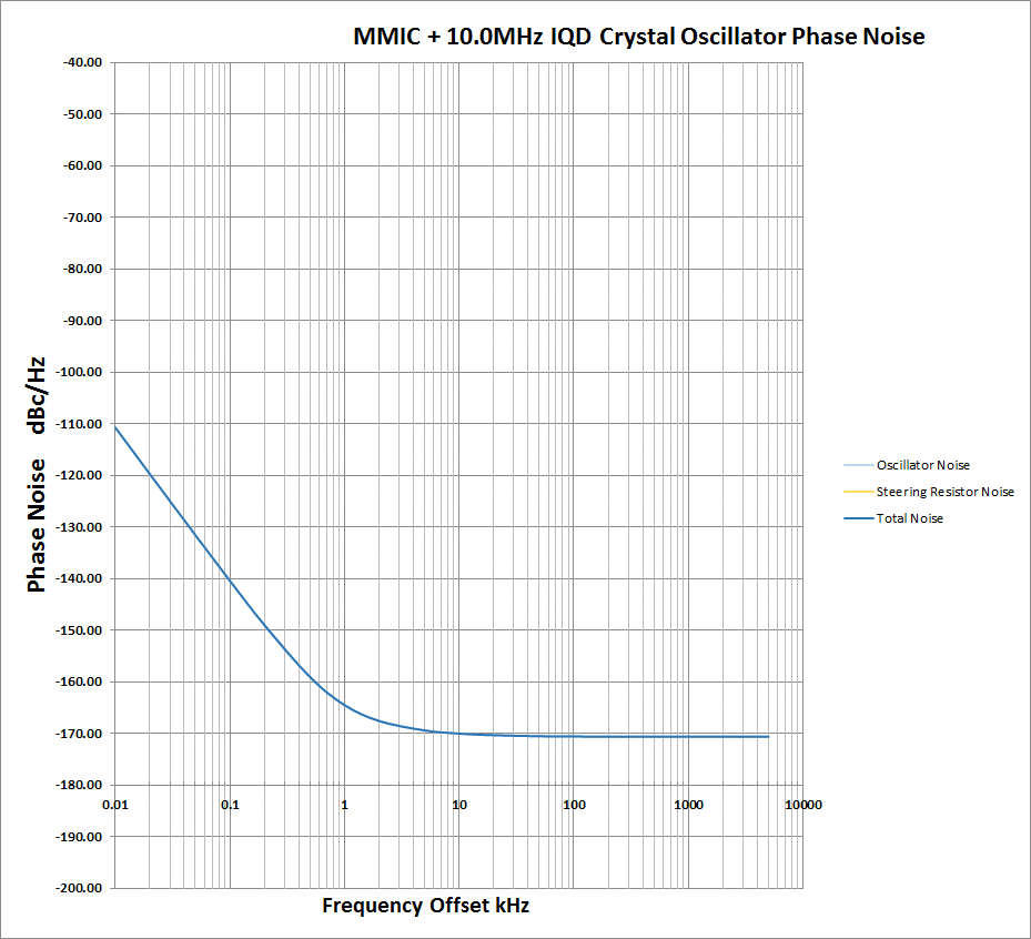

« Reply #50 on: October 20, 2021, 10:50:34 AM »
I had access to the E5052A signal source analyser today so I swapped the 9.83MHz crystal for a nice IQD 10MHz crystal in my 50R MMIC based 'Leeson Trainer' circuit. This crystal has low ESR but the loaded Q is only 6200 in the MMIC feedback circuit.
However, I ran it at a higher resonator drive power of about 2.8dBm into the crystal by setting the loop attenuation to 5dB. Leeson's equation predicted the phase noise plot below and the real measurement is also given below. This shows 7.8dBm Pout but this is after the MMIC and the equal power splitter. There is 5dB loss in the attenuator so the resonator input power is 2.8dBm. There's about 1dB loss in the crystal. The MMIC has a noise figure of about 5.5dB here and there will be some compression effects to factor in as well. I've factored all this into the Leeson plot below.
I think the phase noise is probably too low for the E5052A to measure at 1kHz offset. I used a correlation of 10 to get the plot below. This is probably the limit of the E5052A. However, the rest of the plot was in quite close agreement and I put in a flicker corner of 1500Hz. I do feel it is possible to design low phase noise crystal oscillators cheaply using a basic MMIC circuit although I am probably driving the crystal quite hard here. I did try increasing the attenuation but there is only 3.5dB gain margin in the loop at 5dB attenuation. So it stopped oscillating with 8dB attenuation in the loop.
Getting close to -170dBc/Hz at 50kHz offset is quite good I think. I'm a bit more confident about designing test oscillators like this. I think the crystal ageing will be poor at this high drive level but that doesn't really matter in this case.
It should be possible to make a suite of these oscillators at various frequencies to either use as a low noise LO or as a gold reference for that frequency. This would complement any homebrew phase noise measuring system I think.
Sadly, I had to do this at my workbench and there is a lot of local interference from nearby equipment where I work. So there are a few spurious terms visible on the plot. The spurious term at 60kHz always seems to be there and it may be an internal spurious in the E5052A. There is another E5052A I could try at a later date.

That's a good result, Jeremy.  It certainly looks as though a similar oscillator would be a decent bench standard, and would be ideal for characterizing the phase noise behaviour of e.g. the majority of common 10 MHz frequency standards.  It'd be interesting to see how repeatable the characteristic is but, on the other hand, just having something respectable that can be measured initially on a lab instrument would on its own be very useful.  It's of order 10 dB better in close-in noise relative to the Crystek and Golledge units we were discussing, although to be fair I guess we should take a few dB of those units' plots to account for a division to 10 MHz.

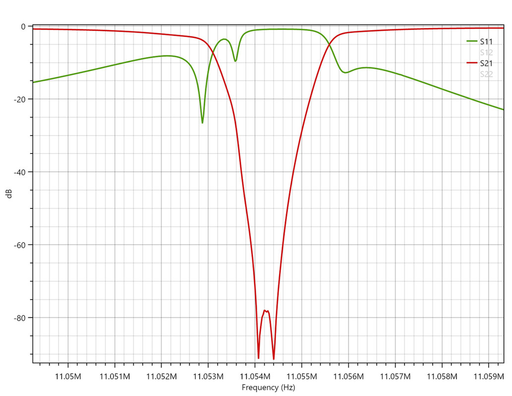

The supply chain problems that everyone talks about have definitely hit my Digikey crystal delivery but I managed to get hold of five 11.06 MHz crystals from RS Components in Australia (stock 672-0208).  These looked quite good on the VNA, with fairly low ESR and frequency spreads of <800 Hz in their series resonance.  The arithmetic mean resonant frequency of the set was 11.05412 MHz.
I put together a 5-crystal notch filter, along the lines of the Hayward design (50:200 ohm i/o transformation).  My spectrum analyser is with the agent to have its real-time module checked out so I pushed a nanoVNA, nanoVNASaver software and a Touchstone file viewer to produce some decent results, although don't get hung up on absolute transmission values below -70 dB.  The un-tweaked response is shown below:
While there is room for optimization, the raw performance is pretty good in the notch application.  Still, the minimum usable offset is a little less than 2 kHz, limiting the usefulness in some applications while being adequate for many.  One thing the measurements remind us of is the poor return loss around the notch: a short is still a short however one transforms it!  Again though, for many applications it's not a big issue.
Incidentally, the 11.06 MHz crystals look considerably better than some RS 10 MHz ones I ordered at the same time, the 11.06 MHz units having noticeably lower ESR and frequency spread.  It will be interesting to see how the Digikey ones shape up when they arrive.

The notch depth of your filter is very good and fairly wide too. I found that I could optimise the return loss close the notch by adjusting the slugs in the Toko 10k coils on my notch filter.

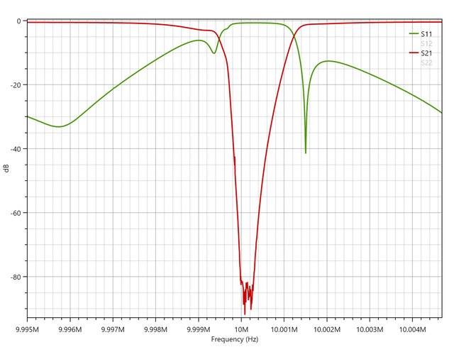

That's a good result!  -150 dBc/Hz at 20 kHz offset, at a carrier of 105 MHz, is very competitive with good commercial systems.  It's also interesting to see the notch filter approach is proving useful in getting phase noise readings consistent with a direct measurement at nearby frequencies.
My 10 MHz series resonant crystals (CTS MP100-E, 30 ppm) arrived and, in an economy of effort, I simply wired the best five in parallel with the previous 11.06 MHz units, with no change to the LC synthetic quarter-wave line.  The mean series resonant frequency was 10.000100 MHz.
The previous 11.06 MHz response was unchanged and no spurious responses were introduced.  Again using the nanoVNA, and with no tweaking, the raw notch characteristic is shown below.
The notch depth is very good and with the nanoVNA frequency within 1 Hz or so of my 10 MHz GPSDO, it's clear that phase noise measurements with offsets greater than about 1.5 kHz would be quite useful. In fact, if I had my spectrum analyser back from the manufacturer I'd check the GPSDO noise right now.
