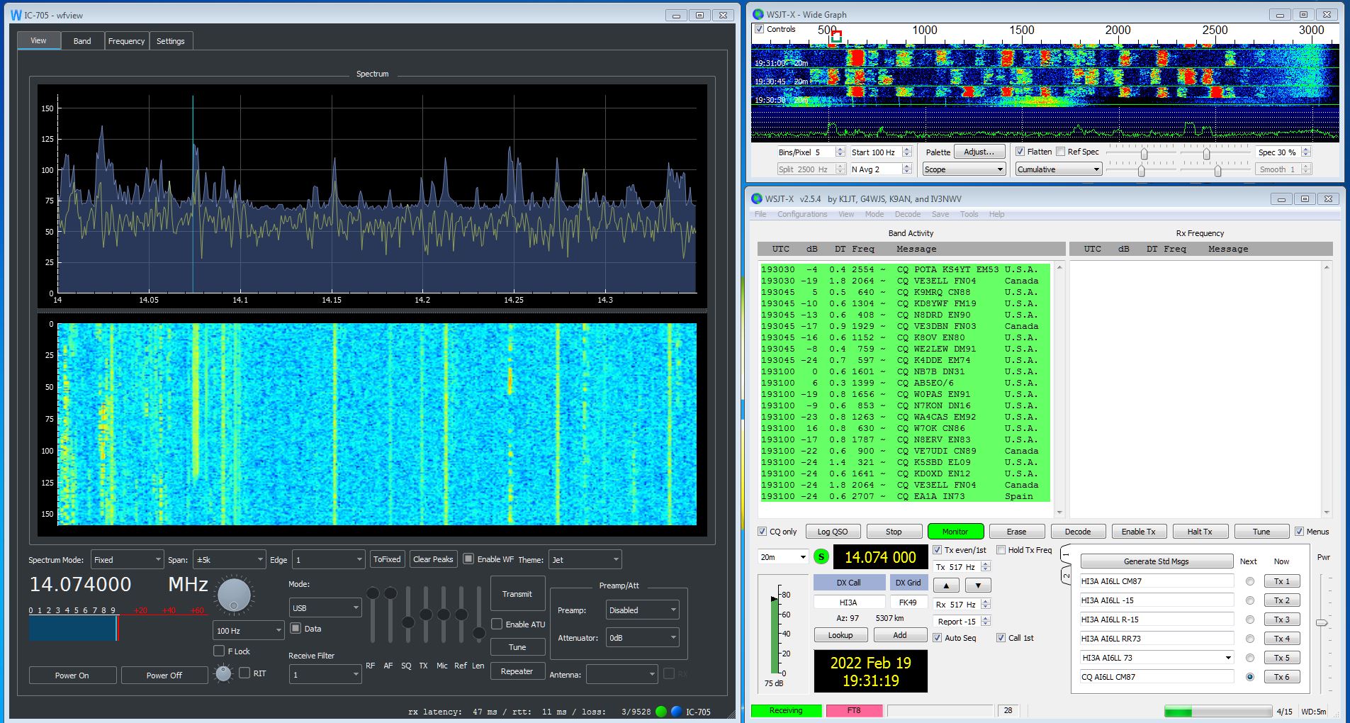

Anyone who owns an Icom IC-705 can connect it to WiFi for remote operation with FT-8. If they are willing to share their password and user name, you can run their station from your computer with freeware. I mention and show it here,

The thing is showing the radios RF waterfall in FT8 operations IS NOT important. What is important is the viewing of the waterfall in the WSJT-x audio waterfall. That is the one you need to be watching. Watching the RF band waterfall on the radio is of little value to your operation.

You can see both waterfalls at the same time when the 705 is under remote control at the link above.
If your radio’s SSB filter is flat, and has good opposite sideband suppression, then both waterfalls should show identical data, within the filter’s passband, just colored and scaled differently.  So you can watch either.
