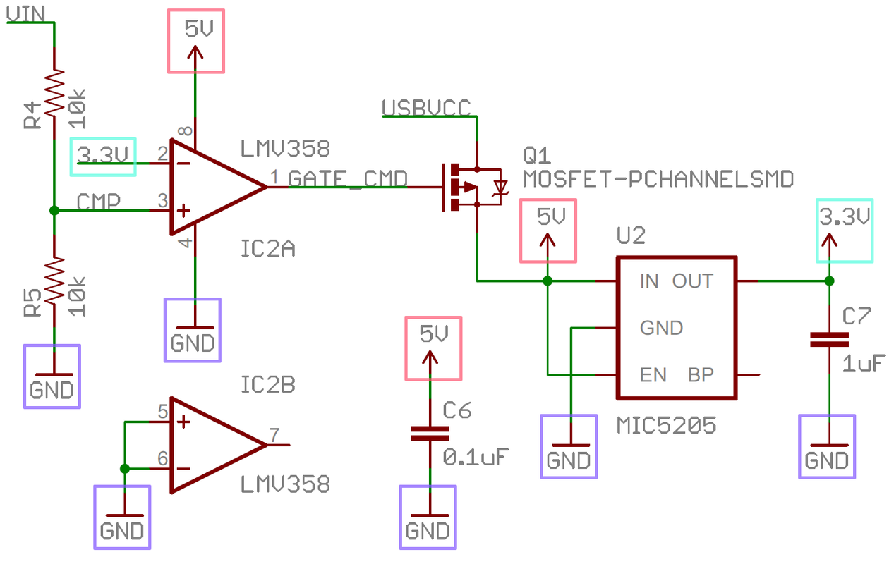

« Reply #11 on: November 16, 2021, 10:06:20 PM »
I would like to show you the schematic but I have asked the webmaster, alas no way to embed an image in the message !
Imbedding images here is quite easy to do. It has been posted hundreds of times. But if you like just send the image to me and I will imbed it for you.
James K0UA
Here is a schematic to show you that it can be easily done.
