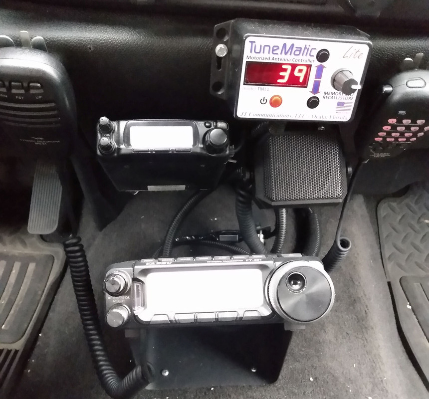

I made my own floor mount for my Ft891 in my silverado. I cut slots in the bracket instead of holes, and ordered some thumb screws with round plastic heads that were the right length to not go too far into the radio and short something out inside. These replace the original factory supplied screws. So with the slots and the thumb screws, you can pull the 891 out in just seconds by lossening the thumbscrews and liftin up and out to disconnect the Coax and the shortened power cord with quick release Anderson Power poles that go into the Anderson powerpole distribution block that also powers the VHF/UHF rig and the screwdriver antenna controller. The mount is secured to the sheet metal pan of the trucks transmission hump right thru the carpet and the screws are treated with No-Ox-Id to prevent corrosion as they are run in.
Of course you can do this any way you want, but this was my solution, and I made the hump mount bracket from some scrounged sheet metal and bent it my self.  Flat black paint rounded out the mount to match a black carpet.
